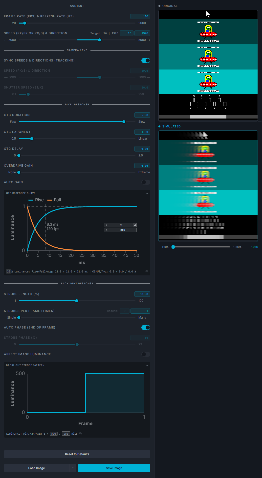

Five years later, the enhanced Blurinator 9000 is no longer just an idea! Say hello to Blurinator 9001. :D This is just a sneak peek for now. I'm still considering whether to publish it.
Display Persistence Simulator.png (187.12 KiB) Viewed 1401 times
