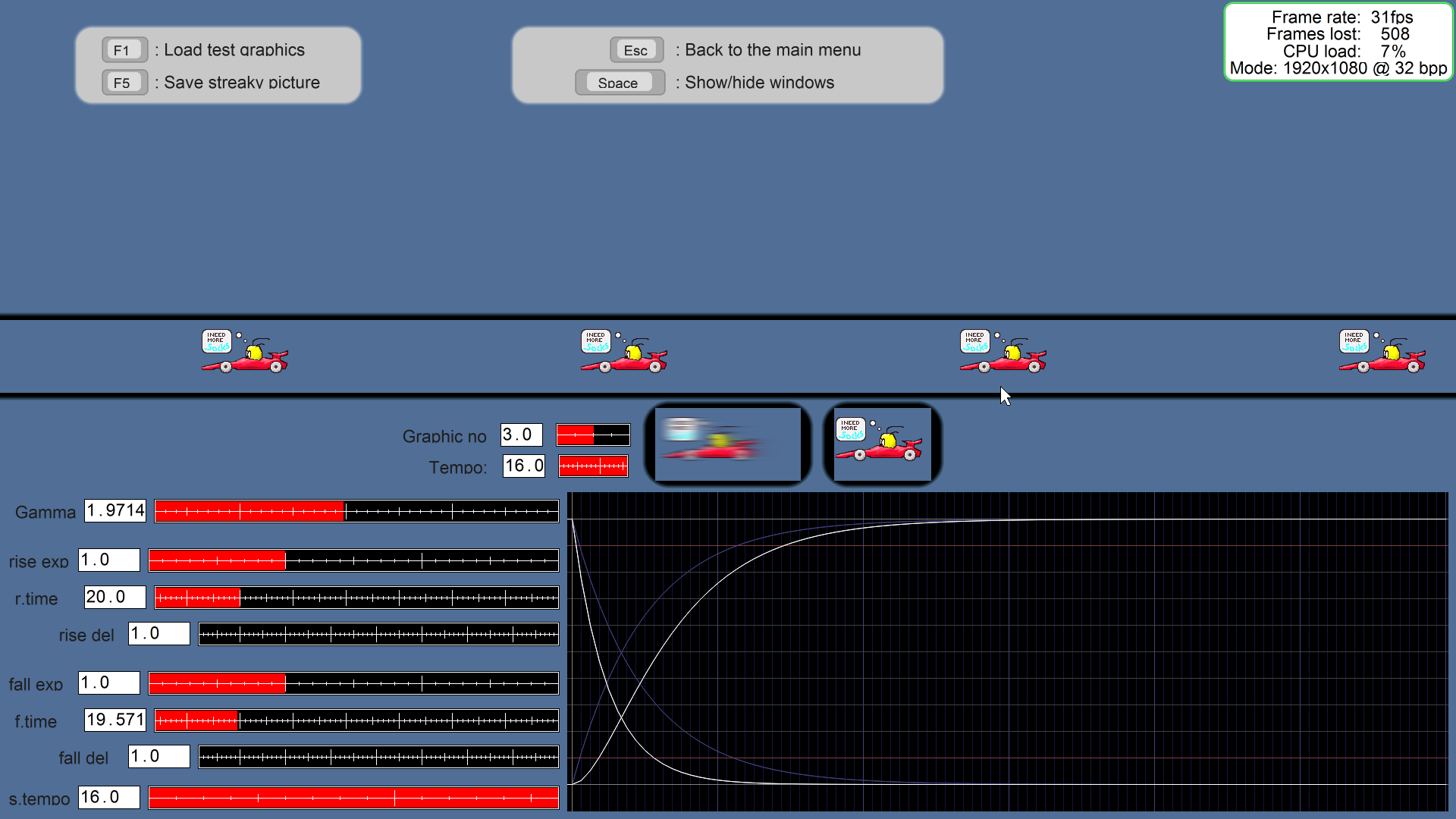

I just published first version of a software for LCD blur simulation which I named Blurinator 9000. My goal was to create an educational tool for demonstrating basic effect in LCD motion blur physics rather than an industrial grade LCD simulator. I hope that you will like the result :) It is available via this link https://github.com/marianvlcek/blurinat ... /tag/v9000 and it looks like this:

There are definitely some limits since I tried to program Blurinator in a quite simple way. The source code has just around 200 lines and the blur simulation is basically done in about 20 lines. The rest is just an auxiliary code and a code necessary for GUI.
All GtG transitions are handled in a same way so faithful simulation of VA panel is not possible. On the other, it greatly simplifies the code since one can generate response curve beforehand and apply it to whole image with one line of code.
Similarly, subpixel blur cannot be replicated and blur can be set only in integer number of pixels. This includes setting of strobe length which always result in an integer blur trail. Strobe phase is another thing that is fixed at the optimum timing, i.e. just before next refresh occurs.
Overdrive at the setting without overshoot halves the response time and there is no way to adjust this factor in a built executable. To model it, I used a sum of two exponential functions which is obviously not identical to a behavior of a real display.
It's definitely possible to create a more accurate simulator capable of simulating different GtG transition speeds depending on the initial and final levels of grey. I wouldn't say that is too difficult, I guess that initial version would take a week of full time development. However, the effort to make a polished product with a nice GUI would be clearly larger. In addition to that, I would expect that the computation demands would be higher so such simulator would not be as responsive unless some optimization effort would be spent. Therefore, I don't intend to go in this direction now.

RGB values have to be converted to linear scale at first. Then one can process image and sum the luminance correctly. Afterwards, gamma curve has to be applied to return to original encoding. Blurinator uses hardcoded gamma value of 2.2.
I think that the difference that you see likely comes that the other software does not operate on the linearized image but directly averages RGB values.
