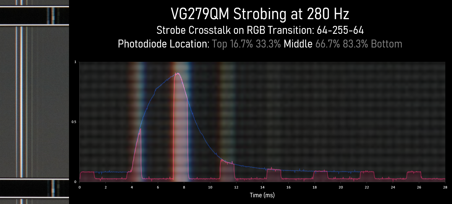

This does not translate well / confuses a bit because it's an interpretation that I don't use -- the blur doesn't stop in a horizontal line in between -- it just gaps. So it's not cumilative
I can confirm the strobed chart is accurate, at least for this case. The reason it looks the way it does is because given transition is sent and held for a longer period to make sure it fully completes, basically treated the same way as classic GtG measuring. But you're right. I can see why it shouldn't be accumulated - with wide enough line like here, the edge blur does stop and hold, but If we gave it a 1 pixel wide line the blur would rise-stop (persistence/backlight ON) with gaps in-between (backlight OFF), matching photodiode data more accurately. So displayed content affected result here. So how do we treat it? Stick with transition edge and subtract the dark area?
VG279QM ELMB 280 Mid, 64-255-64, 1px line.png (710.1 KiB) Viewed 18248 times
source: https://www.aperturegrille.com/reviews/ ... -Crosstalk
Also there needs to be some proof of differing transitions with similar/same CDs matching similar/same perceived blur as we'd want to directly compare one to another (e.g. sample and hold 144Hz OLED matching 240Hz LCD...) or even strobing on vs off situations. Not to mention interpreting over/under/shoot. Obviously two will never look identical but according to CD they should at least feel. This is where we run into a problem.
I measured same CD for these two

Discorz wrote: ↑
06 Oct 2022, 10:13
04 Oct 2022, 22:26
It is accurate if you're not trying to sync quantitative and qualitative (aka what the human eye saw).
But, it just confuses my mind more than it puts at ease, so I prefer a totally different visualization.
Also, complicating matters, we have complex situations of strobe crosstalk concurrently combined with KSF phosphor decay:
Discorz wrote: ↑
06 Oct 2022, 10:13
The GtG transition doesn't pause -- it continues unseen by eyes.
That being said, deep thought is required for a user-friendly visualization that doesn't confuse end-users nor confuse me; because everybody thinks differently. Some people think "geometically" when doing some math formulas (they don't read out the numbers in their mind) while other people think more algebraically. It's a major reason why some people have a tough time with algebra-based professors while having much easier time with geometry-based professors -- there are MANY ways to teach the same kind of mathematics to the same person. It might be a math-equivalent of dyslexia. I don't know.
Regardless, that one earlier graph you posted is totally confusing to my mind -- and that must be solved with a more universal visualization that is less confusing to a wider audience.
But the newer graph, is perfect to my mind:
That one is easy to understand -- the blue line is what the panel is doing independently of the backlight -- and the purple line is what the human eye (and pursuit camera) saw. And correlates perfectly to the intensities of the duplicate images afterwards. It even correlates perfectly to the GtG-plot recorded from a pursuit image of www.testufo.com/blurtrail (single-pixel thick for MPRT/crosstalk analysis) or www.testufo.com/blurtrail#thickness=16 (thickness=ppf for double-GtG curve) www.testufo.com/blurtrail#thickness=-1 (single edge for single-GtG curve) using the technique I described earlier -- In the photo, the first line is strong, the next duplicate line is fainter -- and so on -- and and the final line is faintest. And within each duplicate is a soft blur gradient that matches the shape of the spikes of that graph! And when plotted to a graph, the graph matches that image. That's why pursuit images are in sync with such complex graphs!
Purple line is what photo diode saw. In this case purple line resembles what eyes sees only because transition is 1 pixel wide. If the content was a 2 pixel wide line, the photo diode line and the eye line would already start to mismatch (new 3rd line) which is why I think this one shouldn't be used as well. This is where mentioned eye tracking curve starts to blend in. If we take cumulative error as a metric of final blur where Y-axis is RGB and X-axis is pixels shouldn't eye curve be taken into account? Eye curve can not be captured by photo diode (eye curve is not very good expression but idk what else to call it). To photodiode GtG and MPRT look consistent regardless, but to our eyes does not as moving speeds and content are constantly changing. Finding connection between the two is the key to this concept. In the end we are measuring eye tracking blur.
All this makes me wonder if there should be some agreement on what content to use for measuring, at what moving speed so it could be put in a heatmap to pull out the average just like with classic GtG measuring.
Posts: 12295
Re: Is eye tracked motion blur measurable?
Post by Chief Blur Buster » 15 Oct 2022, 22:33
Discorz wrote: ↑
15 Oct 2022, 17:43
08 Oct 2022, 11:05
The purple line graph is best created in a separate test run involving a solid flashing color, not the moving lines test.
Photodiodes are generally not used with moving-line tests
The best way is to
1 - Run pursuit camera on your monochrome test (moving line or moving edge)
2 - Run photodiode oscilloscope in a separate flash pass (full screen flash)
3 - Superimpose the data.
This just also my beautiful point: How the pursuit camera result is in sync with the photodiode oscilloscope test;
For majority of reviewers, moving lines aren't and shouldn't be used for photodiode tests, but on a solid patch of screen (e.g. this alternating flash test)
This is because a thin line doesn't emit enough light to create high-quality low-noise photodiode data, and it can be 'confused' by indirect emission of light from adjacent pixels (e.g. the line in a different position in next refresh cycle can still backscatter light). So, that's not a best-practice.
Remember:
A photodiode is a defacto 1-pixel eye, a defacto 1-pixel ultra-high-speed camera, capable of 100,000+ "frames" per second, and is best tested on a solid block of color, and never moving imagery. It's not well-suited for moving-line tests, although it could be used for it (with major caveats).
Measuring a solid color change (e.g. full screen grey to full screen dark grey) which is effectively 1-pixel. The great thing is that a solid screen is the same to a multi-megapixel camera or a 1-pixel camera, and that's exactly the kind of test pattern a photodiode is designed to test.
Photodiode tests aren't used for multicolor tests all at once -- you test one color at a time.
Then, with a clever trick (aggregating all the data) -- you can make virtual pursuit camera images just from that by running measurements in the entire colorspace for GtG colorspace (8-bit color space original color, transitioning to 8-bit color space destination color would be 65536-256=65280 measurements).
From that, you can compute behaviors for all possible images of all possible resolutions (and virtualize pursuit camera images), e.g. you're temporally testing each possible color combination one at a time, with a 1-pixel ultrahighspeed camera (aka photodiode). Once you've aggregated the data, there's no limit to the resolution of a virtualized pursuit camera image that looks WYSIWYG.
Thus, the vision vs photodiode symmetry is preserved, at least for static motion artifacts including GtG and MPRT ghosting/coronas/blurs along edges (e.g. constant speed, no temporals aka temporal dithering, etc).
Now, vision curves is a different matter altogether -- it's akin to the color matching problem (e.g. matching print to on-screen), but the error margin of vision curves is far below the error margin of LCD GtG and MPRT curves, as long as the images are within the dynamic range of the eye and also concurrently within the dynamic range of the camera. For the purposes of testing, we omit the vision curves since they vary a lot between humans much like how different humans perceive R,G,B slightly differently. One human may have most sensitive red sensitivity at 612nm, another at 610.5nm, or 615nm, etc. Ditto for green or blue. 12% of population has enough abberation to be considered "color blind" (major color-primary sensitivity shifts). Yet we don't account for human colorspace curves when we just boilerplate-calibrate a display to an aggregate human-population-averaged standard such as sRGB or DCI-P3 or Rec.2020.
So like the color dimension (and the fact we don't worry about human vision color response curve differences between humans, nor print-matching between paper and screen, when a reviewer is doing colorimetry tests to a specific universal standard) -- the temporal measurement dimension doesn't have to worry about human vision photoreceptor curve differences. Besides, the response of the photoreceptors on bright images (like UFO) for the average human is generally far below the finite GtG differences between displays, to the point where pursuit photography still effectively looks WYSWIG, even the subtle sub-artifacts embedded within a pursuit camera image.
This is a large rabbit hole to fall in -- as definitely for dimmer images (moving dark images) the human vision curves can be far slower than the GtG curves. But GtG is so slow that it's still seen (e.g. dark VA ghosting). Once we hit HDR OLEDs with ultra-black blacks, seeing motion blurs in dark objects (whose all pixels are darker than LCD black), vision curves definitely starts becoming a bigger error margin. But, we aren't there yet, and that's a cart before the horse. Other standardizations are needed first for motion blur measurements that combines GtG and MPRT into a single metric.
At the end of the day, photodiodes are easy to understand when you view them simply as a 1-pixel ultrahighspeed camera, designed only to measure a single solid rectangle of color -- it's not used for moving-line tests.
HOWEVER, pursuit photography of a moving-line test DOES map to a photodiode oscilloscope in the axis of the motion vector (as a temporal plotting manoever), and that is how the purple line was drawn.
The correct way to map a single GtG transition between doing a photodiode versus doing a pursuit camera, is a moving-edge, not a 1-pixel-thick line. Right Test for the Right Job, to create bidirectional symmetry between graph drawn only from a photodiode versus a graph drawn only from a pursuit camera.
Moving lines should have a line thickness equal to pixel step per refresh, if you're measuring a 1-refresh-cycle double GtG transition (e.g. black->white->black). Not a 1-pixel thick line. Now if you're adding a 4 frame delay between refresh cycle with a photodiode (e.g. Black->(4 refresh cycles of white)->Black), then you need a line thickness 4x the pixel step, to generate an identical chart (as a photodiode oscilloscope) without using a photodiode oscilloscope.
Basically, you can use a photodiode oscilloscope alone, and you can use a pursuit camera alone, and generate exactly the same curve with both, as long as you configure variables within the overlapping venn diagram of capabilities (e.g. sample rate is much more limited with a pursuit camera). It is all in the correct configuration of test, and how to convert the resulting data into a chart.
It is much easier to sketch/diagram this to explain better. I probably should.

15 Oct 2022, 22:33
Im confused. Is it possible to extract gtg curve from a pursuit camera or not? Cause no matter what I try curves always overlap with MPRT blur. I guess only extractable part is outside overlapping?
Posts: 12295
Post by Chief Blur Buster » 24 Oct 2022, 10:52
Discorz wrote: ↑
24 Oct 2022, 09:40
15 Oct 2022, 22:33
The answer is yes.
However:
(1) Max oscilloscope “sample” rate can’t exceed camera resolution (of the line width)
(2) Camera response needs to be linear;
(3) Blacks should not be clipped (adjust until blacks are dark greys)
(4) Whites should not be clipped (adjust until whites are light greys)
(5) Camera tracking accuracy errors will smear it to closer to MPRT than MPRT+GtG, since MPRT is usually the bigger component, and that will start to flood the small GtG noise as the data is smeared from the camera blur.
Capturing multiple refresh cycles is simply reducing noise, like doing multiple oscilloscope runs and averaging the curves together.
Perhaps things will become more accurate if I add a sync track to the moving line test. I didn’t think of this ability when that test was originally designed to be a visual-only test.
To spread the curve accuracy, you could use the darker color as the black reference and the lighter color as the white reference, but you kind of loose the zero reference, though you could use the photodiode.
