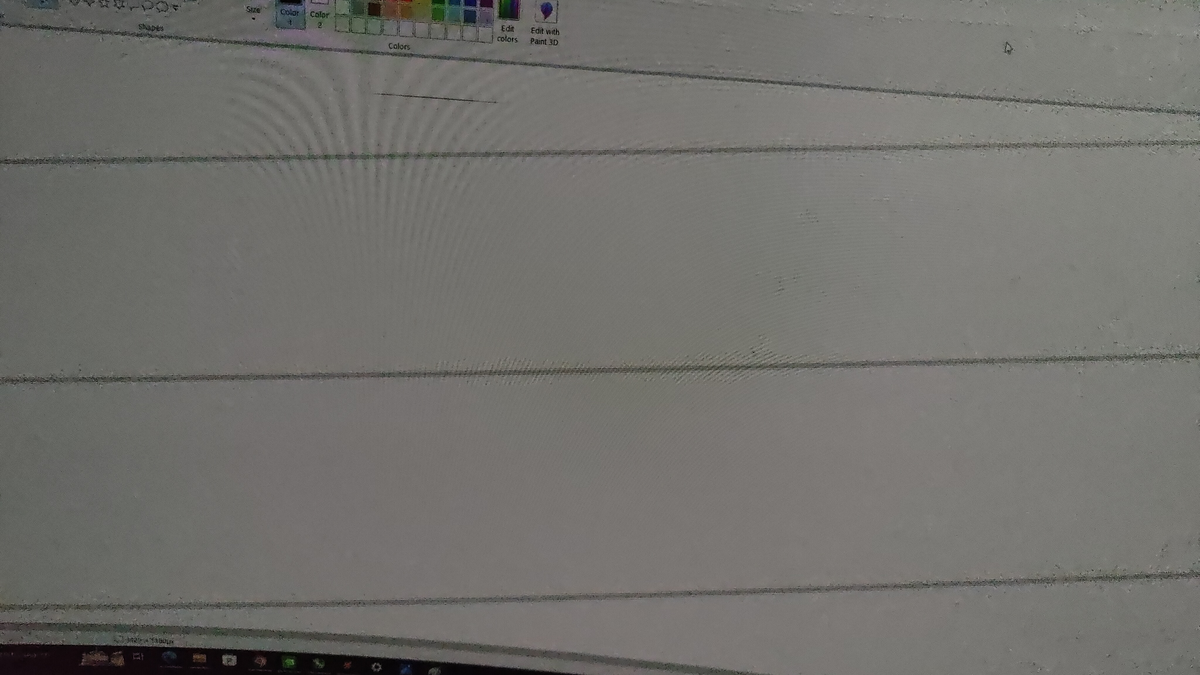

I made some investigation on the flicker side:
If I film with the shutter at 1/8000, I can see horizontal lines.
At 165 Hz, I can see a lot of lines that are almost "flashing" (appearing/disappearing).
At 60Hz, it's a single slow line.
Also, if I record the screen with the "slow mode" at 240 frames, at 1h65 Hz, the screen seems to be flashing.
At 60 hz it does not seem to do that.
I also tried the blurtrail test from testufo dot com.
At 60hz the line is smooth, at 165Hz, I think I can see multiple lines.

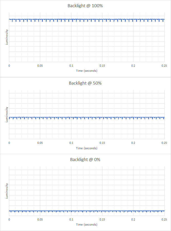

This image is from rtings, with the backlight. It seems that it doesn't have PWM, however there is a small dip in brightness with each refresh. Not sure if the pupil is able to catch that and dilate/constrict, resulting in eye strain.

I compared the graph for the backlight flicker from RTINGS with the one from AW3423DWF and the LG does seem flicker free: the graph is a straight line with just some slight noise, contrary to Alienware's which had like a 5% drop in brightness with each frame.
Perhaps this was the reason why I had the eye strain with the Alienware? Also, I am glad that the IPS is ok after reading many negative reviews about the nano IPS strain. I guess my eyes can tolerate nano IPS quite well.
