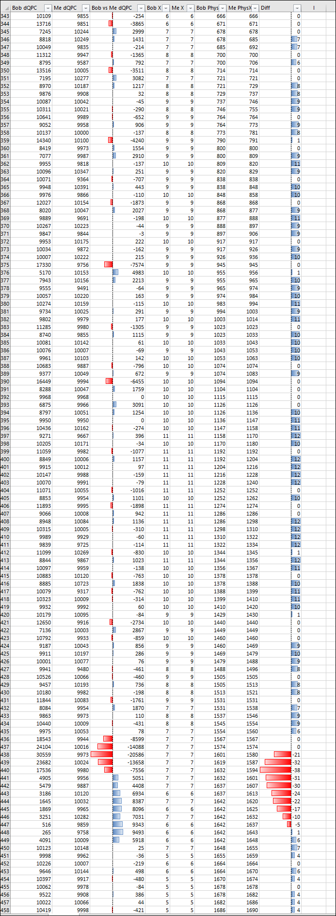

So, I think I have something... but there's enough weird anomalies going on that I'll probably prove myself wrong in a few weeks after investigating each...
So here's what I've got to show to you all so-far:
Good vs Bad comparison.png (169.26 KiB) Viewed 8459 times
I was able to do my traces on a friend's unaffected machine over the weekend and I believe I now have actual proof of anomalous behaviour (but not enough to attribute to imprecise mouse pointers yet) - so while this is something I can definitely take to Microsoft and ask them to investigate, I doubt they'd do anything with it... yet.
  • The "Bob X" and "Me X" columns show the raw USB HID reports relative mouse movement in the X axis (all Y-axis data is hidden in that spreadsheet) - as you can see, the raw inputs are identical. Also, both computers had identical Windows mouse settings (speed, acceleration, acceleration curve, etc).
  • The "Bob dQPC" and "Me dQPC" columns show the time delta (in QueryPerformanceCounter) between each Win32 Raw Input WM_INPUT message (a value of 10,000 means 1ms; I re-played mouse movement with a fixed 1000Hz reporting rate for this scenario)
  • The "Bob vs Me dQPC" column shows any difference in the time-between-reports on Bob's machine vs. My machine. So it's interesting that Bob's machine actually had more jitter than my machine, even though my machine is the one worst affected by this floaty/imprecise mouse issue. (I did record a full USB trace here, but I haven't yet examined the low-level packet timing data yet)
  • My main take-aways here, are that:
  • 1: for some unknown reason, Windows is accelerating my mouse cursor more (per-unit-of-relative-input) which isn't explained by the report timing.
  • 2: When the mouse starts to decelerate (see around row 422, where the Report X drops from 10units to 6units) My computer decelerates my on-screen cursor faster than on his machine (i.e. my mouse pointer spent more time closer to 1590px than his did)
Of course, the weird delay on Bob's machine (around row 437) is anomalous - but it's curious, because you'd think Windows would interpret a long gap between reports as a sign the mouse had suddenly stopped - yet the Bob PhysX column shows Windows kept the pointer's intertia up and maintained its effective on-screen speed - so that's curious.
Also, I'm unsure exactly what to make of the ~+10px difference seen on my computer compared to his: observe how Bob's computer always eventually catches-up with mine within 1 or 2 WM_INPUT events (well, that's exactly how acceleration works) - so I'll need to annotate this to show the actual cursor pos used by the GPU when rendering the frame (which happens every 16ms, whereas these WM_INPUT events are every 1ms).
I'm open to suggestions for how to proceed, ofc.
