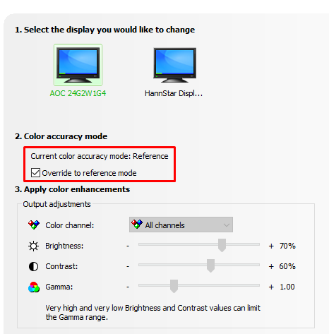

However, today I disabled brightness on my monitor (set it to 0) and I did 1 more thing, which might or might not make an impact, I am not going to change anything and enjoy this while it lasts, hopefully forever.
I enabled reference mode in Nvidia Control Panel, see picture below, I did it for both monitors just to be sure.
Thank you OP!

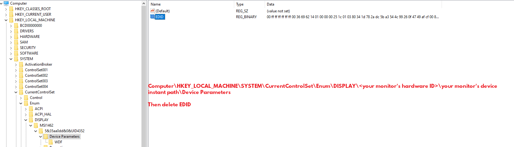

Ok so disabling the monitor in device manager really does work for me but it does so very inconsistently however I messed around a lot and figured out a way to get it to consistently feel good (on my system at least
Step 1- Disable monitor in device manager Step 2- Restart PC
FROM HERE ON OUT THESE STEPS NEED TO BE REPEATED ON EVERY BOOT (FOR MY SYSTEM AT LEAST), steps 1 and 2 don't need to be repeated every boot as long as the driver remains disabled
Your monitor driver should still be disabled after the restart however windows re-initiates the driver's folder in the registry every boot. Even though the driver is disabled/unloaded windows re-initiates the monitor's EDID on boot which is what's causing the fix not remaining consistent for me.
This entire DISPLAY folder gets re-initiated on every boot even if you click uninstall in device manager instead of disable (uninstall in device manager deletes this entire display folder but it reappears on pc boot)

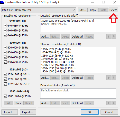

Step 3- Delete the EDID entry in the image above. It can get pretty annoying to navigate to this every boot so what you can do instead (this is what i prefer to do) is using Custom Resolution Utility to delete the monitor profile.
After deleting that profile, it should delete the EDID entry in regedit. If you try to reopen CRU after deleting the profile it should display an error which reads "No displays found in the registry"
