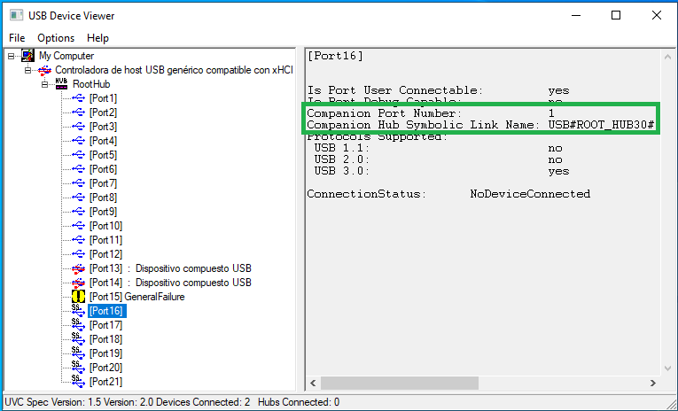

https://www.techrepublic.com/article/tr ... ce-viewer/
I don't know if this has something to do with it but worth a try to test.
With usb device viewer from Microsoft, check what you have for the slower and faster port in Companion Port Number/Hub Symbolic Link.
If the fast port has no companion port number and no symbolic link and the slow port has, then this could mean something.
Try other ports following this.

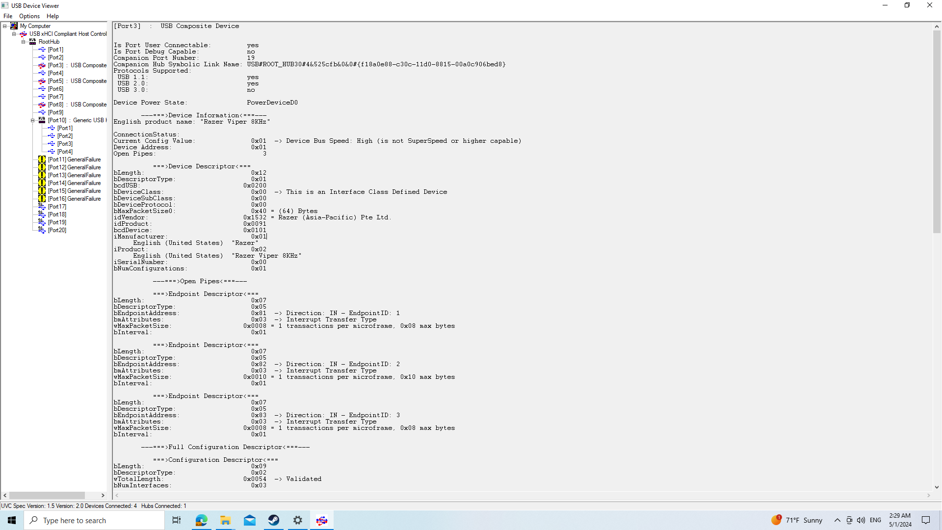

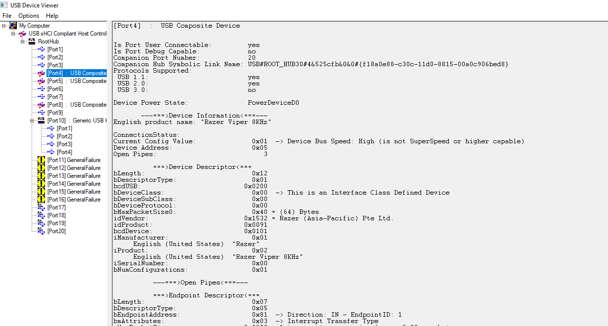

Thank you man for your suggestion. So here are the two pictures of both ports, they're the same I think.
Slower mouse movement port
slower port.png (39.67 KiB) Viewed 3713 times
Faster mouse movement port
faster port.png (121.18 KiB) Viewed 3713 times

So port 4 feels slow, but port 3 feels fast? What’s the other usb devices, I assume one is keyboard, are these plugged into 3.0 ports, or do you have a mix of 3.2/2.0?
