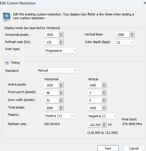

I use Blur Reduction + VT 1500 at 120hz [DisplayPort] (img below)

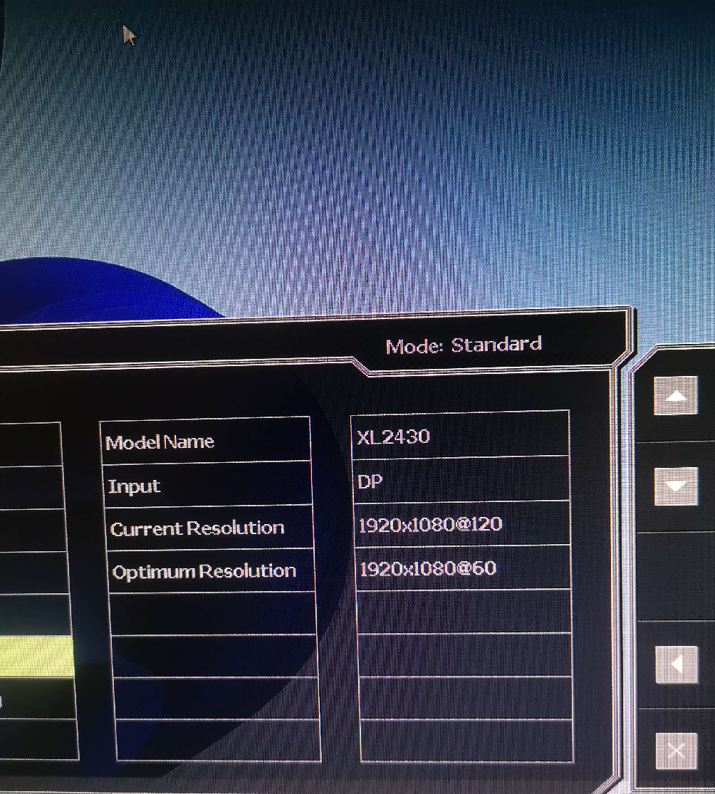

How do I verify if the VT tweak is working? I read that the monitor OSD would report the current resolution @60hz, but mine shows 120hz (indicating that it's not working properly?)
Is there a step that I'm missing? Settings are:

1. Viewing the same mode in both ToastyX CRU and NVIDIA CRU is a good way to confirm. Sometimes one utility adds a mode that doesn't properly save (and not visible in both utilities). So view via at least two Custom Resolution Utilities.
2. Your crosstalk at www.testufo.com/crosstalk should go down dramatically, with much less top/bottom crosstalk, once you've used Blur Busters Strobe Utility to center the clearest crosstalk-free zone. You can try faster motion speeds (e.g. 1440 or 1920 pixels/sec) to amplify the visibility of strobe crosstalk.
