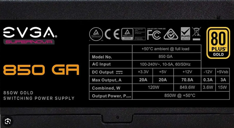

Why do we talk about EMI? He replaced his PSU and it has solved his issues, how do we know if it's even worth start talking about some EMI? I quit with EMI stuff already long time ago because there is nearly zero chance, that my PC would work exactly in the same shitty way in places located hundreds of kilometers from each other. What if it's just about high current load?
Every PSU has the sticker with current limits on each rail.
How do you know if particular PSU manufactured years ago is capable of handling modern GPUs, CPUs and MBs in terms of high currents under heavy load (WITH NO PERFORMANCE DROPS)?

Simple. The example PSU you provided is great.
Let's take my main computer as an example. The CPU, by default, is limited to 125W power draw via the BIOS, but it can go over that for a specific amount of time. That's called TAU, and in my case the CPU is allowed to draw 250W for a duration of 54 seconds by default. So, let's use 250W of power draw for the worst-case scenario.
The GPU is even simpler. It's TDP is set to 300W, because it's an aftermarket card with an improved cooler. The Founders' 2080 Tis have a TDP of 250W. GPUs usually don't come with a TAU or dynamic power limit. The power limit is set via the VBIOS and can be viewed and/or modified with any overclocking software of your desire. I'll assume a power draw of 300W for this GPU.
Now, the PSU example you provided immediately tells me that it has one 12v rail, and it can provide 70.8A on that rail. 70.8A at 12V equates to 849.6W, as shown on the sticker. Adding the power limits from the two components of my computer together, we get a worst-case power draw of 550W on the 12v rail. The PC's fans do also run on 12v, so let's factor in another 50W if you really go all-out and plaster your PC with fans (EDIT: RAM of course also pulls its current from the 12v rail, but typically uses <10W at most). All the other components, like SSDs or USB which are on 5v, are on different rails, so they're not factored into the 12v rail. This means that - when looking at the worst case scenario - my computer would draw 600W from the 12v rail - something that this unit is very well capable of and is not even close to the limit. This unit, on paper, should have zero issues with powering my system, but I can assure you that this unit would also cause my PC to show the usual problems.
cursed-gamer wrote:
22 Jun 2024, 13:10
Because a load is a load. Modern GPUs and older ones aren't different from the view of a PSU, they draw the "same" current (not in an "amount of current" sense, but the same "kind" of current, because there is only one "kind" of current). Current is current, the PSU can't differentiate if it's hooked up to a 2080 Ti or a 980 Ti or a GTX TITAN or a 750 Ti or a GT 710. You know that these "old" PSUs are capable of handling this hardware, because they were capable of handling the highest-end hardware in the past (assuming we're talking about quality 700W+ units here).
If i overclock the hell out of a 4790k, maybe even apply liquid metal and custom watercool it, I can easily push 250W through that thing. Pair it with a watercooled, heavily overclocked 780 Ti (base TDP: 250W) and there you have your "modern" system in 2014, in terms of power draw. And I just happen to know somebody who has used that exact combo with a 750W unit and never had a problem with it. So yes, these PSUs are capable of handling these loads. Sure, these older ones might not be as efficient, meaning that they'll draw more power from the wall than they're actually providing for the PC, but apart from that, there is no difference.

Alright, I don't know what kind of "leakage current" we're talking here, so I'll cover the two things that came to my mind first.
The first, what I do understand of the term "leakage current", is when a device is drawing current from the mains but returns the current not over the intended neutral conductor, but rather over the earth/ground wire, for example when there is a ground fault. This isn't going to happen in my case, because german law requires something called a "FI Schutzschalter", a residual current device (or a ground-fault interruptor), to be installed and functional. These things measure the current going out on the live wire, and weigh that against the returning current from the neutral. If there's a discrepancy, the device will trip, cutting the power. My setup, the entire house in fact, is protected by this device, so there's no potential for this kind of leakage current.
The second meaning, although that's not what you'd call leakage current, might be the inefficiency of the PSU. Let's say my example computer needs 600W to operate under maximum load, and the PSU is happily supplying that power, but there is a higher power draw from the wall. This is because PSUs aren't and can't be 100% efficient, and every PSU has an efficiency curve. You can easily measure the power draw from the wall though, and in my practical case, it never exceeds 500W.
Let's take another look at the latter thought. Let's assume that my computer is under the worst-case scenario the whole time. Let's be generous and assume that to be 650W of continuous power draw. This power draw would be about 76% of the PSU's maximum certified wattage of 850W. Here's the efficiency chart for the example PSU you provided:
It's a bit hard to read, but the efficiency at 76% load is roughly about 92%. I'm basing this off the white 240v curve. This means that the PSU will draw 52W more power from the wall than what the components actually need. This would place the overall power draw from the wall at 702W, still comfortably in range of the certified 850W.
All of this is of course ignoring that the rating on the label usually is showing how much DC power the computer can draw, not how much AC it can safely pull from the wall. Which means, if the PSU would be running at 850W, and according to the chart it's 90% efficient at that wattage, it could safely pull 935W from the wall and still be within its rating.
