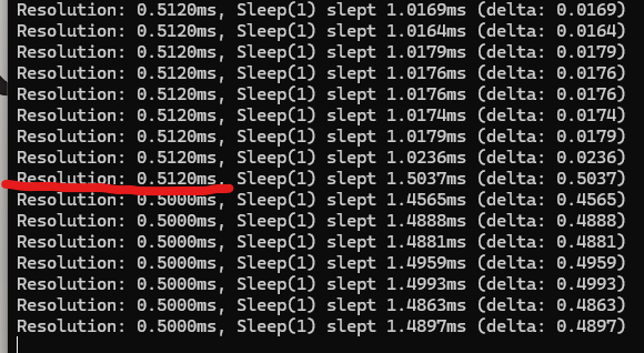

how to fix the issue where the value changes to 0.500 and increases the delta to 1.5ms when games are running? dpclat increases from 0.30 to 999
2024-09-24 161649.png (61.29 KiB) Viewed 15423 times
JimCarry
Posts: 586
Joined: 24 May 2024, 20:01
Location: csgo
Re: Timer Resolution from 15ms to 1ms [Turn 60Hz-feel into 240Hz-feel on 240Hz]
Post by JimCarry » 24 Sep 2024, 21:39
since no one is answering i delete all bcdedit commands and delete islc and dpclat.exe.i dont know if it works, or if its placebo or not, but since no one proving or saying anything, i delete them both and return to default bcdedit.
MatrixQW
Posts: 311
Joined: 07 Jan 2019, 10:01
Post by MatrixQW » 25 Sep 2024, 00:14
JimCarry wrote: ↑
24 Sep 2024, 21:39
I pretty much answered here:
MatrixQW wrote: ↑
23 Sep 2024, 23:37
Also, seems RTC can't have Sleep lower than 1,5 with timer at 0,5xxx (0,51 as a safe value). This is what @JimCarry is experiencing.
Anyway, I always felt the timer at 0,5 seems to create a weird delay and games/apps already set the timer to 1ms which is what they need and is enough, so it's kind of pointless to set it any lower.
If TSC is default like I think it is, then 'disabledynamictick yes' should actually help.
Also, the problem with having dpclat.exe running is that it eats cpu cycles, has a ton of dpc calls.
You did the right thing, there is no need to set the timer manually and lower than 1ms.
Only thing that might help the system a little bit is 'bcdedit /set disabledynamictick yes' and even this is not really necessary.
On W11 you can use the regedit GlobalTimerResolutionRequests but Microsoft changed this behaviour for a reason and is that each app should have their own timer value.
