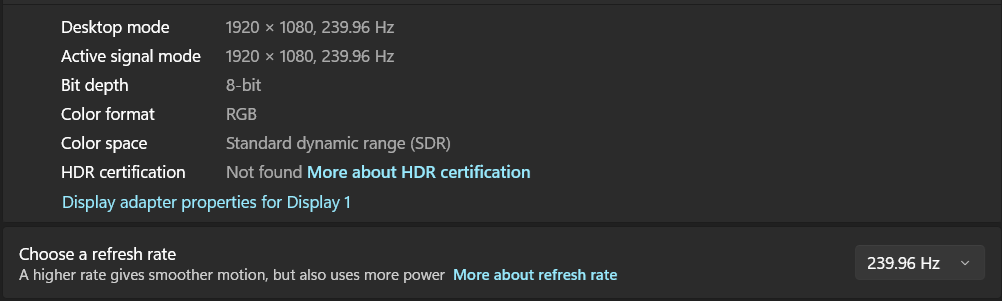

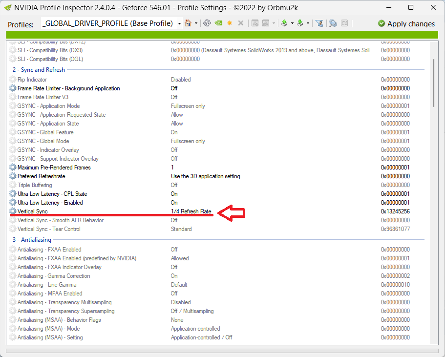

1/4 is for 240Hz (240/4 = 60.) On 120Hz, you'd use 1/2 (120/2 = 60.)
Yup, couldnt tell the difference at 240hz with 1/4 refresh rate using NV inspector vs. 240hz with ''use the 3d application'' for vsync using ''borderless windowed mode''
I believe there's mods to fix that.
Do you have a link to that by any chance?

BH_231 wrote:
29 Sep 2024, 19:28
I believe this is something that needs to be set in the game's profile, not the global profile.
There's this (it works in Sekiro which I'm using, but apparently also Elden Ring but I don't have that):
https://github.com/W4RH4WK/Sekiro-Refresh-Rate-Fix
There's also this:
https://github.com/uberhalit/EldenRingFpsUnlockAndMore
This is the Elden Ring version of "SekiroFpsUnlockAndMore". With Sekiro, I have to use both. The former to prevent the forced 60Hz, and the latter to unlock FPS.
