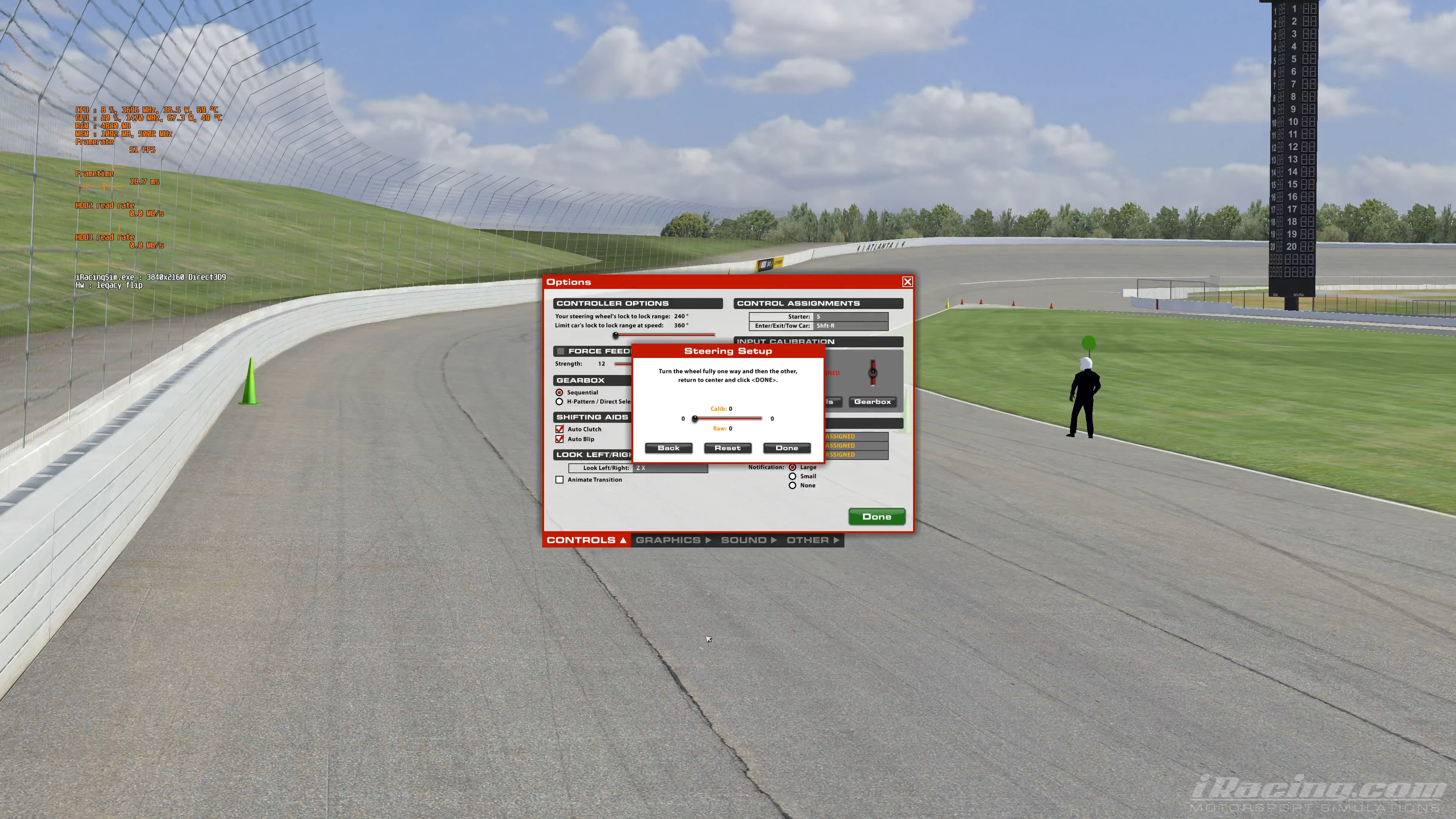

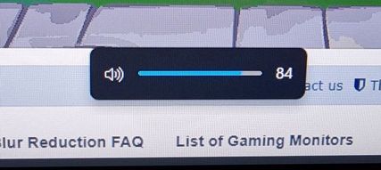

Hello.
I'm struggling with old title called iRacing to get it smooth like it was for me in the past. Sometimes game is supersmooth, sometimes not, for no reason, for sure situation may change despite I dont change anything in my system. Just like launch-to-launch it differs in terms of smoothness.
But during all troubleshooting and contacting people with similar problem, after reading all those stories about presentation model, MPO enabled\disabled, how it may change driver-to-driver or windows-to-windows update, without much information I discovered one very simple thing: it seems like full screen exclusive (FSE) doesnt really exists.
One person mentioned, that when game is in FSE, when you press on keyboard "vol+\-" it should not even show volume bar, it shouldnt show anything except the game.
He stated, that anything that would like to show up on monitor, and doesnt come from a game, should "kick-out" game from FSE, so it turns into window, or gets minimized, and this process takes up several seconds. So I did try and I was surprised, that volume or even pressing windows key was appearing on top of iRacing game, like it was already windowed borderless. But its not (its selected full screen), but when I for example lauch explorer, then it will not go on top of game like menu start or mentioned volume bar, then it will kick-out iRacing to window, before explorer appears. So it seems like kind og "intermediate" mode.
I remember this kind of behavior to be kind of standard for many years that game which was full screen, nothing would appear on top of it.
So I installed Win10 1903 that was stated on forums to be the last one to have "FSE", after strange tries and messing up I got state, where game seemed to be FSE, and volume bar would not go on top. That, in the end would help me to get rid of stutters, as this old title likes FSE most.
Question that comes, is this "FSE mode" possible to get in Windows11, nowadays with 24H2 version ?
Also please correct me if I'm anywhere wrong with all that story about menu start and volume bar.

The volume bar should indeed not be visible when in classic FSE. I don't have W11, but in W10 all you need to do to get FSE back is to disable FSO (full screen optimizations) in the properties of the game's exe file.
With that being said, MPOs are not used when the game is borderless fullscreen. Also, normally you could use Special K to make the game use the proper flip model to make sure it works properly in borderless, but with this being an online game with an anti-cheat, that's not really possible.

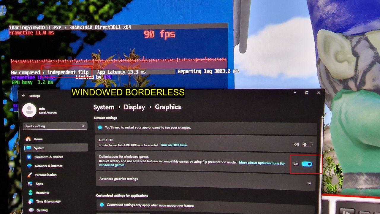

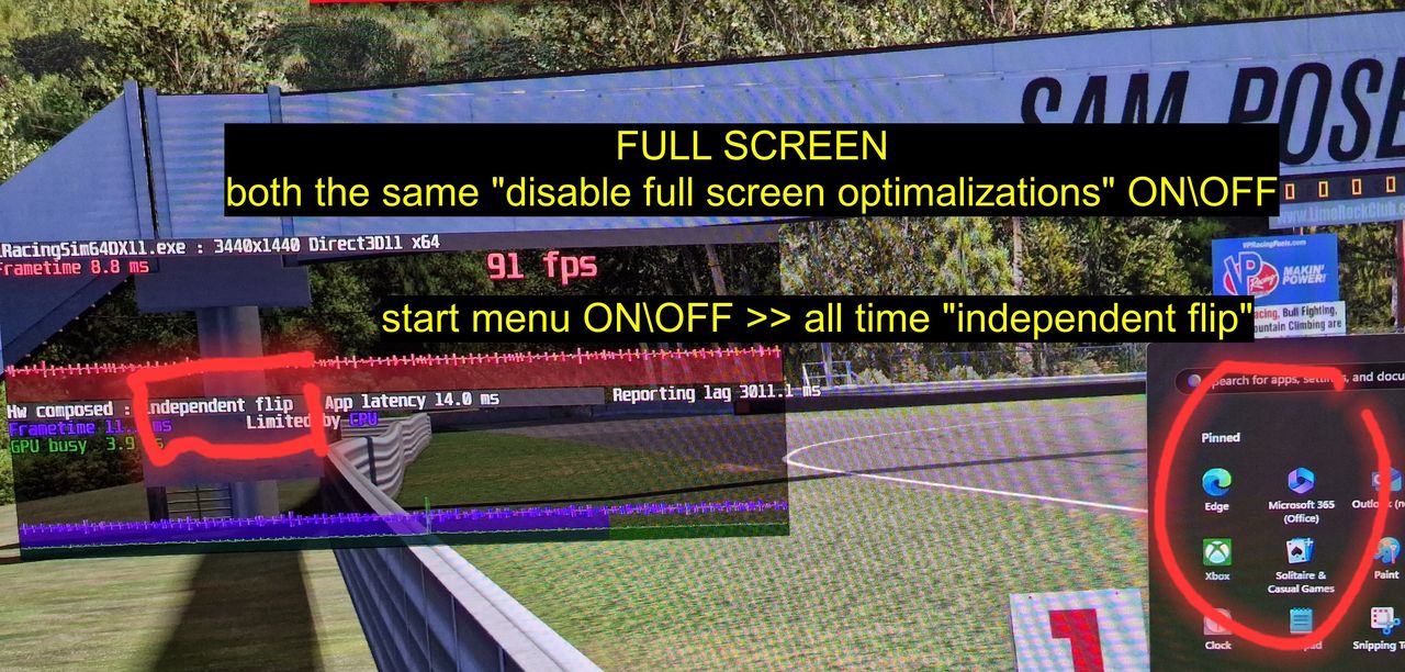

Thanks for valueable info ! Now I just run single screen, hardware g-sync (Dell AW3423DW)
I finally saw presentation model via RTSS. Thank you. Possibly now I know more what is going on, but nothing is goin on... At least this answers my questions why all settings I manipulate with, give no or little result. It seems presentation model remains the same all the time. Is this normal ?
"full screen" selected in iRacing >> independent flip
No change if "disable full screen optimisations" is selected or deselected. No change if start menu on top or not. windowed borderless & optimization for windowed games = OFF >> independent flip windowed borderless & optimization for windowed games = ON>> independent flip Anyway, in full screen game is much better in terms of smoothness than windowed, but still stuttery. So I assume presentation model is not reason why sometimes it can or cannot be smooth. Thing is sometimes it will launch almost butter smooth.
So I don't really know what to do, to just try some other presentation model. You mentioned to override it by means of RTSS, how do do it ?

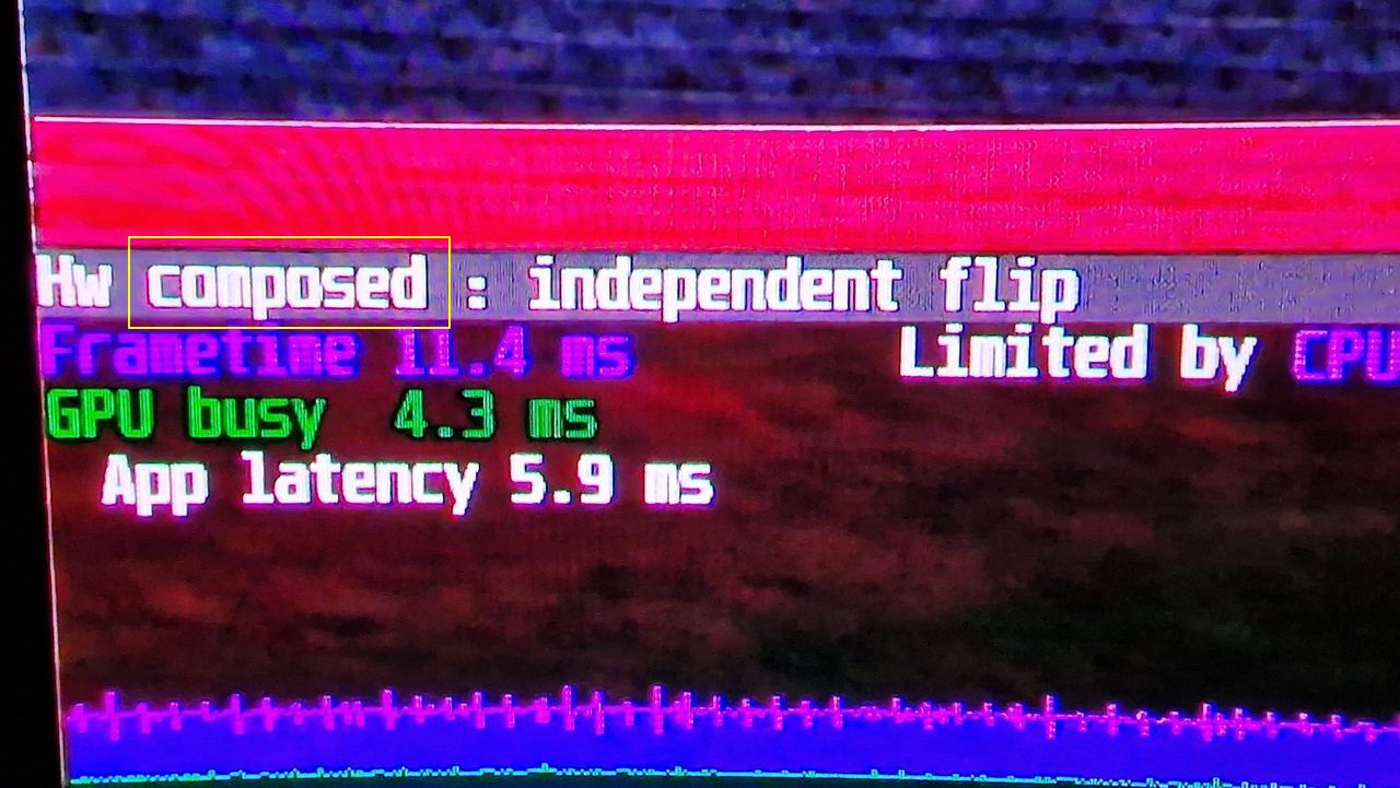

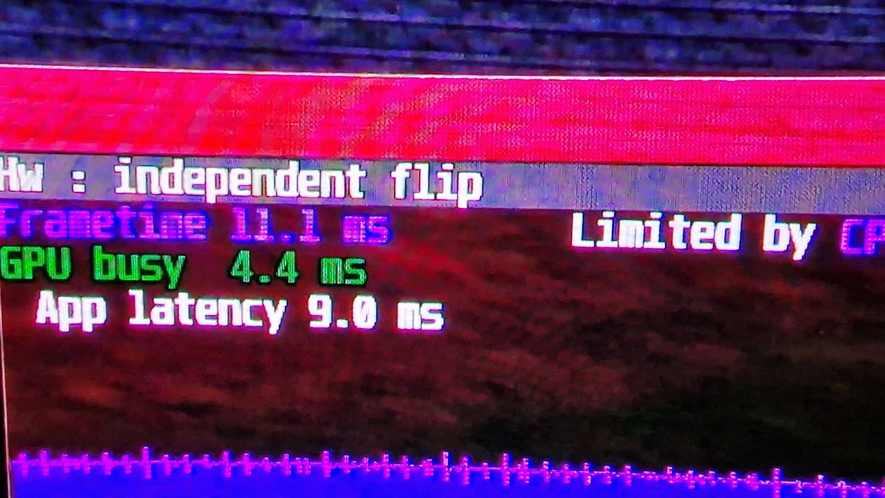

Hello.

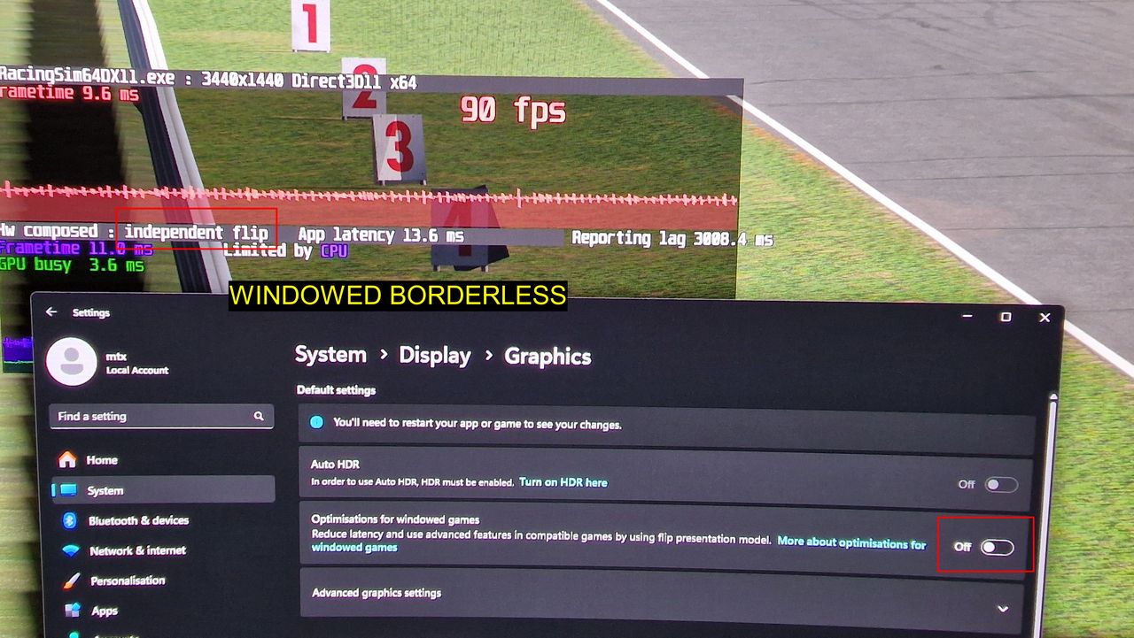

In Win11 24H2, windowed vs full screen, despite all scenarios were showing "hw composed: independent flip" Full screen was much more smooth than windowed. Windowed was just unplayable, for sune no placebo. Even recorded with 240FPS camera and was analyzing in slow-motion.

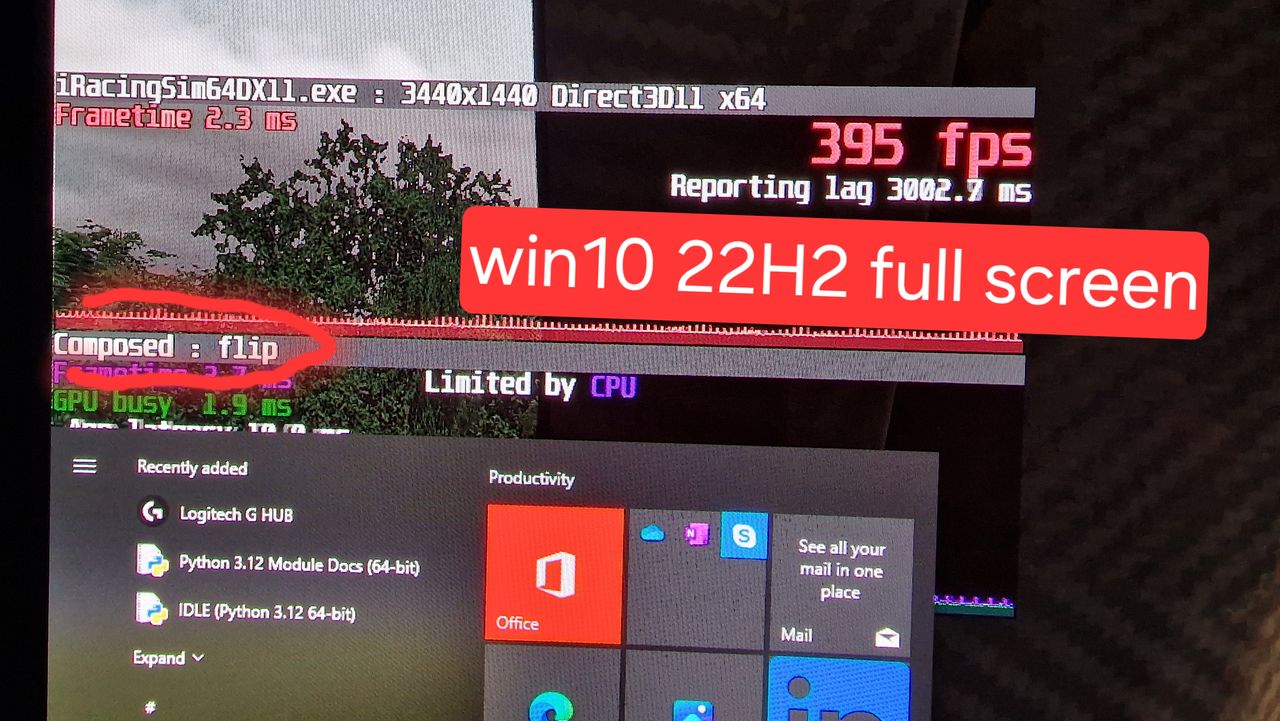

I swiched to Win10 22H2 to see how it goest there, as its generally more smooth for me (I did tons of experiments before I started thread here), and here are findings:
I discovered something interesting that in windowed mode presentation model changes by itself: every several seconds I can see model name changes in that RTSS overlay, but change is so fast you cannot read whats there. I recorded video and then analyzed frame by frame and it was like below. In this situation there is stuttering. Also I found, that sometimes in windowed mode game will start as "composed: flip" and this is stutterfest, also what is very misleading in this scenario windowed gsync seems to be activated, monitor Hz fluctuates, g-sync indicator is on but game play is stuttermess.
In full screen I see constant "hw composed: independent flip", however when I turn on menu start, model changes
so its different behavior vs Win11 24H2. However, when "hw composed: independent flip" is there permanent in full screen, I can get it very smooth with g-sync & frame cap via RTSS or ingame cap.
You said "independent flip presentation" = as good or better than FSE. Is this :
or
hw: independent flip" or any of these ?
What is the difference ?
I'm still manipulating a lot, so this is just in-between update. My target is to make is working smooth in tripple screen configuration.
Besides presentation model, do you think can there be some explanations why in Win11 I cannot get it smooth in any scenario, while in Win10 yes ? I was trying to replicate all settings from Win10 to Win11 and Win11 stutters.
