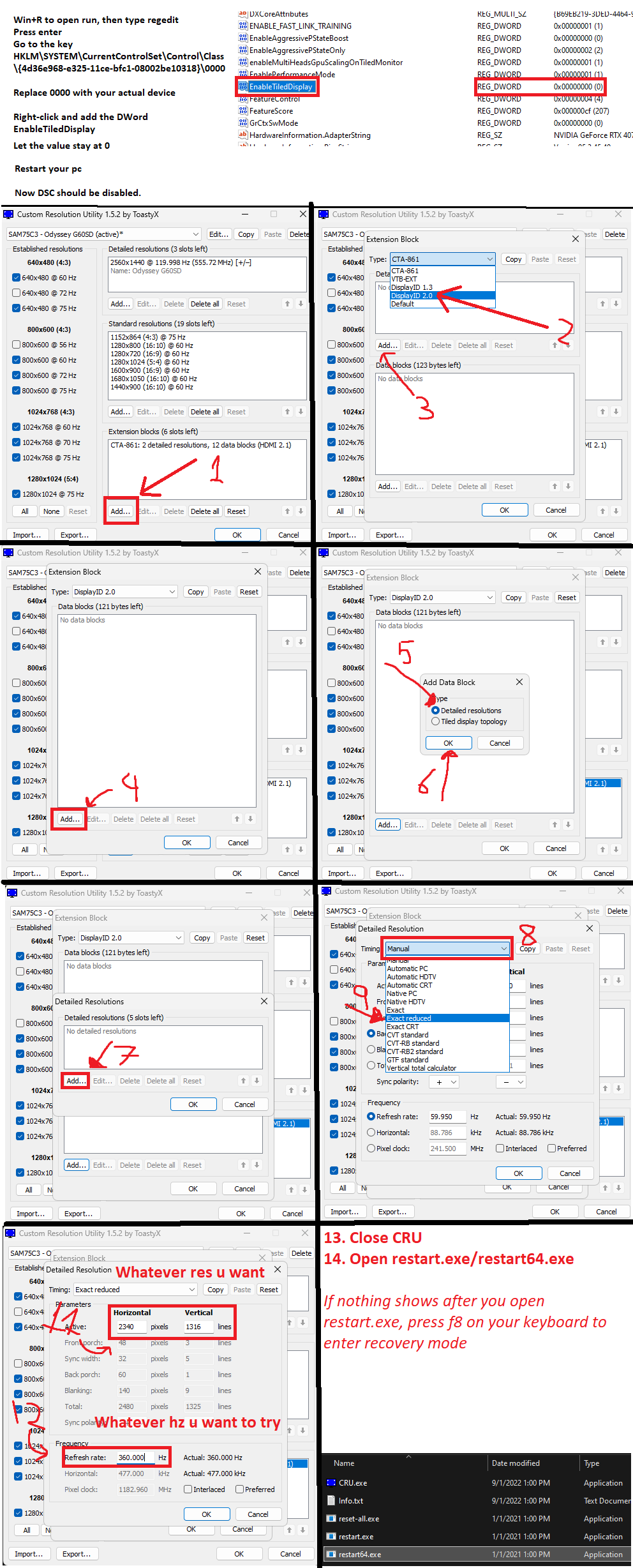

I just got the XL2586X+ today. So what I found out is both the HDMI 2.1 and DP 1.4 cable use DSC at 1080p @600hz.Whosmysterious wrote: ↑12 Feb 2025, 10:12I contacted zowie support and they claimed in chat (and email from another team member) that 600hz runs over hmdi 2.1, but one of them seems to think it still uses dsc.
However, I got my monitor earlier today and connected it via hdmi and then enabled 600hz... I no longer have a few second pause when alt tabbing. Could it be that this monitor actually runs 600hz without dsc? Idk. I'm confused lol.
However, by using CRU, I am able to get 600hz on the HDMI 2.1 cable without DSC. I also changed the EDID settings on the monitor to "500hz"
Here's the steps I followed below. At Step 12 you can put in 600hz.
With this change, I no longer have that 5 second black screen delay when alt-tabbing and the DSR Factors options are now available to me in the Nvidia Control Panel.

That's so weird. I don't have the black screen delay when alt tabbing like I did on my asus 540hz. I'm running 600hz over hdmi 2.1 on my 4090 and there's no black screen. If I decide to use your configuration, is there any risk it can damage my monitor? Thanks for the post.witega wrote: ↑14 Feb 2025, 23:26I just got the XL2586X+ today. So what I found out is both the HDMI 2.1 and DP 1.4 cable use DSC at 1080p @600hz.Whosmysterious wrote: ↑12 Feb 2025, 10:12I contacted zowie support and they claimed in chat (and email from another team member) that 600hz runs over hmdi 2.1, but one of them seems to think it still uses dsc.

Are you playing DX11 games or older with Fullscreen Exclusive enabled? That's where you will see it. DX12 games don't matter.Whosmysterious wrote: ↑15 Feb 2025, 02:34That's so weird. I don't have the black screen delay when alt tabbing like I did on my asus 540hz. I'm running 600hz over hdmi 2.1 on my 4090 and there's no black screen.
Not sure about damage but if the settings don't work it won't display an image period.If I decide to use your configuration, is there any risk it can damage my monitor? Thanks for the post.
