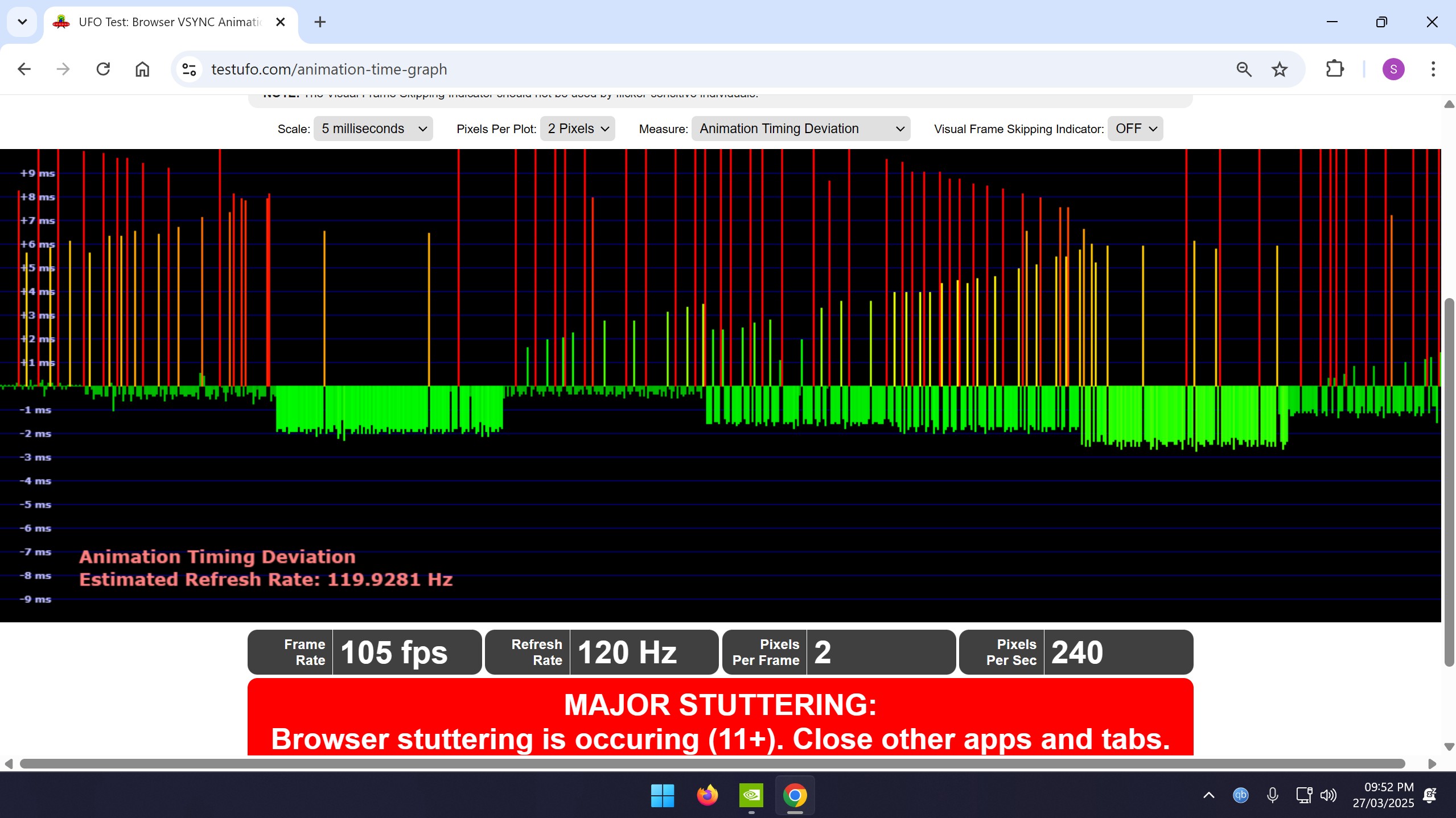

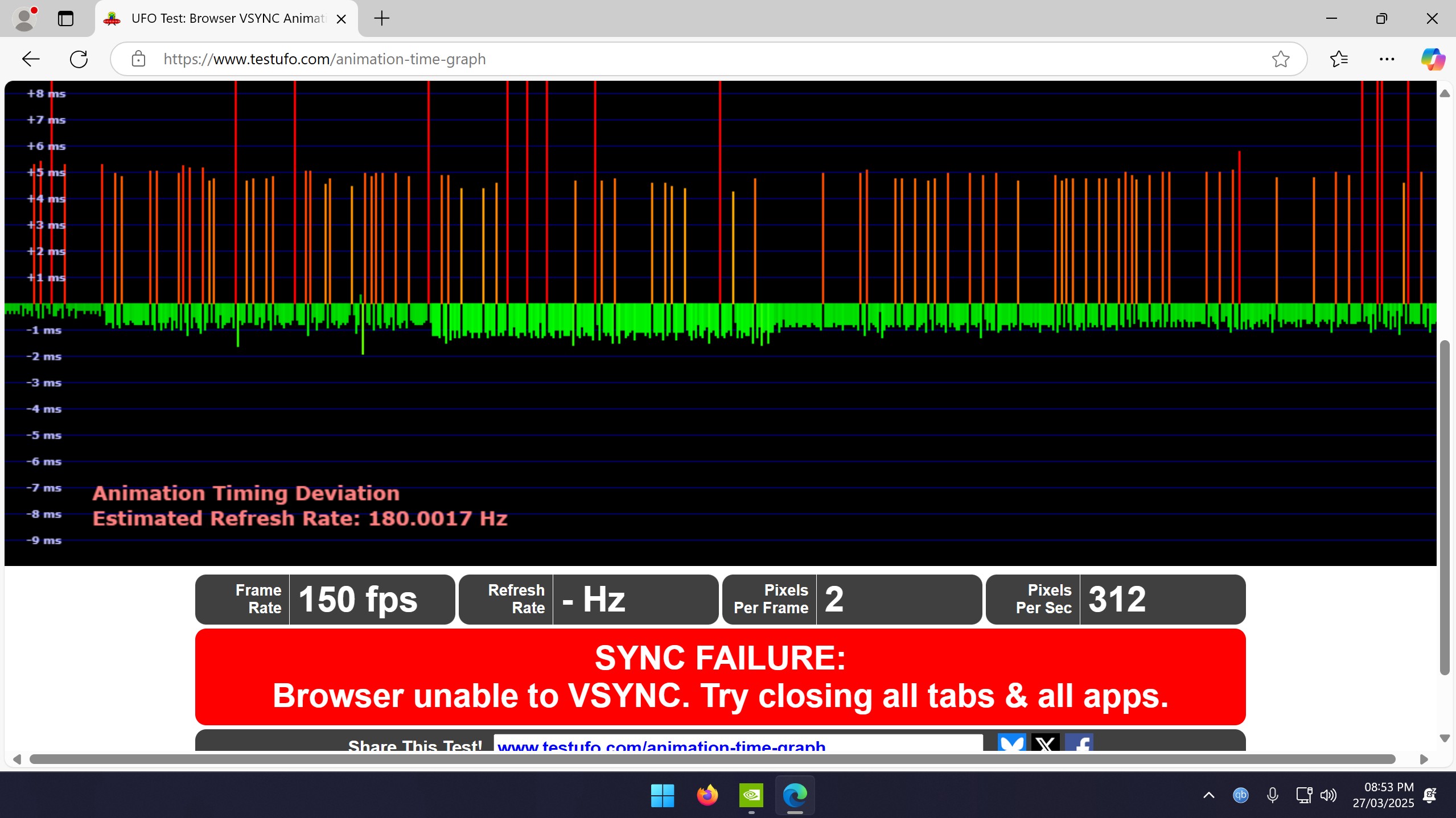

They seem to be the same sadly. Im wondering if it is a driver issue as im still having issues with stutter on the animation time graph, or maybe its my eyes lol
Screenshot 2025-03-27 215222.jpg (532.65 KiB) Viewed 2976 times
Screenshot 2025-03-27 205343.jpg (493.97 KiB) Viewed 2976 times
These spikes are not normal. Have you tried different browsers? Edge, Firefox, Chome?
If it's not the browser causing it, some common causes of these spikes include hardware monitoring software running (like hwinfo, MSI Afterburner, RTSS sensors plugin, etc,) RGB lighting drivers and RGB control software, and anti-virus/malware software.
