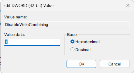

Sandy wrote: ↑
01 Jul 2024, 09:05
What number should be filled in here? 0x00000001 or 0000001 or 0x1 or 1? Thank you
If you double click on that one, it should open this window (see attached). Put a 1 there to disable Write Combining. Put a 0 to enable it again, should you run into issues.
5800X3D | 4080S | 64GB RAM | AW3423DWF
