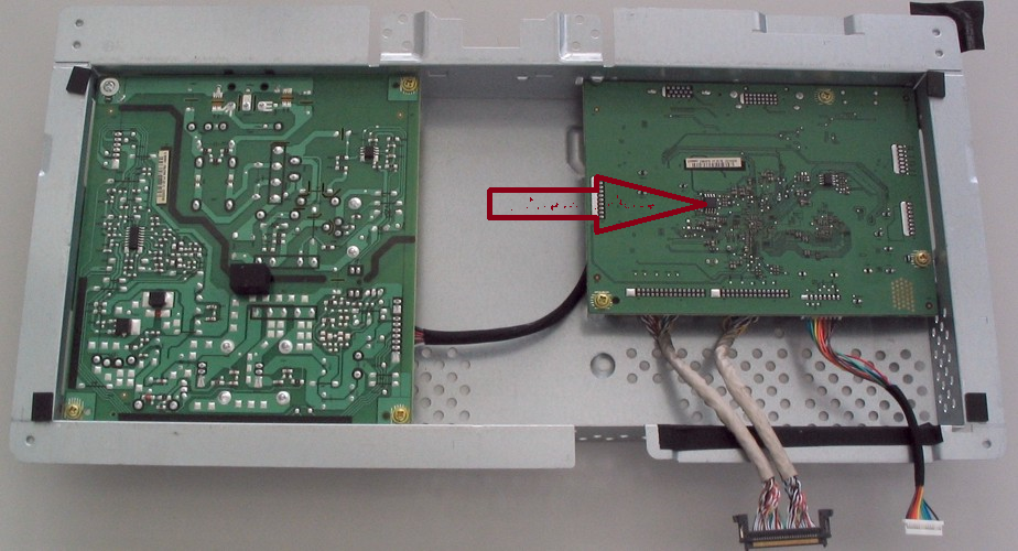

I have recently been trying to overclock my xl2411p as a fun project and to just get higher hz on my monitor but as most xl2411p owners know its not simple lol. I pulled the v10 firmware for the xl2411p with an ch341a programmer I found on amazon for 15$.
If anyone has bricked their xl2411p here is the v10 firmware - https://mega.nz/file/jZJh0AKb#3qo60aEkl ... Ab4t4ShTic you can use this to reprogram the benq xl2411p with a programmer.
also if anyone has the knowledge to reverse engineer this firmware to remove the out of range pop up or just allow the oor buster program to work on it, If you could send it my way that would be sick. I do not believe the firmware uses any encryption because I have already changed some values on it, saved it to a different file then flashed it and my monitor is working with that.
Ben firmware chip.png (728.55 KiB) Viewed 27049 times
this is the chip with the firmware, I believe this is the same for the xl2411t
ALSO!
when programming not reading. YOU MUST desolder the chip then program it
when reading the chip all you have to do to read is plug in the monitor or get a programmer that supplies enough current to power the rest of the board because the cheap one i bought cant do that without help from the monitors psu
BE CAREFUL because the monitors psu is exposed and touching it while it has power could result in you being electrocuted
