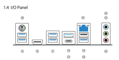

I actually found an issue now. Everything started about 2 months ago when I bought a Logitech Superlight 2 mouse. After that, my internet began dropping from time to time. I also started getting packet loss here and there, and I thought it was related to the NDIS driver/ISP.
When I was re-plugging my devices, I accidentally changed the port to another and thought that Realtek Driver fixed an issue. However, now, after doing some research, I'm sure that it’s caused by EMI since I’m playing on 4k polling rate (I used to play on 1k). When I plug my mouse next to the ethernet adapter, the mouse is pretty smooth, however, I get packet loss and ethernet adapter disconnects. And when I switch the USB port, the internet works perfectly with no packet loss, but the mouse feels off.
As soon as I plugged my 4k polling rate mouse into the USB port next to the ethernet adapter, my internet speed dropped from 1000mbit/s to 100mbit/s as Speed & Duplex is set to Auto Negotiation. That's crazy.
UPD 4
Here i'll explain my issue even better. The only USB 2.0 port on my MOBO is next to the Ethernet Adapter. The mouse on USB 2.0 is very responsive and smooth, however, when I use it (even with dongle), I get packet loss and internet speed drops from 1000mbit/s to 100mbit/s, so I have to restart my PC to get the speed back, however, it will drop to 100mbit/s later again. If I use USB 3.0 mouse becomes slow and unpredictable. Any ideas how to make USB 2.0 usable without buying External Ethernet PCIe card?
UPD 4
