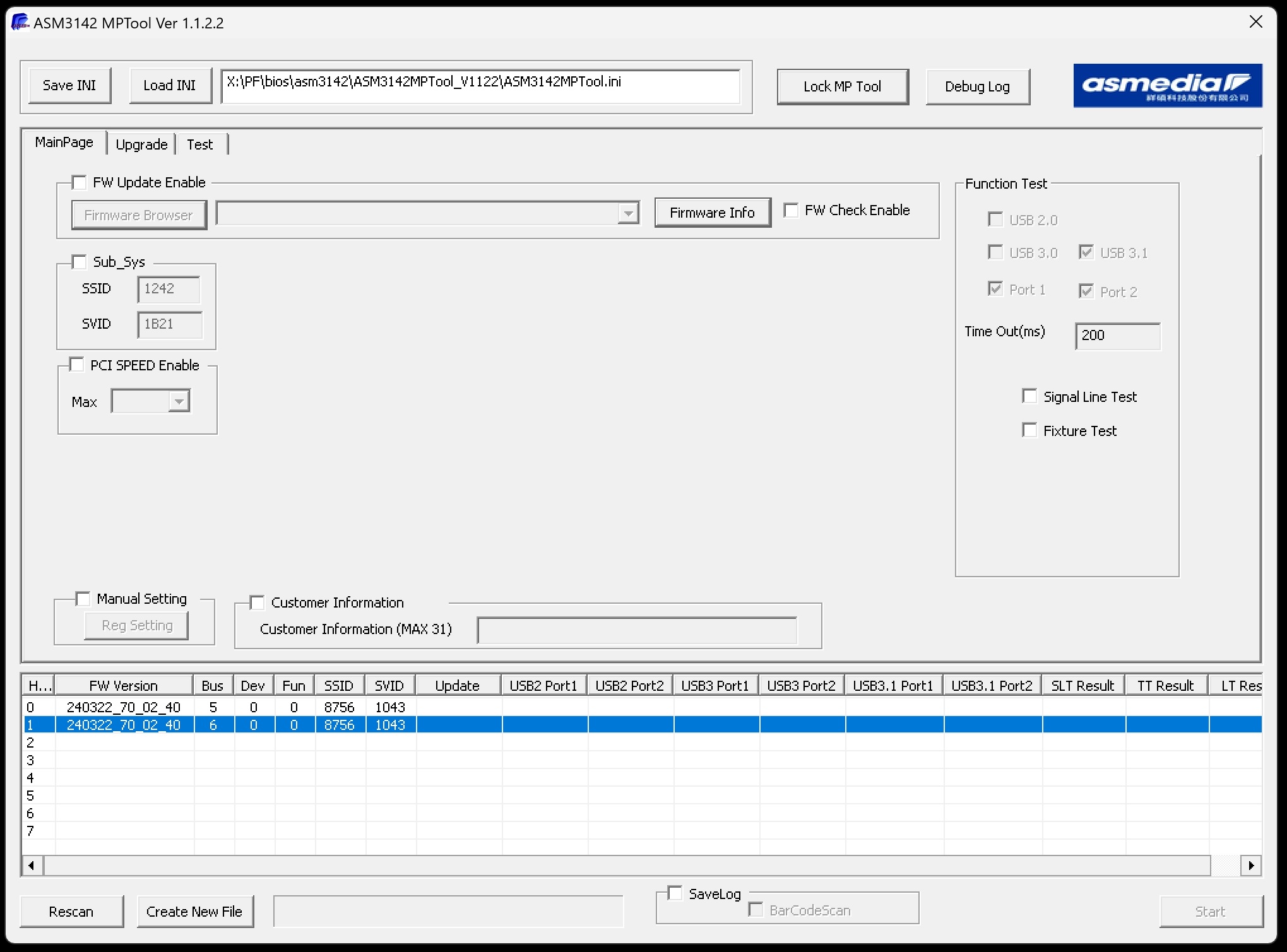

By the way, USB controllers can have their firmware updated.

Post by kyube » 01 Nov 2025, 07:30
1000WATT wrote: ↑
31 Oct 2025, 18:16
Yes, but not all PCIe AIC's have the ability to be updated using that particular application software.
They can brick the card :D
