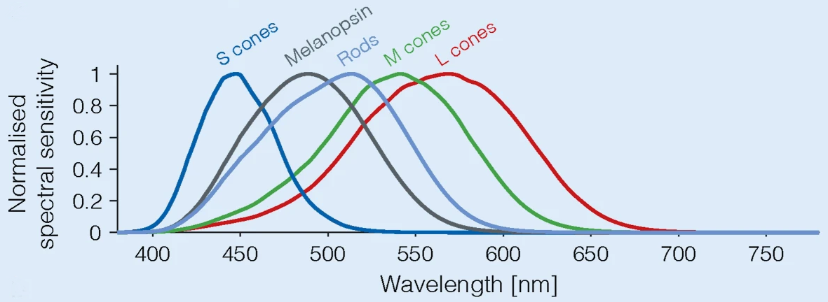

Re: Severe Sensitivity to Light Emitted from LED-Backlit Displays
It's not simply one average. A more detailed understanding about how the spectrum is sensed and processed may be relevant for your case. You can check the Wikipedia article section Color_vision#Physiology_of_color_perception, or at least the cone cell response spectra chart there: Basically, each cone type (Short, a.k.a. "blue", Medium, a.k.a. "green" and Long, a.k.a. "red") actually responds to a large portion of the visible spectrum that overlaps with the others (e.g. green light is detected to some degree by all photoreceptors, not just the M-cones). So, each cone type will produce its own different signal value which is like a weighed average (more like integral math, actually) of the spectrum of the light received. And then to determine the color at a given point, nerves process signals coming from the nearest S, M and L cones: it is the ratios of the signal values coming from the different cone types that matters. But there are different ways to achieve a given combination of signals.MagnuM wrote: ↑01 Aug 2025, 18:24I only have problems on LED-backlit computer monitors. Perhaps it is because there is such a sharp spike in the blue range which isn't balanced out by all the other colors? I heard that our eyes/brain will essentially take the average of a color spectrum when looking at the color white (which might explain why whites look so "blue" from LED light like harsh car headlights).
So display and lighting engineers, as usual, want to have more relaxed requirements when they can, and so they assume they don't need to produce a broad, flat spectrum to produce a white color (like what incandescent bulbs do, which approximate black body radiators). Apparently they assume that as long as the ratio of the S:M:L signals produced is mostly right for most individuals, the spectrum is good enough. One weakness in making this assumption is due to the fact that the response spectra of human cones (see the chart above again) are actually not exactly the same for every individual. There are separate genes that code the S, M and L response spectra, respectively. For each of these genes there are at least a couple of different variants that produce a curve that is slightly offset to the left or right of the other variants. Black body radiation of any temperature is going to be perceived pretty much the same regardless of these genes. However, once you start playing with spiky light spectra you can end up with ones that trigger very different combinations of S:M:L signals between individuals with different cone pigment genes. That's why colors on a monitor can look correct or nice to one individual and incorrect or ugly to another. But I suspect that it also means that, for some individuals some monitors can look unnatural enough to become an irritant, especially when their light comprises most of the light that is coming in. There could be many other things about the physiology that we don't fully understand, and which could be complicating the reaction to unnatural spectra.
So, I'd be researching the light spectra of monitors, as per your leading theory. I'd be comparing both the overall shape and the wavelength of the peak(s) and trying to find something much different from the known bad ones. I don't know which monitor and panel/backlight manufacturers even provide such data, other than cases mentioned earlier in the thread. I guess some products targeted at professionals are more likely to be engineered for a flatter spectrum, and to advertise such a feature, because that must be a way to achieve good color accuracy as perceived by more of the population. Or I'd be looking directly for professional experience or scientific theories linking light spectra to neurological symptoms. I hope you figure out something.

What's interesting about the chart you shared is how there seems to be a triple-low-point around the cyan part of the spectrum around 480 - 490 nm. I notice how most spectrometer graphs of monitors are always very low in this area after the big blue spike finishes. I wonder if there's something to that? I remember reading on a Reddit post once that the color cyan seems to trigger the most amount of migraines in the susceptible (if my memory serves me correctly).
I've always found colors on most LED monitors to be not good-looking at all (especially reds). The icy cold color temperature never helped much when it came to this perception. Maybe it's just the fact that my old Dell U2410 is a wide gamut display that a lot of graphics artists used, and came out late in the CCFL technology cycle.
It would really help to have a color spectrometer to measure the displays I'm using so that I can know exactly what I'm dealing with. I heard they are prohibitively expensive though for non-professionals.
I only provided some information and ideas I thought were relevant and missing.
Of course, in this whole case it is for you to do what you need to do when you need to do it, so you don't need to apologize for anything.
If this idea about the difference between the stimulation of the cone cells and the other two types of cells has any merit, then I think it should be possible to compensate for the dip in the spectrum of a LED monitor by adding some more light of that wavelength in your environment. My guess is that it shouldn't matter where on the retina it hits - it should be about the balance between the total quantity of light around 480nm hitting the retina vs. the total quantity at other wavelengths. The idea here would be to try to bring the overall light spectrum closer to natural daylight.
On the other hand, it may turn out that an even deeper and wider dip around 480nm may be what would be better for you instead. There's this sentence at the end of the article: "Intrinsically photosensitive RGCs have also been implicated in the exacerbation of headache by light during migraine attacks." along with a link to some research paper about it. This does seem to confirm what you remember about a link between cyan and migraines. This hypothesis that you might need less cyan is not supported by the fact that you have a normal response to daylight, but during the night it may well turn out to be even more important than the color temperature per se (though reducing the color temperature will still reduce ipRGC response even if your monitor had a deep and wide dip around 480nm, because the ipRGC spectral sensitivity inevitably overlaps with the spectrum that is needed for reproducing green, at least).
Or maybe your vitamin D levels go low after summer (extremely common in most populations, apparently) and maybe that could play some unexpected role. These are the possible seasonal links I can think of.
Display engineers must be viewing light in that spectrum in between as just a sort of waste, as it doesn't help get higher saturation of the primary colors, while being less energy efficient (I guess adding less perceived brightness than other wavelengths). Interestingly though, that's exactly where the sensitivity peaks of other types of photoreceptor cells are (but those cells do not seem to directly play an important role for color vision). If you're curious, look up "Intrinsically photosensitive retinal ganglion cell" on Wikipedia. Their job is to influence the sleep-wake cycle, the pupillary light reflex, and who knows what else. I wonder if the unusual situation of all the color receptors (especially the "blue"/S cones) being stimulated strongly while the ipRGCs being stimulated much less (due to the dip in the spectrum) may have some subtle, or in some cases not so subtle effect on the human body. Like, the pupils may not be constricting sufficiently in response to mostly LED monitor light, because they are not getting the signal for that, leading to too much light from the LED hitting the retina. I honestly wouldn't put it past display manufacturers to intentionally try to trick human vision into seeing their displays brighter, just for marketing purposes, and ignoring health consequences.MagnuM wrote: ↑03 Nov 2025, 22:01What's interesting about the chart you shared is how there seems to be a triple-low-point around the cyan part of the spectrum around 480 - 490 nm. I notice how most spectrometer graphs of monitors are always very low in this area after the big blue spike finishes. I wonder if there's something to that? I remember reading on a Reddit post once that the color cyan seems to trigger the most amount of migraines in the susceptible (if my memory serves me correctly).
To me it doesn't sound far fetched at all that there could be links between posture or backbone issues and headaches or other neurological symptoms, as I've heard of similar things too.MagnuM wrote: ↑03 Nov 2025, 22:01Ever since a teenager, I don't think I was ever able to sit up straight like all of our mothers told us to! It was much too tempting to just round out the back into the computer chair's backrest like a lazy slouch! Being tall at 6' 4", some bad forward head posture developed due to these bad habits. I wonder if that's why I've had chronic tension headaches and a bit of wooziness for nearly 20 years? I know some posters on [...] were linking some of their eye strain symptoms to bad neck posture, but I don't know if there is a correlation or not.
This (as well as my earlier idea that the 480nm dip may have a negative side) makes me think you should consider room lighting again. Maybe augmenting your daylight to be more like a summer day outdoors could be beneficial? I noticed that Chief Blur Buster has given some good and thorough advice on the subject of getting natural-like light, which I suppose you've read, but if it was long ago maybe you want to revisit it here and in his follow-up comments: viewtopic.php?p=40981#p40981 I think it may be a good idea to have some high CRI (so, plenty of 480nm) dimmable light source around and test to see if there's a good brightness balance to find between a screen and the light, or if it's really better to minimize 480nm everywhere and all the time (again, hard to believe that 480nm that is also in daylight is bad per se).MagnuM wrote: ↑03 Nov 2025, 22:01Weirdly enough, I've been pretty good over the past month on the eye symptom front, but that can be due to luck. I've gone long periods of time over the summer without updating my eye strain log in year's past, as the increased daylight and time spent outside I think really makes a difference.
Just to mention that some of the newer TN panels I've read about use quantum dots, which has supposedly improved their colors a lot compared to older TN panels.
