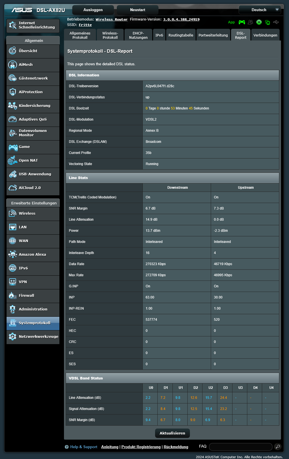

VDSL + Telekom = Horror (Peering)
DOCSIS + Vodafone = Horror (Dual-Stack)
DOCSIS + O2 = Double Horror (DS-Lite)
VDSL + O2 = Sometimes maybe good, sometimes maybe shit
StarLink = Very Good (but only ~180° line of sight)
My neighbor is moving a few houses down (same street) and has fiber to the home (FTTH) right to his office.
5000 Mbps download and 2500 Mbps upload

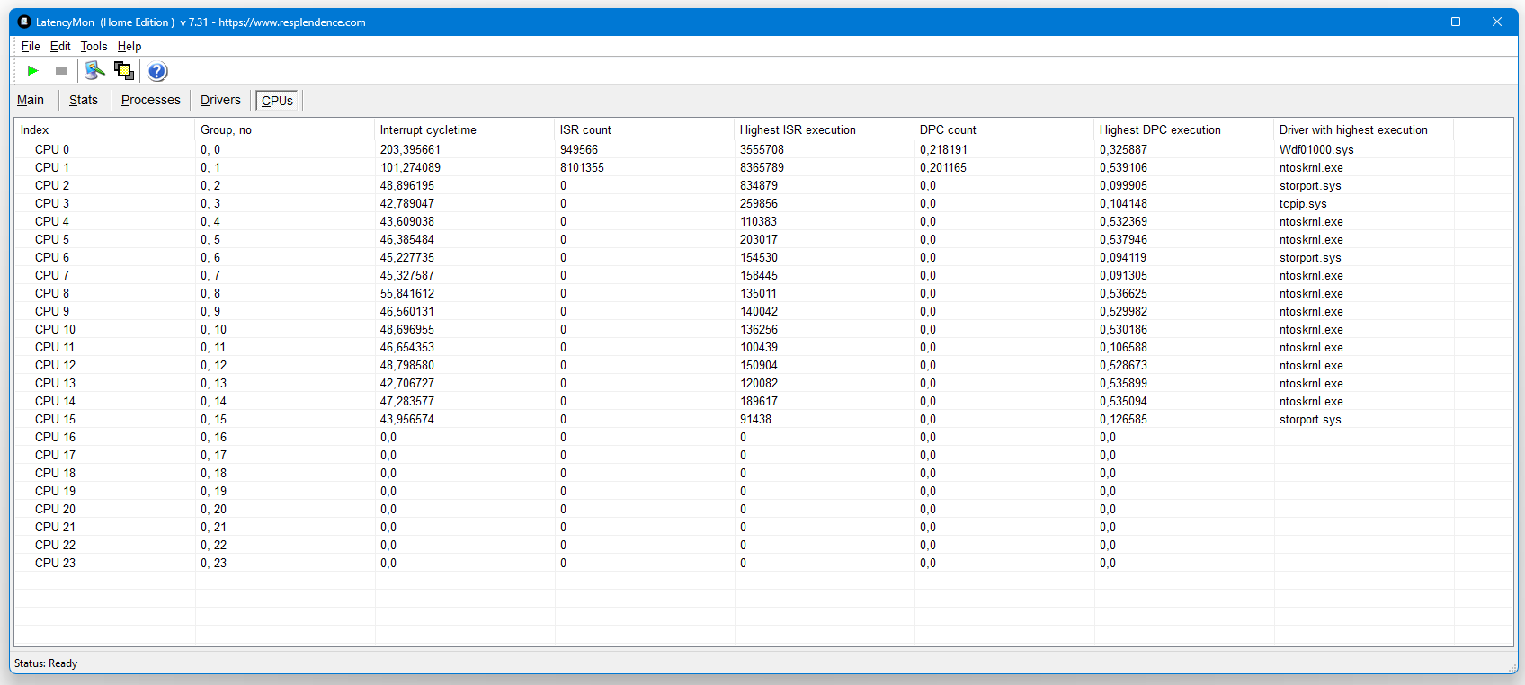

LatencyMon
When I disable settings on my network card, such as FlowControl or Interrupt Moderation, it doesn't improve as expected, but actually gets worse.
My thought is: You're disabling options, so your CPU has to work harder...
LatencyMon reports terrible performance. Since I moved my (external) NIC (TPLink TX201 with an RTL8125B chip) and GPU to other cores, the values seem to have improved significantly, and Battlefield 6 also runs better (Hitreg). No, not perfectly, but better.
It's like a puzzle.

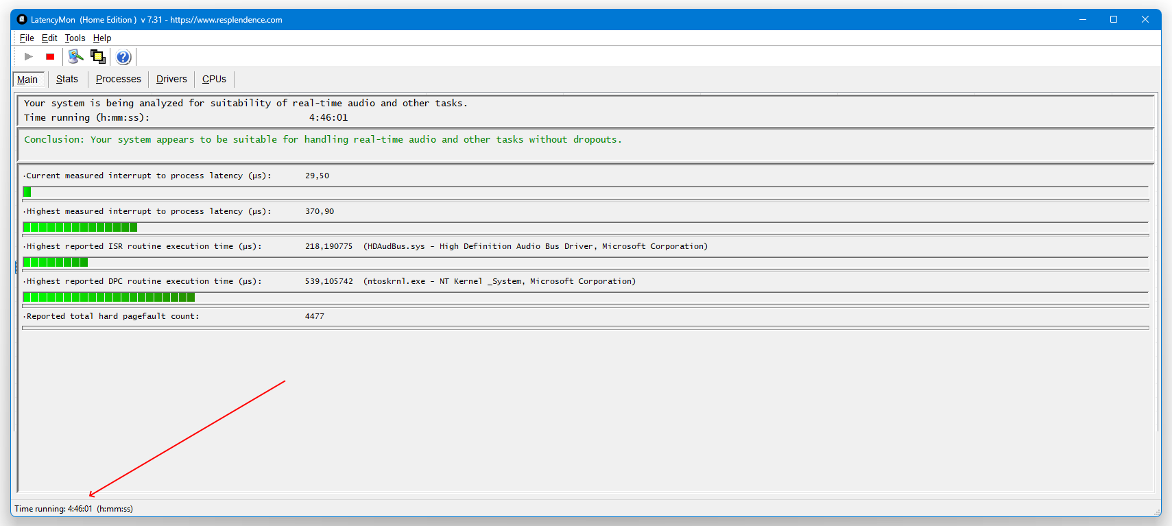

Perhaps your eagle eyes will spot something?_________________________________________________________________________________________________________
CONCLUSION
Your system appears to be suitable for handling real-time audio and other tasks without dropouts.
LatencyMon has been analyzing your system for 4:46:03 (h:mm:ss) on processors 0,1,2,3,4,5,6,7,8,9,10,11,12,13,14 and 15.

The interrupt to process latency reflects the measured interval that a usermode process needed to respond to a hardware request from the moment the interrupt service routine started execution. This includes the scheduling and execution of a DPC routine, the signaling of an event and the waking up of a usermode thread from an idle wait state in response to that event.
Highest measured interrupt to process latency (µs): 370,90
Average measured interrupt to process latency (µs): 3,662634
Highest measured interrupt to DPC latency (µs): 256,40
Average measured interrupt to DPC latency (µs): 1,637087

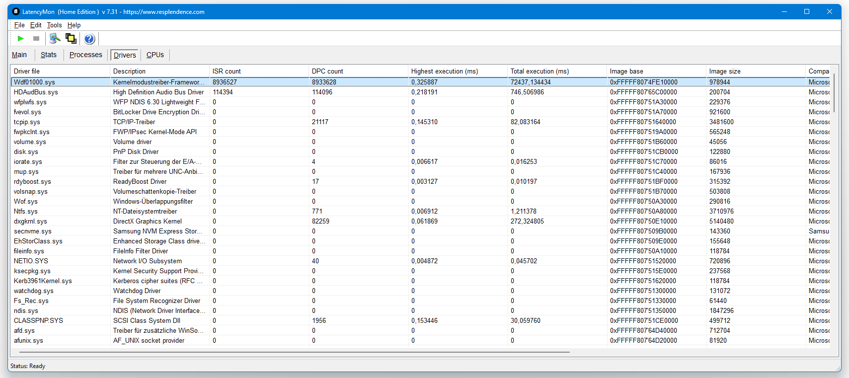

REPORTED ISRs
Interrupt service routines are routines installed by the OS and device drivers that execute in response to a hardware interrupt signal.
Highest ISR routine execution time (µs): 218,190775
Driver with highest ISR routine execution time: HDAudBus.sys - High Definition Audio Bus Driver, Microsoft Corporation
Highest reported total ISR routine time (%): 0,004787
Driver with highest ISR total time: Wdf01000.sys - Kernelmodustreiber-Frameworklaufzeit, Microsoft Corporation
Total time spent in ISRs (%) 0,004945

REPORTED DPCs
DPC routines are part of the interrupt servicing dispatch mechanism and disable the possibility for a process to utilize the CPU while it is interrupted until the DPC has finished execution.
Highest DPC routine execution time (µs): 539,105742
Driver with highest DPC routine execution time: ntoskrnl.exe - NT Kernel & System, Microsoft Corporation
Highest reported total DPC routine time (%): 0,012797
Driver with highest DPC total execution time: Wdf01000.sys - Kernelmodustreiber-Frameworklaufzeit, Microsoft Corporation
Total time spent in DPCs (%) 0,016265

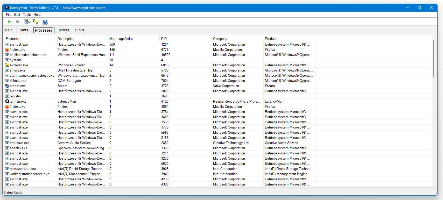

REPORTED HARD PAGEFAULTS
Hard pagefaults are events that get triggered by making use of virtual memory that is not resident in RAM but backed by a memory mapped file on disk. The process of resolving the hard pagefault requires reading in the memory from disk while the process is interrupted and blocked from execution.
NOTE: some processes were hit by hard pagefaults. If these were programs producing audio, they are likely to interrupt the audio stream resulting in dropouts, clicks and pops. Check the Processes tab to see which programs were hit.
Process with highest pagefault count: svchost.exe
Total number of hard pagefaults 4477
Hard pagefault count of hardest hit process: 942
Number of processes hit: 14

CPU 0 Interrupt cycle time (s): 203,395661
CPU 0 ISR highest execution time (µs): 218,190775
CPU 0 ISR total execution time (s): 1,530103
CPU 0 ISR count: 949566
CPU 0 DPC highest execution time (µs): 325,886727
CPU 0 DPC total execution time (s): 42,357743
CPU 0 DPC count: 3555708
CPU 1 Interrupt cycle time (s): 101,274090
CPU 1 ISR highest execution time (µs): 201,165359
CPU 1 ISR total execution time (s): 18,840577
CPU 1 ISR count: 8101355
CPU 1 DPC highest execution time (µs): 539,105742
CPU 1 DPC total execution time (s): 19,217175
CPU 1 DPC count: 8365789
CPU 2 Interrupt cycle time (s): 48,896196
CPU 2 ISR highest execution time (µs): 0,0
CPU 2 ISR total execution time (s): 0,0
CPU 2 ISR count: 0
CPU 2 DPC highest execution time (µs): 99,904612
CPU 2 DPC total execution time (s): 1,074041
CPU 2 DPC count: 834879
CPU 3 Interrupt cycle time (s): 42,789048
CPU 3 ISR highest execution time (µs): 0,0
CPU 3 ISR total execution time (s): 0,0
CPU 3 ISR count: 0
CPU 3 DPC highest execution time (µs): 104,148415
CPU 3 DPC total execution time (s): 0,307495
CPU 3 DPC count: 259856
CPU 4 Interrupt cycle time (s): 43,609038
CPU 4 ISR highest execution time (µs): 0,0
CPU 4 ISR total execution time (s): 0,0
CPU 4 ISR count: 0
CPU 4 DPC highest execution time (µs): 532,368685
CPU 4 DPC total execution time (s): 0,314797
CPU 4 DPC count: 110383
CPU 5 Interrupt cycle time (s): 46,385484
CPU 5 ISR highest execution time (µs): 0,0
CPU 5 ISR total execution time (s): 0,0
CPU 5 ISR count: 0
CPU 5 DPC highest execution time (µs): 537,946031
CPU 5 DPC total execution time (s): 0,319090
CPU 5 DPC count: 203017
CPU 6 Interrupt cycle time (s): 45,227736
CPU 6 ISR highest execution time (µs): 0,0
CPU 6 ISR total execution time (s): 0,0
CPU 6 ISR count: 0
CPU 6 DPC highest execution time (µs): 94,118607
CPU 6 DPC total execution time (s): 0,336651
CPU 6 DPC count: 154530
CPU 7 Interrupt cycle time (s): 45,327588
CPU 7 ISR highest execution time (µs): 0,0
CPU 7 ISR total execution time (s): 0,0
CPU 7 ISR count: 0
CPU 7 DPC highest execution time (µs): 91,304675
CPU 7 DPC total execution time (s): 0,307675
CPU 7 DPC count: 158445
CPU 8 Interrupt cycle time (s): 55,841612
CPU 8 ISR highest execution time (µs): 0,0
CPU 8 ISR total execution time (s): 0,0
CPU 8 ISR count: 0
CPU 8 DPC highest execution time (µs): 536,625353
CPU 8 DPC total execution time (s): 0,411459
CPU 8 DPC count: 135011
CPU 9 Interrupt cycle time (s): 46,560131
CPU 9 ISR highest execution time (µs): 0,0
CPU 9 ISR total execution time (s): 0,0
CPU 9 ISR count: 0
CPU 9 DPC highest execution time (µs): 529,981801
CPU 9 DPC total execution time (s): 0,419263
CPU 9 DPC count: 140042
CPU 10 Interrupt cycle time (s): 48,696955
CPU 10 ISR highest execution time (µs): 0,0
CPU 10 ISR total execution time (s): 0,0
CPU 10 ISR count: 0
CPU 10 DPC highest execution time (µs): 530,185755
CPU 10 DPC total execution time (s): 0,339418
CPU 10 DPC count: 136256
CPU 11 Interrupt cycle time (s): 46,654353
CPU 11 ISR highest execution time (µs): 0,0
CPU 11 ISR total execution time (s): 0,0
CPU 11 ISR count: 0
CPU 11 DPC highest execution time (µs): 106,588328
CPU 11 DPC total execution time (s): 0,286082
CPU 11 DPC count: 100439
CPU 12 Interrupt cycle time (s): 48,798580
CPU 12 ISR highest execution time (µs): 0,0
CPU 12 ISR total execution time (s): 0,0
CPU 12 ISR count: 0
CPU 12 DPC highest execution time (µs): 528,672733
CPU 12 DPC total execution time (s): 0,402768
CPU 12 DPC count: 150904
CPU 13 Interrupt cycle time (s): 42,706727
CPU 13 ISR highest execution time (µs): 0,0
CPU 13 ISR total execution time (s): 0,0
CPU 13 ISR count: 0
CPU 13 DPC highest execution time (µs): 535,899278
CPU 13 DPC total execution time (s): 0,262770
CPU 13 DPC count: 120082
CPU 14 Interrupt cycle time (s): 47,283577
CPU 14 ISR highest execution time (µs): 0,0
CPU 14 ISR total execution time (s): 0,0
CPU 14 ISR count: 0
CPU 14 DPC highest execution time (µs): 535,093505
CPU 14 DPC total execution time (s): 0,332686
CPU 14 DPC count: 189617
CPU 15 Interrupt cycle time (s): 43,956575
CPU 15 ISR highest execution time (µs): 0,0
CPU 15 ISR total execution time (s): 0,0
CPU 15 ISR count: 0
CPU 15 DPC highest execution time (µs): 126,584562
CPU 15 DPC total execution time (s): 0,312759
CPU 15 DPC count: 91438

LaggyTyp
- Posts: 219
- Joined: 07 Apr 2024, 16:16
Re: No FPS gaming possible
Here's the thing...
I took a picture of my Telekom wall socket (TAE socket) and posted it in a forum. The response was that the cable wasn't connected correctly because it wasn't connected with a special tool, which apparently is how it has to be connected.
I bought the tool and re-clipped the cable yesterday.
Then this happened:
According to the DSL info on my Asus router, two things changed:
1) The download bandwidth increased by about 7 Mbps.
2) My INP increased from 63 (download) and 30 (upload) to 63 (download) and 34 (upload).
Since this, gaming has become significantly worse again, and I started complaining in the forum again.
I reinstalled the cable again today. I shortened it a bit and clipped it in properly.
Now my router is showing me an INP of 63 (download) and 30 (upload) again, and gaming is better again.
Could this be related? Because the gaming performance degradation started immediately after that and disappeared just as quickly.
Background: The cable was slightly smeared with wall paint at the clip point.
Then this happened:
