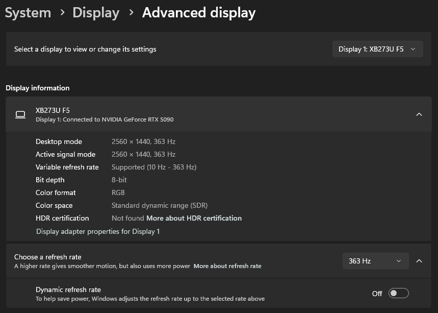

/Edit1:

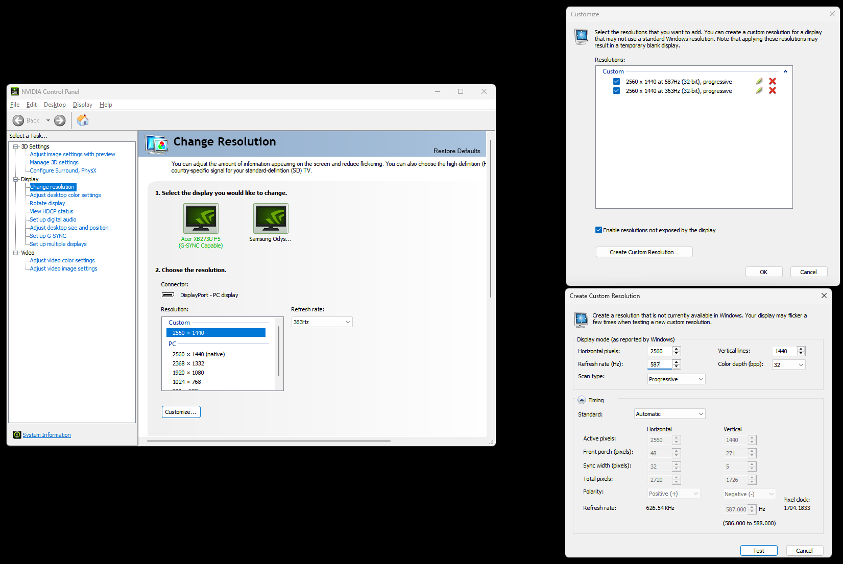

  • Out of curiosity, I tried overclocking the monitor's refresh rate and discovered that my unit will go up to 587 Hz. Which is nuts, to be honest! However, doing so effectively disables both Pulsar functionality and VRR.
Regardless, I think it's pretty cool to see an IPS panel of this nature working at those speeds. Even without the motion clarity benefits of Pulsar and the convenience of VRR, the smoothness at such a high refresh rate is quite impressive.
  • I also found that overclocking the panel to 363Hz is as far as my unit will go while still maintaining Pulsar functionality and VRR.
Screenshot 2026-04-21 093331.png (20.25 KiB) Viewed 7040 times
Screenshot 2026-04-21 100139.png (58.34 KiB) Viewed 7040 times

It displays fine at 587hz? I want to try this now, I have the same Acer monitor. How can I test this?
Could you try out the frameskipping test? https://testufo.com/frameskipping

It appeared so at first glance, but frameskipping does exist while at 587hz.
Fortunately, you can pre‑test the created “custom resolution” each time before confirming and adding it.
Screenshot 2026-04-21 124457.png (131.12 KiB) Viewed 6907 times
Note 1: I only changed the refresh‑rate values; I didn’t modify anything else and left the “timing” setting on automatic. It’s also worth mentioning that I used small stepped increments until I arrived at that value.
You nailed it—frame skipping definitely occurs at 587 Hz.
However, a quick test at 363 Hz seems stable.
Edit: After further testing, it appears that 388 Hz is the maximum refresh rate this panel can handle without frame skipping.
Cheers and thank you!
Just tried it, yeah its frame skipping, tried 400hz too.

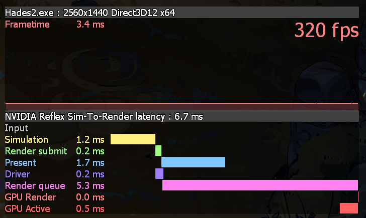

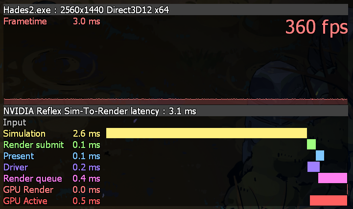

I also did further latency testing in Hades 2 (Single Monitor) using the RTSS Reflex Overlay.
  • V-Sync OFF: 360 fps in-game cap, refresh rate 320/321 Hz, noticeable screen tearing. Sim to Render Latency 3.1 ms
Screenshot 2026-04-22 152618.png (173.38 KiB) Viewed 6713 times
  • V-Sync ON: 320/321 fps, refresh rate 320/321 Hz. No screen tearing. Sim to Render Latency 6.7 ms

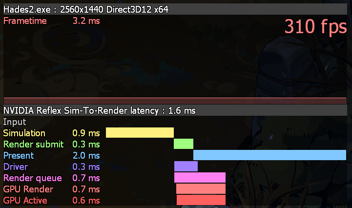

  • RTSS ASYNC: 310 fps cap, refresh rate 310 Hz. No screen tearing. Sim to Render Latency 1.6 ms
Screenshot 2026-04-22 153200.png (172.2 KiB) Viewed 6713 times
Note1:
V‑Sync ON/OFF made no difference when using RTSS ASYNC cap set to 310 fps. There was no screen tearing either way, and latency was the same.
Note2:
Using RTSS ASYNC cap set to 310 also "fixes" the refresh rate and fps desync that happens when Alt‑Tabbing.
Interestingly, RTSS Reflex (before/after frame presentation) does not do that. Both presentation methods have more Sim‑to‑Render latency than ASYNC, which is also weird. Normally, using an RTSS Reflex cap (with a regular, non‑Pulsar monitor) would have better Sim‑to‑Render latency, with "after frame presentation" having a slight edge.

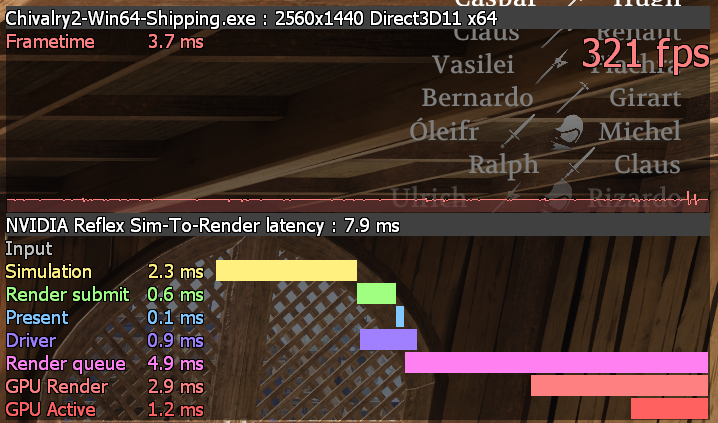

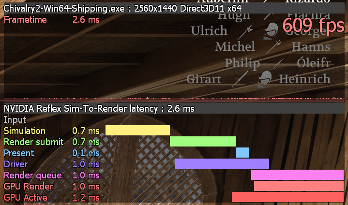

Further latency testing in Chivalry 2 (Single Monitor) using the RTSS Reflex Overlay.
  • V-Sync OFF: Unlocked framerate, refresh rate 320/321 Hz, noticeable screen tearing. Sim to Render Latency 2.6 ms
Screenshot 2026-04-22 163402.png (378.13 KiB) Viewed 6711 times
  • V-Sync ON: 320/321 fps, refresh rate 320/321 Hz. No screen tearing. Sim to Render Latency 7.9 ms
Screenshot 2026-04-22 163447.png (381.23 KiB) Viewed 6711 times

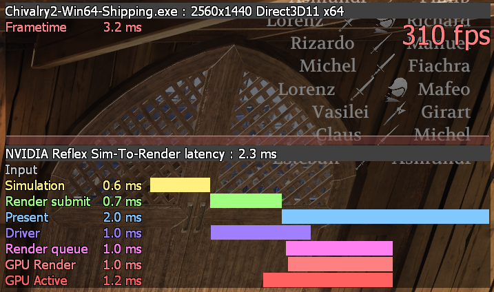

  • RTSS ASYNC: 310 fps cap, refresh rate 310 Hz. Sim to Render Latency 2.3 ms
Screenshot 2026-04-22 163533.png (401.06 KiB) Viewed 6711 times
Note1:
V‑Sync ON/OFF did NOT make a difference when using RTSS ASYNC cap set to 310 fps. Latency was the same in both cases.

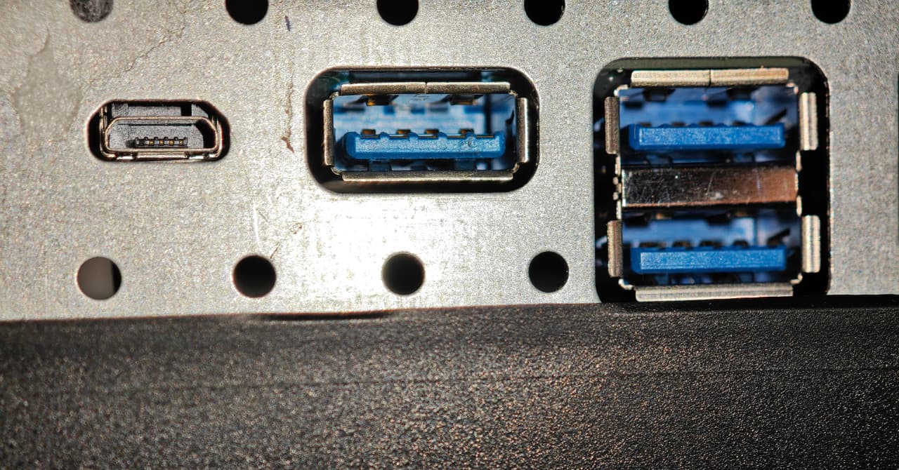

Hey guys, haven't found many other posts online regarding the XB27U3 F5 so might as well try this one.
I've been unable to update my firmware as the Micro USB port that the monitor should have is blocked on my unit. Could you please confirm if your unit has said Micro USB port acessible?
I've found a reference photo online of the back I/O of the monitor both with the Micro USB port visible and blocked. Also tried contacting Acer's customer support and they replied telling me that the firmware supposedly could be update by using the USB Tybe-B cable, though I've tried that and the NVIDIA web solution for firmware update didn't recognize my monitor.
After informing Acer's support of said situation, they changed their stance and is now claiming that the XB273U F5 is not user serviceable and is a 'plug-and-play' monitor, with all features already working as intended and not firmware upgradable. Which, needless to say, is insane. They've gone as far as saying that the updated 60Hz lower-bound should be handled through my 'GPU drivers and Windows environment'. Honestly, I'm baffled by their response.
Oh, and to add insult to injury, they stated that if I were to remove said plastic cap, I'd have my warranty voided.
I'm compiling information to bring awareness to this issue and hopefully have it fixed for others.

I just peeled off that "hard plastic sticker" and updated my monitor without any issues.
acer predator xb273u f5 HIDDEN Micro-B USB.jpg (164.5 KiB) Viewed 6442 times

I understand your situation as there’s no official information provided by Acer regarding this matter.
The only legitimate source I could find for updating the monitor’s firmware is found in the "NVIDIA G-SYNC Pulsar Monitor Firmware Update" website.
