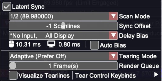

I use latent sync and it's dead-easy to configure. You just right-click and check the "latent sync" box and then select one of the FPS cap modes :P (I use 1/2 mode so I get 120FPS at 240Hz or 90FPS at 180Hz.)

You don't have to do that because you can just enable vsync (by setting the tearing mode). Like this:
"Adaptive prefer off" turns on vsync, but disables it for only 1 frame when render latency exceeds your target. Setting your "render queue" target to 1 should provide a good latency. If you just use straight up vsync without trying to cap like this, you get a render latency of either 2 or 3 (depending on whether double-buffered or triple-buffered vsync is used.) Using SK render queue setting allows you to limit render latency to 1, which also means it prevents vsync backpressure lag which happens when render latency is maxed out. In my experience, this setup always gives good latency. Not as good as g-sync + VRR cap, which always has a render latency of 0. But it's still good.
Set your "scan mode" setting depending on what FPS you want. Note that if the scan mode you set is lower than 1/1 (like 1/2, 1/3, etc.) then the above text about the render queue doesn't apply, since render latency is always going to be either 0 or 1 when FPS is lower than Hz. So for scan mode 1/1, you can just set tearing mode to "Always off", which gives you a perfectly frame capped low latency vsync.

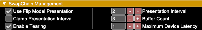

However, for DX11 games (DX12 won't work), you have the option of using vsync (full vsync or fractions 1/2, 1/3 or 1/4) without any FPS cap and still get only a 1 frame render latency by using these settings in the "Swapchain management" section of SK:
The "presentation interval" setting is your vsync control. 1 is normal vsync, 2 is 1/2 vsync, 3 is 1/3 vsync and 4 is 1/4 vsync. Set this to what you want your FPS to be and make sure the FPS limiter checkbox is disabled.
Sadly, some games simply don't tolerate a max device latency lower than 2 and might crash (either right away or after a while.) But when it works, the latency you get is also very low. Your current render latency value is shown in the frame time graph of SK.
