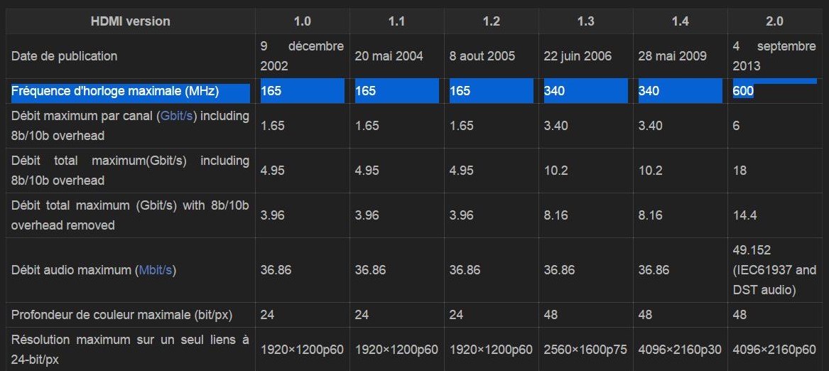

Hi! To make it short, I had a DVI-D cable and was able on my (BenQ XL2420Z) to go up to 374Mhz without problem once I'd use the (AMD Pixel Clock Patch v1.3.3) but then my cable just died from unplugging it somehow and I went to the dollarstore and bought a cheap 3$ (3D HDMI Cable) so I'd guess it is at least v1.3 which is still suppose to go up to 340Mhz but I keep getting "Out of range" message when I go above 85Hz so WTF!? That is my first issue.
The second one is mostly a question. I've noticed my monitor and R9 280X are both DP v1.2, but I have no idea what is the highest pixel clock rate possible to use for those cables if I want to OC my monitor. It is fantastic if it is 540Mhz but if it is 162 or 270 then it's really bad and I want to know before buying such cable as they tend to be very rare and overpriced! "DP uses one, two, or four differential serial data paths to carry the video and audio. The data is self-clocking at a bit rate of 1.62, 2.7, or 5.4 Gbits/s per path using clock rates or 162, 270, or 540 MHz."
Thanks a lot in advance for the info.
Alex
Alex

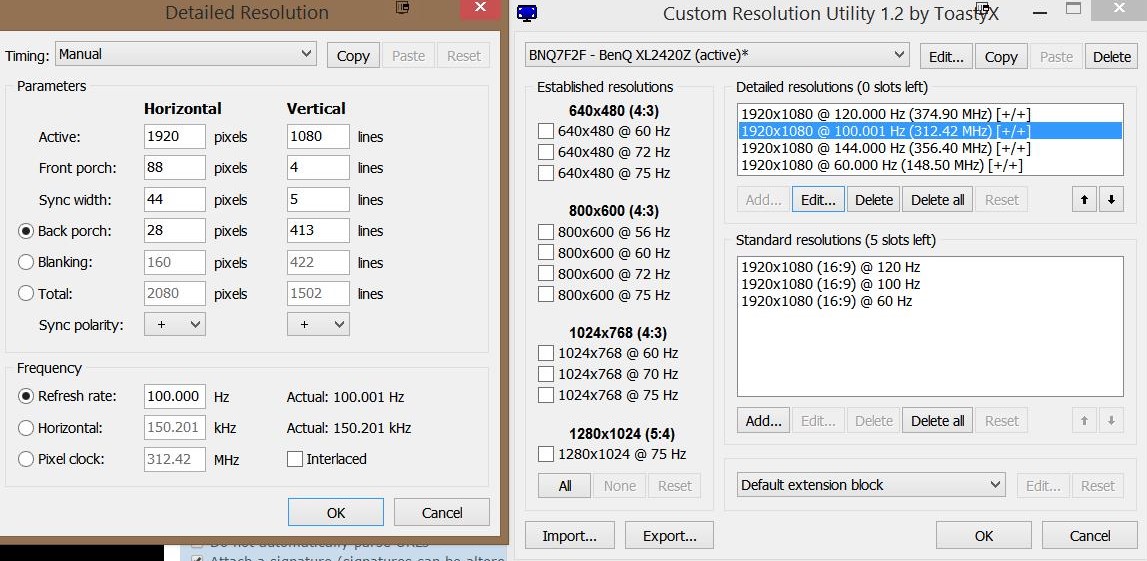

So pretty much it doesn't matter if I use DP or DVI behind my video card, as long as I am connected through DVI behind the monitor???kodachrome wrote:Generally due to the scaler you cannot overclock DP inputs on the monitor side, only via adapters from DP on your PC to DVI on the monitor side. So there is no point in pursuing that avenue. On your first issue.. prolly easiest to just get a proper DVI cable again?
I never heard before that it wasn't even possible to overclock the DP input, but only the DVI. Since when is it like this and is it on any monitor?! Somehow it seems to be working as I can be at 312Mhz "100Hz" without problem now and I confirm that it works on TestUfo.
I had a problem since I use a DP cable, that when I was waking up from sleep, the resolution would go from 1920x1080 to something extremly tiny and mess all my icons on the desktop until I'd reboot, but it never did that if I'd shutdown and start again the computer. Now however, I think it has been fixed when I wake up from sleep since I've updated the driver to the latest one.
- Image #001.jpg (182.23 KiB) Viewed 25126 times
