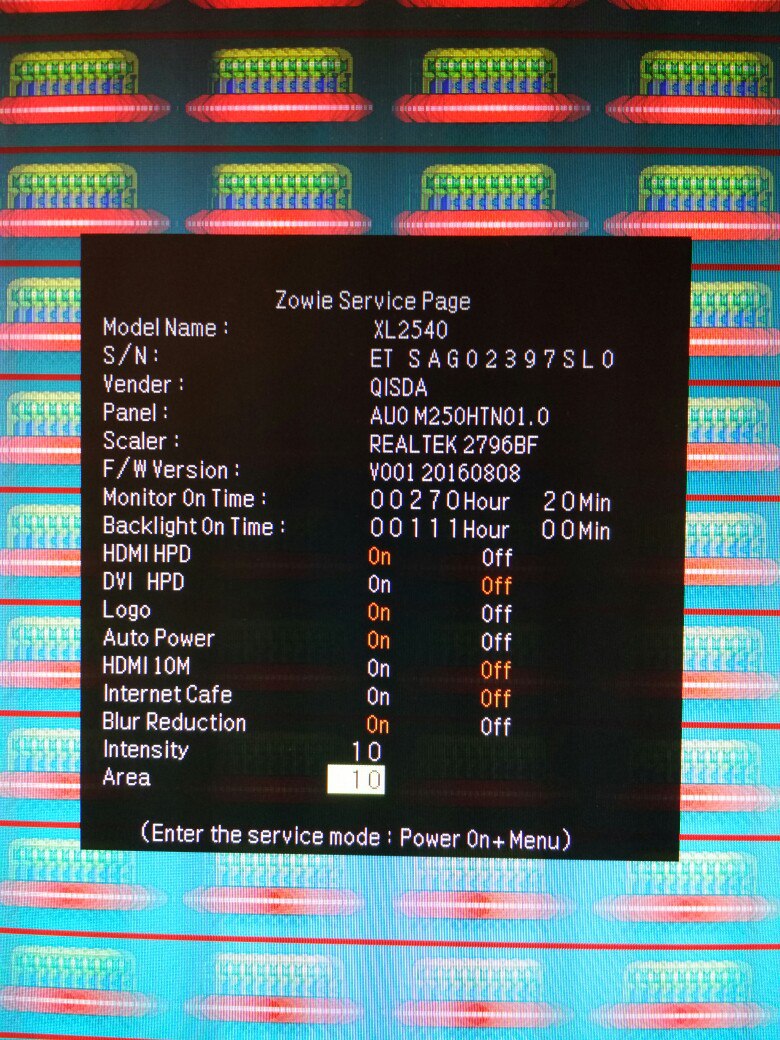

Hello all,
How do you go in to Service Page and turn on the Blur reduction? I can't seem to find a way to enter the Service Page..
Much appreciated!
Q83Ia7ta
Posts: 761
Joined: 18 Dec 2013, 09:29
Re: Presenting the ZOWIE XL2540 240Hz
Post by Q83Ia7ta » 22 Jan 2017, 08:54
tungchihyu wrote:Hello all,
Much appreciated!
1. Turn OFF monitor by power button
2. Press and hold menu button (2nd button from right excluding power button)
3. Turn ON monitor by power button
4. Wait few seconds while monitor turns on (wait for desktop show up)
5. Release menu button and press it again
And you will get into "Zowie Service Page".

So this monitor basically has "dyac" but they hid it in the service menu?

Vantavia wrote:So this monitor basically has "dyac" but they hid it in the service menu?
If dyac is just a blur reduction mode then answer yes. May be this blur reduction mode in XL2540 is unfinished because "Intensity" seems like doesn't work.
