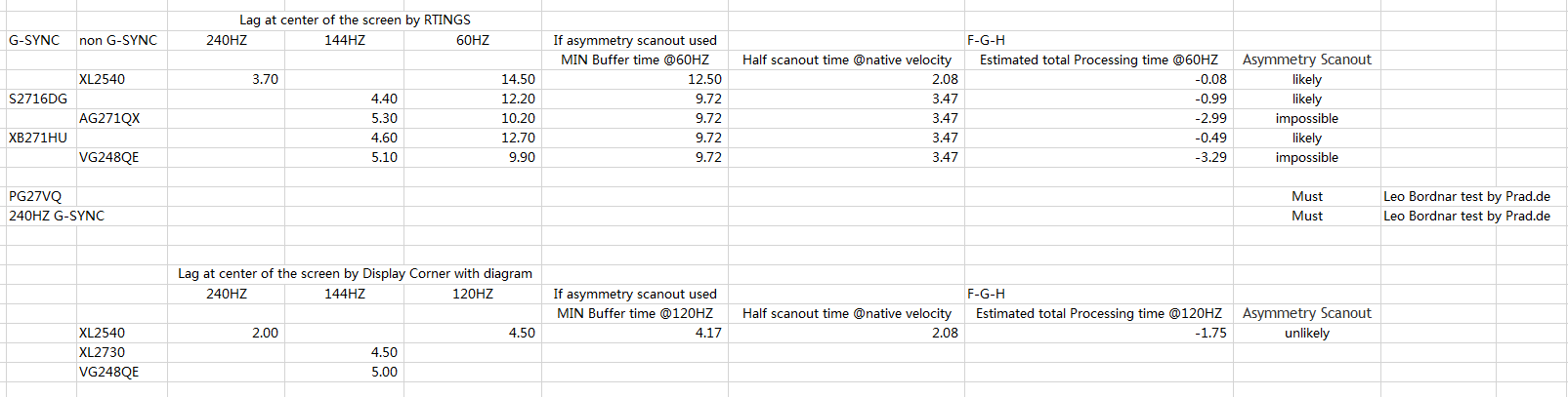

I collect some lag numbers from RTINGS and Display Corner and made some simple calculation to see if the monitor uses asymmetry Scanout
LAG Analyzation.png (34.45 KiB) Viewed 6957 times

KKNDT wrote:I collect some lag numbers from RTINGS and Display Corner and made some simple calculation to see if the monitor uses asymmetry Scanout
A good (but incomplete) attempt.
The problem is asymmetric scanout may only happen at some refresh rates.
And not all testers disclose the refresh rate they test lag at.
Some only test lag of 60Hz.
Accurate disclosure is a big problem.

Here's another lag test result , 34UC89G
This makes me think that all the G-SYNC monitors do asymmetry scanout at (60HZ + HDMI at least).
