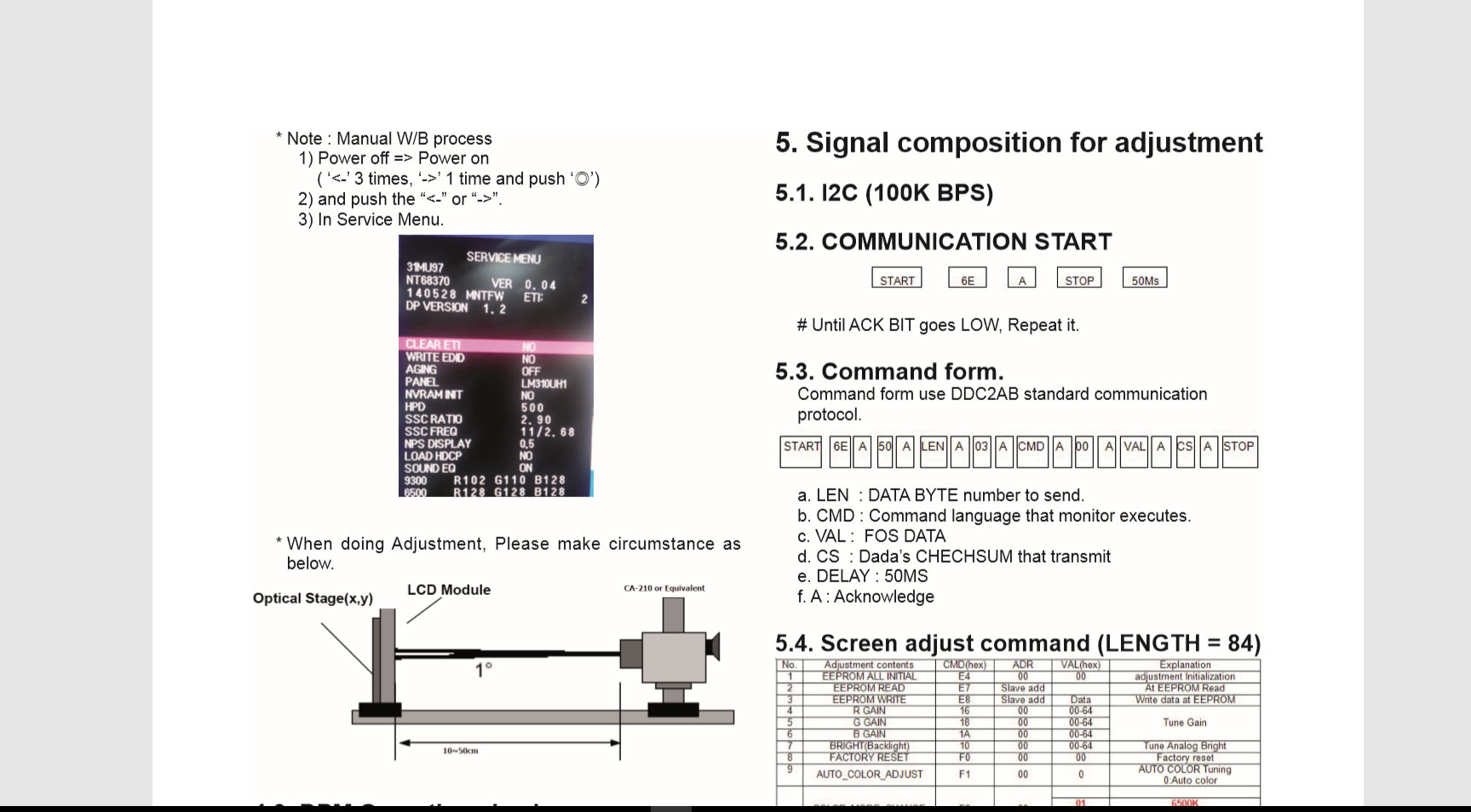

so a couple of days ago my LG31MU97 monitor Displayports went crazy. after reading online looks like the EDID is corrupted The HDMI works at 4K but only at 30hz. I need Displayport so i can run at 4K DCI at 60hz I was able to get the service manual but cant figure out how to get into the mode.
I was hoping to reflash the NVRAM, but can't figure out to get into service mode even with the instructions. This monitor uses joystick
again thanks
again thanks
- LG.jpg (194.23 KiB) Viewed 22402 times

Hmm... that's a first instructions I saw for any LG monitor with joystick, to get in Service menu.
Did you tried that sequence?
1. Power off, then power on
2. Push left 3 times, then right 1 time, and then press the joystick button
3. Then press left or right and you should get in service menu.
ps. Pls give a link where did you found this adjustment manual. Maybe there is something interesting for other newer LGs.

thanks for the reply i have the complete service manual i will post online btw i tried it. still no luck do i use the power switch in the back or use the joystick to turn it on and off.

After a bit of experimentation, figured out that what they actually mean is:
* Power off the monitor (soft power-off is fine).
* Press left-left-left-right *while off* (this is the only "magic sequence" bit).
* Press the middle "select" button to power on as normal.
* When the display is on as normal, press the "select" button then press left to choose "Menu" (i.e. as normal), but "Menu" is now tied to the service menu until the next power cycle.
* To exit the service menu, scroll to the blank bar at the bottom and press "select".

OMG thankyou finally got into service menu. i am fnally able to use my monior again it was in storage because the DisplayPort didnt work. now its finally working again thanks again.

glade it worked for you just right now my display port EDID file went corrupt and reset it in service menu. With this i can finally fix it if it goes bad again
The NVRAM INIT it is to re-flash the EEPROM where the EDID is stored.

THANK YOU. This was so poorly explained everywhere else I could no get into the service menu. I was stuck at UHD instead of 4096x2160 with my LG 31MU97 until I was able to get in and rewrite my EDID. (after it working fine for a couple of years). I registered just to thank you for this, I was stuck without it.
