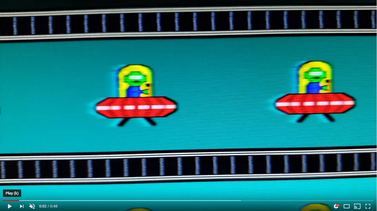

How To Reverse Engineer Overdrive Gain on FreeSync Displays?
Apparently, you did read the pursuit instructions, so good job doing a pursuit camera via hand-waved smartphone! (For other readers, see Easy Pursuit Camera 101 Instructions) -- the hand-wave iPhone video camera following the UFOs on the http://www.testufo.com/ghosting test.
Screenshot of one of the better single-frame-steps (the , and . keys to single framestep a YouTube)
TestUFO Without FreeSync at 0:02
TestUFO With FreeSync (Full framerate, GSYNC Compatible + Windowed Mode) at 0:17
No, I can confirm it's not a hidden DRM-protected protocol.
The same thing actually happens when you use an AMD card too (depending on how the drivers are configured, you MAY have to go into full screen mode with "chrome --disable-gpu-vsync" to properly trigger the AMD FreeSync into working with TestUFO on AMD cards when the browser is running in full screen mode).
It's simply the monitor automatically using a different Overdrive Gain setting when FreeSync is enabled (rather than disabled), or the existence of Dynamic Overdrive. Since the AW2518H doesn't have dynamic overdrive (read Why Variable Overdrive is needed for Good Variable Refresh Rate), I think it's simply changing to a more optimal overdrive setting whenever FreeSync is enabled.
Even for non-dynamic overdrive, some manufacturers keeps their better overdrive settings only for FreeSync mode, so everything looks crappy-ghosty when FreeSync is turned off but looks much better when FreeSync is enabled.
On some monitors, via Factory Menu or Service Menu, I am able to adjust an Overdrive Gain setting between value 0x00 through 0x80 which produces the same effect in non-FreeSync modes (both image #1 and #2). Overdrive Gain is a generic setting built into many panels. Simple few-setting overdrive adjustments are often mapping to hardcoded Overdrive Gain settings.
