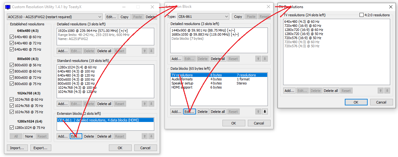

So I changed to an AMD card. After all these years, you still can't force highest refresh from driver? What a joke. You can't even change refresh in AMD control panel. The custom resolution section won't even let me go past 200hz (it's a 240hz monitor).
So I used toasty CRU. But when I created a 240hz custom resolution at 1920x1078, it run in all refresh rates (60, 100, 120, 144, 240). With nvidia control panel, I was used to the 1920x1078 resolution ONLY being 240hz, and it forced games into that refresh rate. Does anyone know a way of doing this with CRU?
Thanks in advance.

Just in case anyone in the future reads this, CRU is excellent, and can indeed force your highest refresh in everything. Without any problems, that I have encountered, such as games starting up with blank screen and a "no signal" from your monitors on screen display etc.
Don't create a custom resolution at all. Just delete all the other refresh rates that you don't want:
https://www.youtube.com/watch?v=AQIU_at ... e=youtu.be
Make sure to click "ok" on all the windows, then click the "restart.exe" after you have finished with CRU.exe.
I advise leaving all the other resolutions to run in lower frequency refresh, just do it for your native resolution that you usually game at. So in my case, if I saw anything that was 1920x1080 that wasn't 240hz, bam, deleted it. As some of these damn games will fight to the death for their precious 60hz, and even run in 1920x1080i or 25/30hz, before they give it up and run at the proper high refresh :lol:
This was all done over a displayport cable. I also tried HDMI, afterwards. And the results weren't as good. Even though I removed all the refresh rates, except 240hz, there still remained 50, 59 and 60hz as selectable in windows display settings. So maybe it's some kind of built in thing that can't be removed in software. Make sure you disable freesync in "display" in AMD settings. Also, try running in a different resolution other than your native res, when you do this.
Overall, I am very happy. Now, if only AMDs frame pacing was up to par with nvidia's...I thought they sorted this out by now? Still, at least AMD runs the GPU core at the right P-state, when you run the desktop refresh in 240hz, which is something nvidia doesn't do right (core ran at like 900mhz, when the idle clock should have been like 160 something mhz :| )
