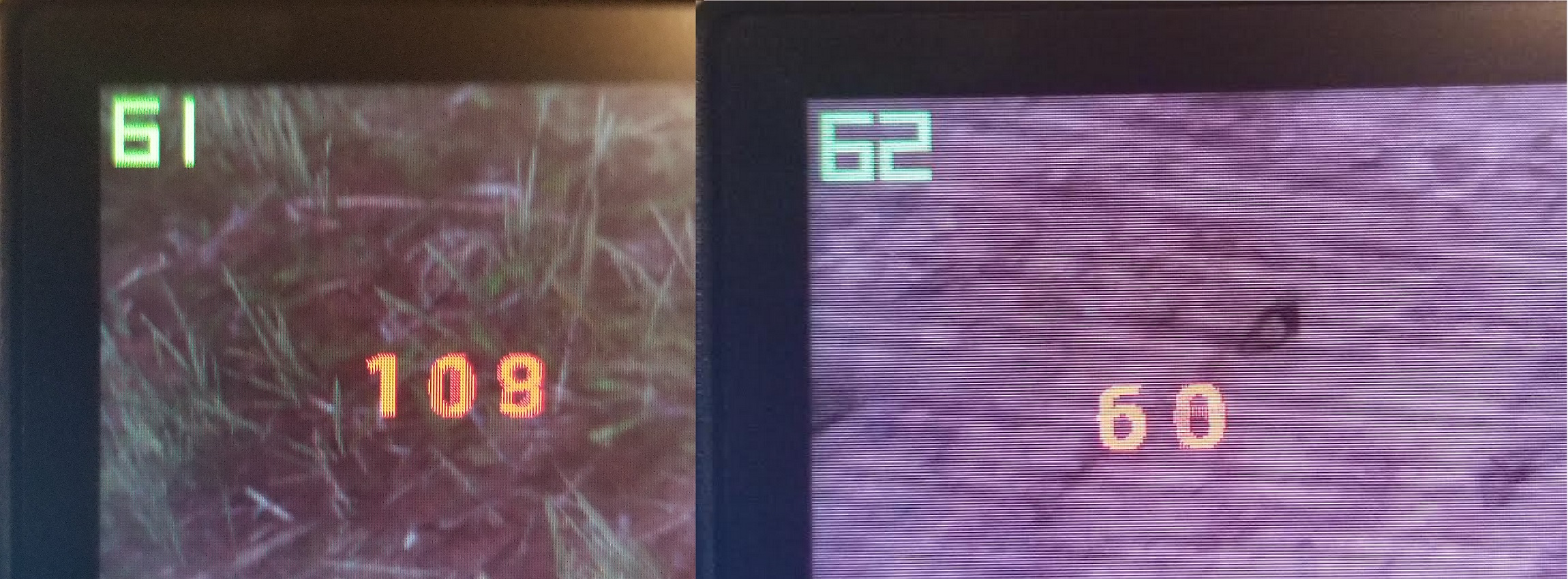

To answer your question, yes I am seeing the frame-rate in the monitor's OSD bounce back and forth between integer ratio 1 and 2 of the in-game framerate. See the screenshot below as an example. Green is the frame-rate reported by the nvidia overlay, and red/orange is the monitor's reported frame-rate.
In this case I had RTSS cap my frame-rate at 61 fps. Per the nvidia overlay the in-menu frame rate on several of the games I play (ex. Overwatch, RDR2, Starcraft 2) is capped at around 60 fps. But I see the fps in the monitor oscillating back and forth between 60 fps and 120 (ish) FPS, indicating to me that LFC is cycling on and off at 60 hz.
The effect is that there is a sort of flickering in brightness because (I assume) the intrinsic brightness of the monitor is slightly different at 60hz vs 120hz. I expected that behavior at 48 hz, but it doesn't seem like G-sync is using the configured freesync range.
