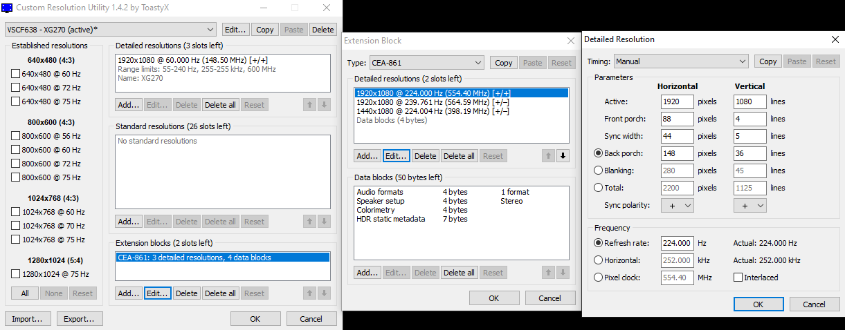

Where do i go to apply it after i create it in CRU. When i go under display setting and check for hz on that monitor there is like 10 different ones and but the 224 that i apply is not the same as the one in CRU since the pixel clock is different. When i look in the monitor menu information i see 554hz and when i look under windows display settings i see 8bit.

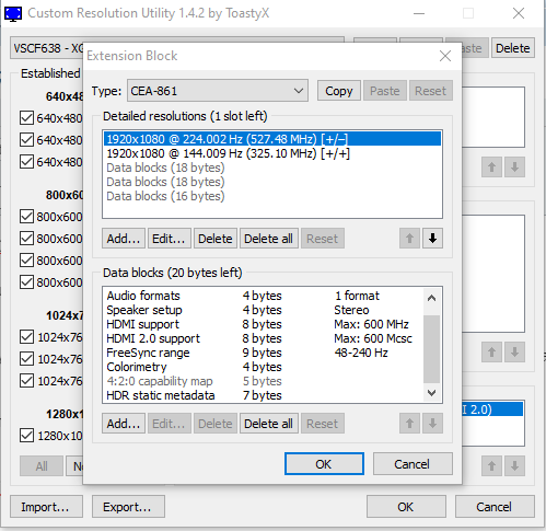

Just click add, select LCD Native and change the refresh rate under frequency to 224 and that's it, leave all the timings default of LCD Native. Here is how it should look like afterwards.
