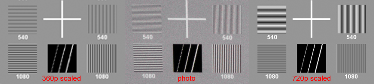

I don't know about the Celluon, but I actually have tested the MP-CL1. Resolution is approaching 720p, but it's hard to say without sharply defined pixels or scanlines.
Pics here compared with a 1080p LCD.
https://www.avsforum.com/threads/sony-m ... t-44716993
Celluon used Sony's engine so it's basically the same thing. Sony added some improvements like keystone adjustments and some other features iirc.
The pictures you linked to look very soft, doesn't even look remotely close to 720p, it doesn't look sharp at all. Really bad focus, looks blurrier than a lot of old consumer CRT's even.
It really looks as blurry as an upscale. Heck it's probably doing uspcaling from 360p to 720.
It's at least 540p as it's able to resolve all lines on those scales. It does look soft in those images. One factor could be that it's projecting on a painted white wall which has some sub-surface scatter leading to softness.
