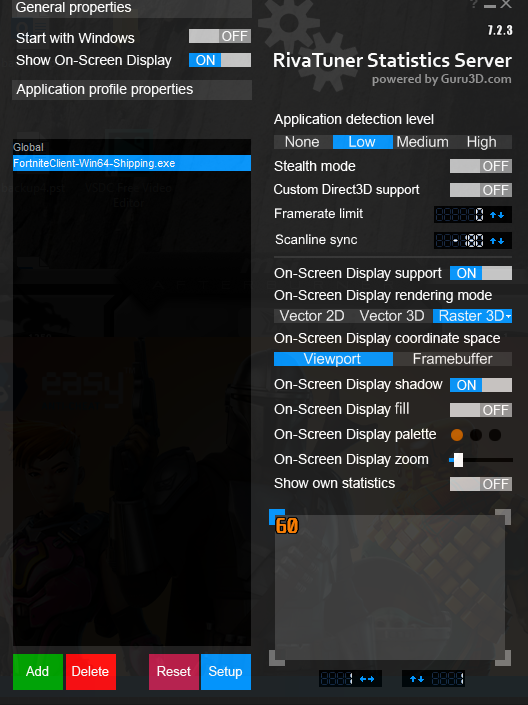

I need help. I have a lot of tearing in my 144 Hz monitor using RTSS. No vsync, fast sync or gsync configured.
This is a the 2 bars shows the tearing. Its in slow motion.
The RTSS configuration is this.
What is the problem?
Thank you.

You are dropping frames. From my experience and watching other streamers with beefy hardware I see Fortnite struggles with maintaining consistent frame rates. Also, in my experience scanline sync uses high load on one cpu core.
If you want to try and optimize this for higher minimum fps I'd recommend pulling up a msi afterburner fps graph to look out for the average minimum fps so that you can better judge whether or not scanline sync would be feasible.
