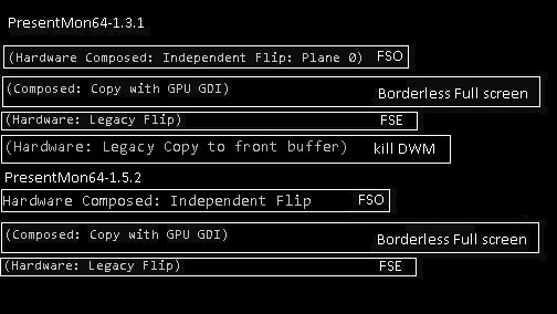

Yes, having two monitors, you can monitor these modes through PresentMon.
but I don't want to use the second monitor exclusively for this purpose 24/7.
Bought 3080 and couldn't use 1607 anymore. :(
Information about the modes from PresentMon64 for those who want to figure out what we are talking about.
