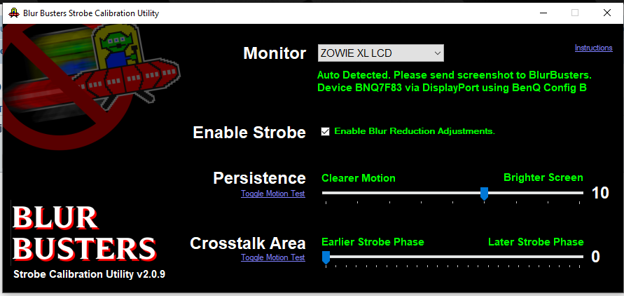

Hi,
I have been using Blur Busters Strobe Calibration Utility with my Zowie BenQ XL2546K monitor.
As for monitor detection, I get "ZOWIE XL LCD" and it says Device BNQ7F83. Here is a screenshot:
When adjusting the sliders, the expected changes do occur. That is, lower brightness with lower persistence, and modified horizontal positions of crosstalk artefacts with modified strobe phase.
I have different OSD profiles that I can activate through the S-switch. When I want to change persistence+phase on a particular OSD profile, I have to select this profile with the S-switch, open Blur Busters Strobe Calibration Utility, adjust the settings, save OSD profile. Then, when I want to change persistence+phase on another OSD profile, I have to close Blur Busters Strobe Calibration Utility, select the desired OSD profile with the S-switch, open Blur Busters Strobe Calibration Utility, adjust the settings, save OSD profile. This way, Blur Busters Strobe Calibration Utility will show different values for different OSD profiles, and they are saved for each OSD profile.
One little question: in the crosstalk test, it is not possible to not have quite visible crosstalk. Does it mean I should consider reducing refresh rate? I know 182 Hz was the advised trade-off found by experts, I would be curious if anyone with XL2546K could share their view on the optimal refresh rate.
I am running DyAc+ Premium, AMA Premium, 240 Hz.
Thanks,
Thanks,
Inco^

- Posts: 12131
Re: Strobe Utility 2.0 BETA Download!
Perfect, I probably can add XL2546K to BlurBustersStrobeUtility.ini configuration file this way.
If you are able, can you test all ports of your XL2546K to get device IDs for all ports (HDMI, DP) on your monitor?
For the DP, the ID is BNQ7F83.
For the 3 HDMI ports, the ID is BNQ7F84.
Regarding crosstalk, I will do some testing.*
I don't have vSync ON because my game drops below 240 fps at some (rare but not so rare) occurences. If I decrease my refresh rate, I could then maybe use vSync, which I think could help for better motion clarity. It's a pity I can't have G-Sync.
In the context of having DyAc+ removing lots of motion blur, when decreasing refresh rate, where am I losing mostly?
Response time?
Input lag? (corrected if I cap FPS to refresh rate minus 0.01 ?)
Motion blur? (not as much as without DyAc+ I suppose?)
*edit: well, I did some tests. I launched the utility and checked for crosstalk. It was still present but more faint as I decreased the refresh rate. Then I went ingame with 100 Hz and instantly saw that it was 'garbage' (sorry for wording). So much that at that point, I didn't even bother evaluate crosstalk. Then I went back ingame with 144 Hz and it was 'decent'. But still, the loss in motion clarity/quality made me forget about evaluating crosstalk. Then I went back ingame with 240 Hz and it was 'good'. Then I turned off DyAc+ to put things into perspective. DyAc+ OFF with 240 Hz was almost as good as with DyAc+ ON, and it was definitely better than 144 Hz with DyAc+ ON. Which makes me question the whole blur reduction thing and if I wouldn't be better served with a 360 Hz monitor. Now this is not my first 240 Hz monitor and this one is definitely smoother (DyAc+ ON or OFF) which tells me that having 360 Hz is no guarantee I will be better served. DyAc+ remains an improvement, though. But this monitor (XL2546K) with DyAc+ OFF is already a greater improvement, compared to my previous 240 Hz monitor (Y27gq-25).
Response time?
