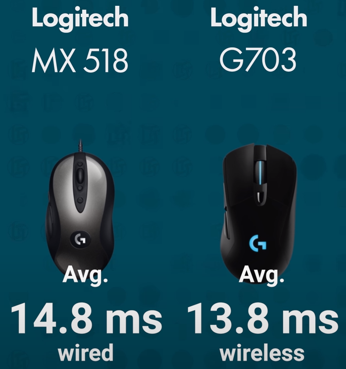

motion to pixel delay.png (273.86 KiB) Viewed 4804 times
The hammer tests performed by Linus is quite unique as it is absolute motion to pixel delay.
His test used a 240Hz monitor, and his csgo ran at ~270 fps.
He measured motion to pixel delay at 14.8ms for wireless g703, and 15.8ms for mx518 with hero sensor.
