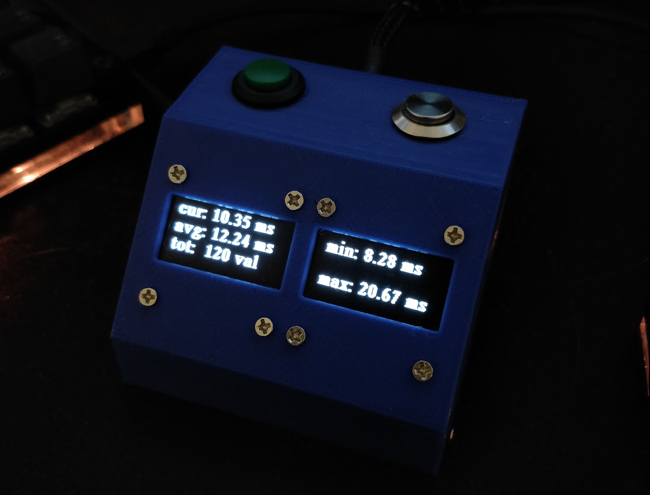

This is what it currently looks like :
current tester.png (562.7 KiB) Viewed 11973 times

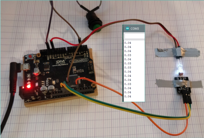

First, my goal was to find out how fast the arduino is without anything in, just the pure delay of the hardware and code.
The test setup for that looked like this :
bare test.png (497.52 KiB) Viewed 11973 times
The whole PC was replaced with a simple LED, and I was
- turning on the LED
- starting timer
- checking the photodiode for light change
- stopping the timer
This gave me results between 30 and 40 µs, over more than 1000 samples. The input lag of a (good) PC being between 10 and 20 ms, this is 0.2% of that. I'd call it good enough.

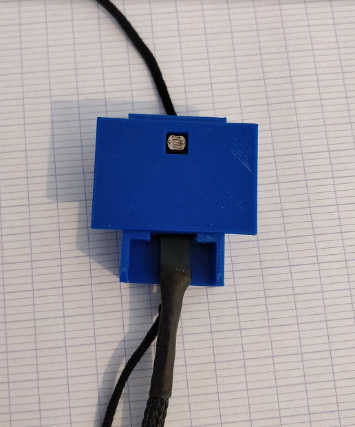

Yeah, I was also curious about your mounting method to minimize any ambient light effects. Clearly, some sort of shroud would help in this regard.
I do have a bit of a shroud, I took insipration from how Nvidia's LDAT is mounted, with an elastidc band. Before that came out, I used to tape it to my monitor :D

which kinda looks like the photoresistors I use, but the quoted response time is 20 to 30 ms, and well, using a LED to test, I get way lower response times than these.
Those are definitely photoresistors. Interesting that you seem to get response times different than spec. Regardless, I strongly recommend photodiodes instead for various reasons including much lower response times, and less sensitivity to incident light. Then again, I've never used either so YMMV. I just have an electrical engineering background.
Piwi wrote:
24 Dec 2020, 07:19
There are also photo transistor light sensor (https://www.adafruit .com/product/2831), I have some of those on order from aliexpress, they have not arrived yet, but I'm curious as to how they behave.
I think they messed up their name because a standard transistor has 3 terminals. It's 99.99% a photodiode (PN junction). Should be an improvement though and although it may not be as sensitive to incident light, a shroud is still recommended unless testing proves otherwise. Hope it goes smoothly!
