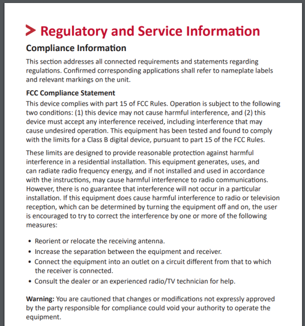

I got a Somfy remote to control my window shades. I think it uses a radio signal... RTS.
Almost every time I use the remote the monitor turns off for a few seconds. It's as if the monitor reads the remote signal.
I'm wondering if there is a setting in the monitor I can use to stop this from happening.
But I guess this question is more suited for Viewsonic support.
Posts: 12306
Post by Chief Blur Buster » 09 Mar 2021, 18:32
Ansive wrote: ↑
09 Mar 2021, 10:08
It's RFI / EMI / interference
Quite common, my ASUS monitor does the same too when I turn on a LED desk lamp next to the monitor (Some cheap LED bulbs emit a brief surge of interference when powering up, when it's too close to the monitor) -- equipment can be literally EMP bombs to other equipment, with the interference surge/pulse being emitted by high-power devices that are too close to each other.
Probably unrelated to the remote control, but a side effect of a sudden electromagnetic pulse coming from a motor. See below:
Fortunately, usually there's simple fixes:
Please:
(1) Locate your monitor & monitor power brick further away from the power cable, power brick or motor connected to your blinds
(2) Operate your remote control at least 1 meter away from your nearest computer equipment (monitor, computer, wires)
(3) Keep blinds power wires at least half a meter away from computer power wires
(4) Keep blinds power brick at least half a meter away from computer/monitor power bricks
(5) Try plugging your blinds into a power filter (i.e. a separate protected power bar), to protect interference from travelling over the power wires back into the computer (through the same power outlet or same shared power bar).
You are simply experiencing interference, a common cause of many computer problems.
All monitors on retail have a FCC statement that indicates your equipment may have interference. Refer to Page 70 of ViewSonic XG270 manual.
Sometimes interference is too sensitive (e.g. LG 5K WiFi interference situation) and requires remediation. But this isn't the case here because some blinds motors emit 100x more interference than a WiFi router. It would cost too much to all vendors to encase the monitor like a thick radiation-proof metal tank to resist stronger interference sources than a WiFi router -- That's why there's a disclaimer that monitors must accept interference too strong to be shielded since it is sometimes impossible when interference is too strong -- see below. All vendors have do this (ASUS, BenQ, ViewSonic, LG, whatever).
All monitors on the market has this interference disclaimer too. The inverse square law is your friend -- pay attention to distance between computer + wiring + power bricks behind your desk! Universal rule for all equipment. This is very old FCC rules written years ago so the "antenna" can be "intefering device" or "power brick". And "television" is "computer accessory or blinds accessory". But the principles of adding distance between equipment (and their power supplies) is the rule of thumb.
