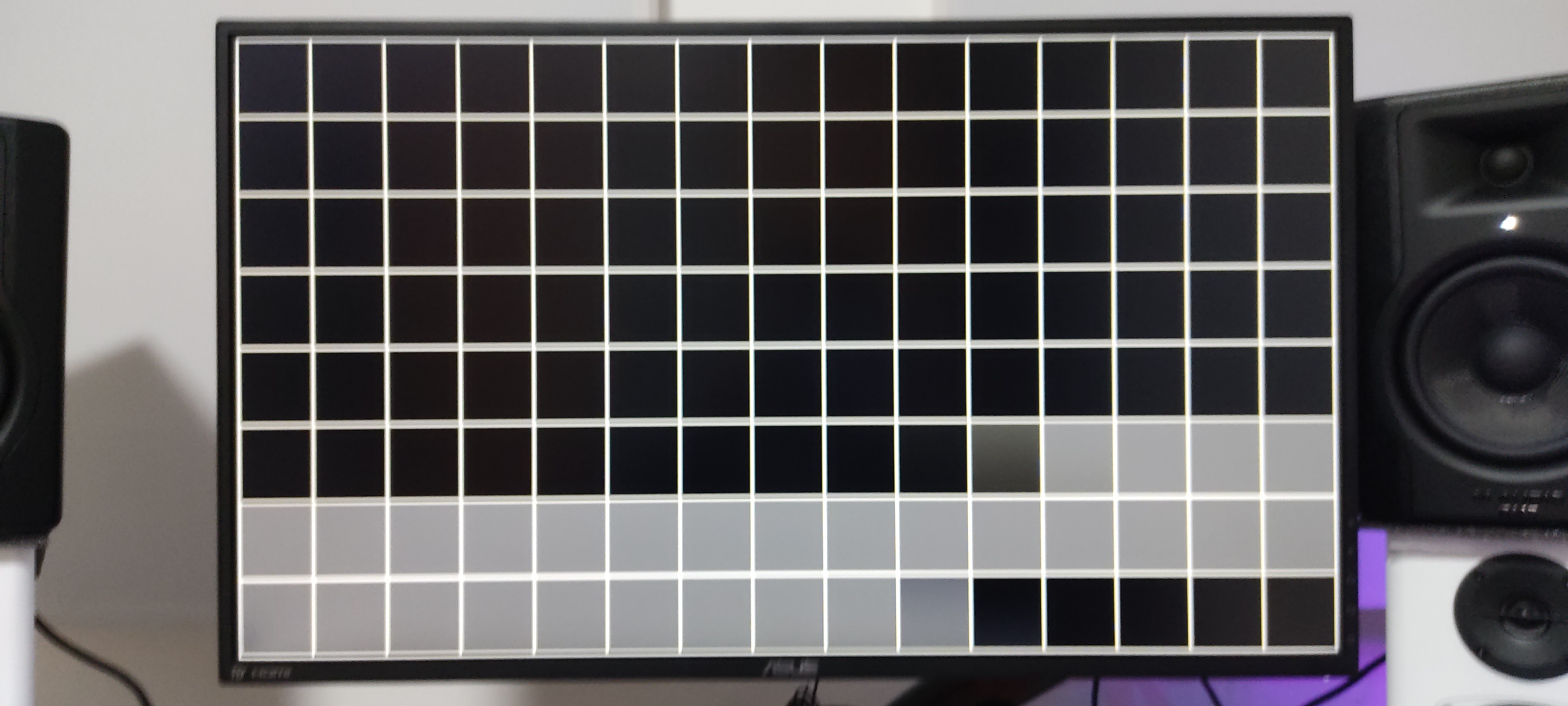

No Frameskipping @280Hz if anyone is into that
VG279QM No Frameskipping jpg.jpg (891.63 KiB) Viewed 65584 times

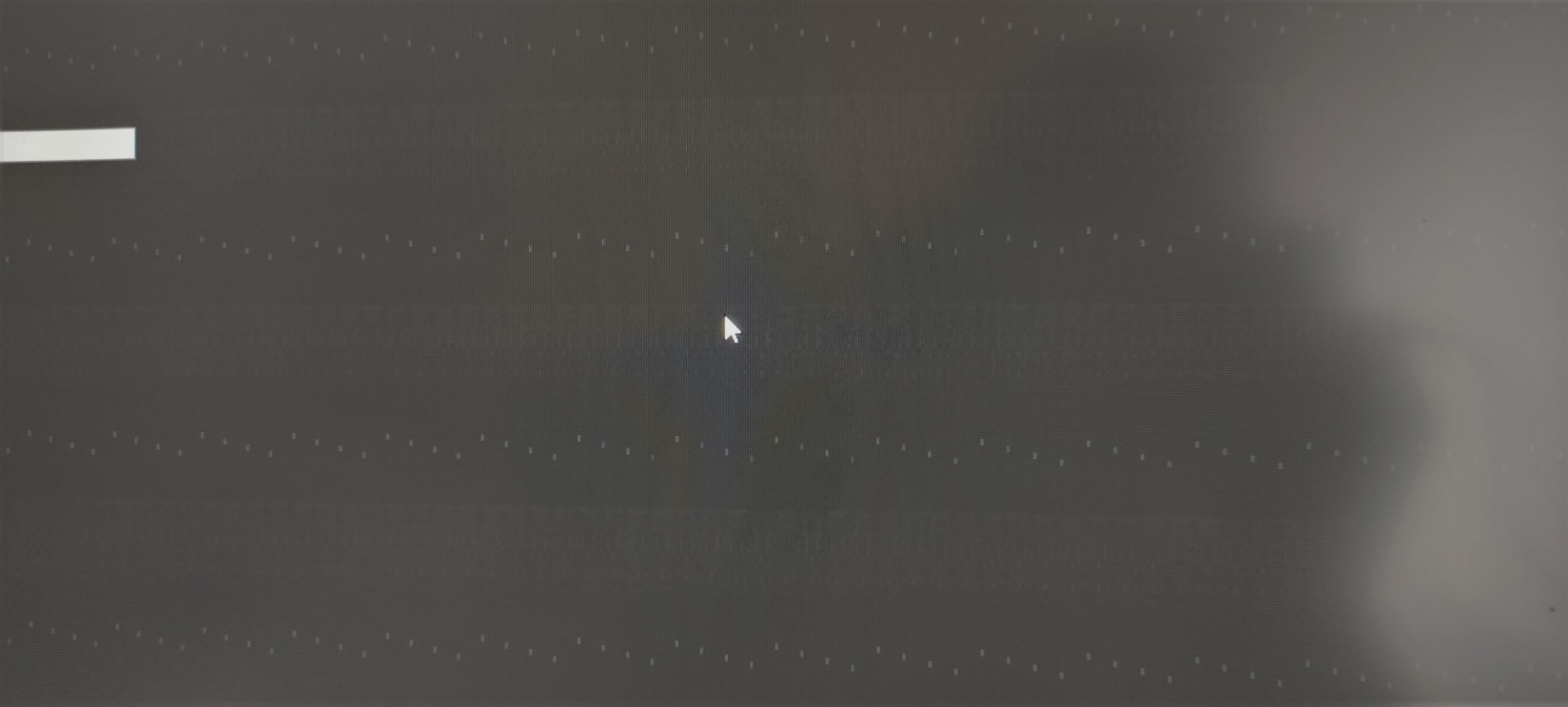

Image retention after ufo ghosting testing, retention always disappeares within 5 minutes
VG279QM Image Retention jpg_2.jpg (261.55 KiB) Viewed 65572 times
- picture shows retention on dark gray background
- do not worry about this, it's only present after ufo motion test
- white vertical wavy lines you see are not monitor artifacts, they are due to picture resolution
