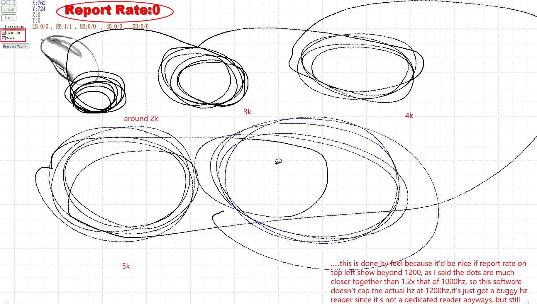

I'm actually amazed how much the jitter issue is largely alleviated by brute 20kdpi coupling with a lower sens. it's not completely gone obviously, but previously it's unthinkable to confidently venture into 8k or even 5k+ dpi realm. Of course all the low latency benefits help with accuracy too.
This is again done on 2/11 os and isn't sensitive enough to pick up smallest movement(even in desktop, so no it's not strictly an Areson bug or whatever) but slower feeling edpi in csgo does pick up all controls. Basically I don't trust this program to tell the whole picture..
There should definitely be an accurate hz read coupled with the plot drawing or Mouse Paint.exe to have context of perf vs hz vs speed.
As you can notice that you can't really discern if at 2k it's simply because the cross stitch marking from "track" is too thick and de-resolutioned the result or that there's actually still dotting. There should definitely be an adjustable thickness of the marking.
