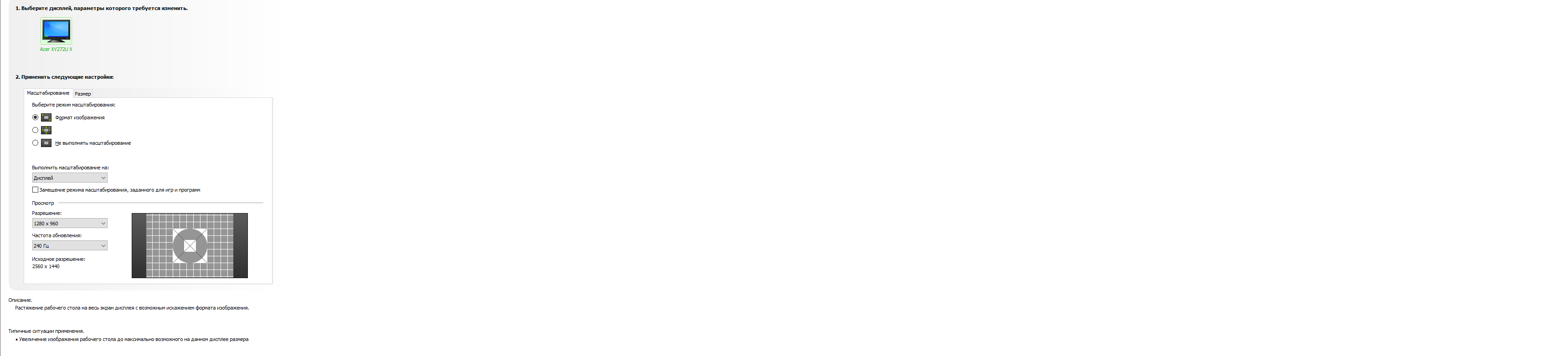

What is the best setting for less input lag on nvidia scaling? (GPU) -aspect ratio -full screen or -no scaling? and i will have chek the box down?
