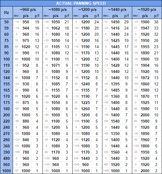

Since the ufo must be panned an integer number of pixels per frame to look smooth, should these be the actual pixel per second speeds?
Why doesn't TestUFO state actual speeds but only pixels per frame?
must be integer.png (68.03 KiB) Viewed 12052 times

For informative purposes, I'll add an interim mouseover tooltip-style box that shows more statistics ("Target Pixels Per Second" vs "Actual Pixels Per Second") everytime someone mouseovers or clicks the PPF/PPS numbers. 960pps at 144Hz actually ends up being 1008 pixels per second (5% deviation) because of TestUFO's PPF priority behavior. This will provide useful information to TestUFO users.
Original Reason:
When TestUFO was first beta tested in year ~2012, the only refresh rates available were divisors of 60 -- and the VG278HE was released after the internal TestUFO beta was started.
(A) Pixels per frame is extremely useful as it often corresponds to the reference number of pixels of motion blur there should be for a ideal theoretical 0ms GtG sample-and-hold display).
(B) Fractional pixels per frame involves either blended motion (blurry pixels of subpixel position object) or jitter (stutter from rounding error), which adds an error margin to pursuit camera photographjy;
This way, it made it easier for MPRT-estimating-by-eye (for motion-testing experienced people) -- see link at bottom on how the UFO graphic was designed as a test pattern (before it became the Blur Busters corporate logo!). Going into a showroom or a convention of hundreds of displays, I can eyeball and visually estimate the MPRT to within one octave (e.g. MPRT 0.5ms, 1ms, 2ms, 4ms, 8ms, 16ms) even just by glancing how the UFO degrades -- without always needing measuring equipment. Completely unmarred by the jitter/blur error margin of non-exact pixels per frame.

You must of already seen Ashun's (Aperutre Grille) last video where he mentioned all this stuff and he is the reason why posted this in first place. He was probably aware of this for a long time. Lack of actual panning speed indication can easily confuse people when comparing ufos at different refresh rates since slower speeds result in sharper motion and vice versa. 360 and 390 at 960pps was a good example. 360 was actually panning at higher 1080 and 390 at lower 780 which is a big 300pps difference. I also used to think 280 was step up over 240Hz because the ufo steering wheel was a bit more pronounced in motion.
Addition of tooltip-style box would be good for now. Other quick solution to this would be to put either approximate (∼) symbol or just state the actual pps speed. Leaving the drop down list presets as it is (or add "∼" too). When speed is exactly matching preset, approx. could be removed.
approximate
exact
Another thing I was wondering; Should TestUFO round to closest higher or lower integer value in cases where both positive and negative have the same deviation? For example in case of 1080pps preset and 240Hz: at 5ppf actual speed deviates for +11,1% (1200pps) and at 4ppf deviates for -11,1% (960pps). I checked this and it rounds to higher integer.
I like the idea of custom settings for advanced users alot and hope some of it is implemented in future versions. VRR support would also be great. That might take a lot of work.
