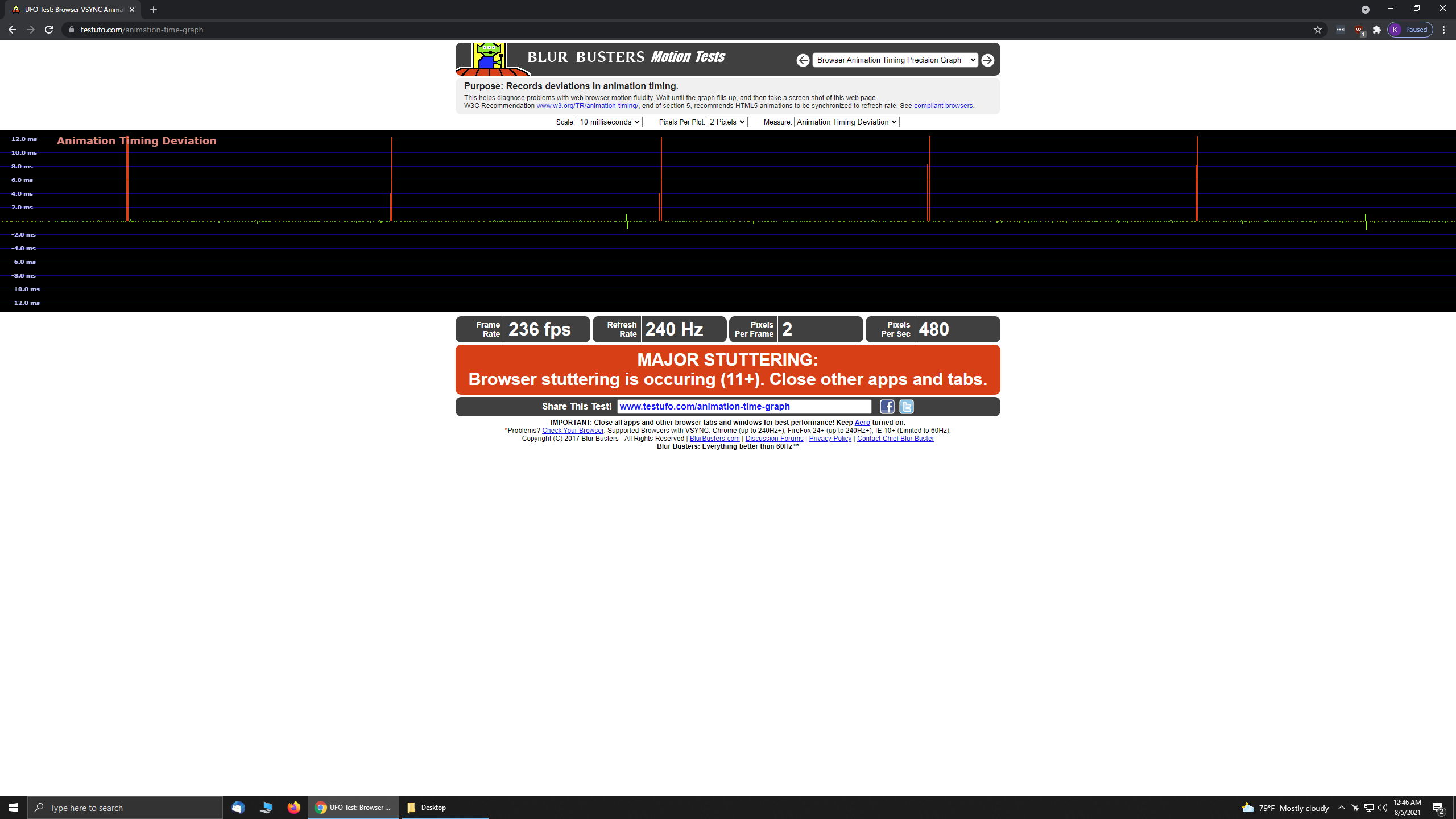

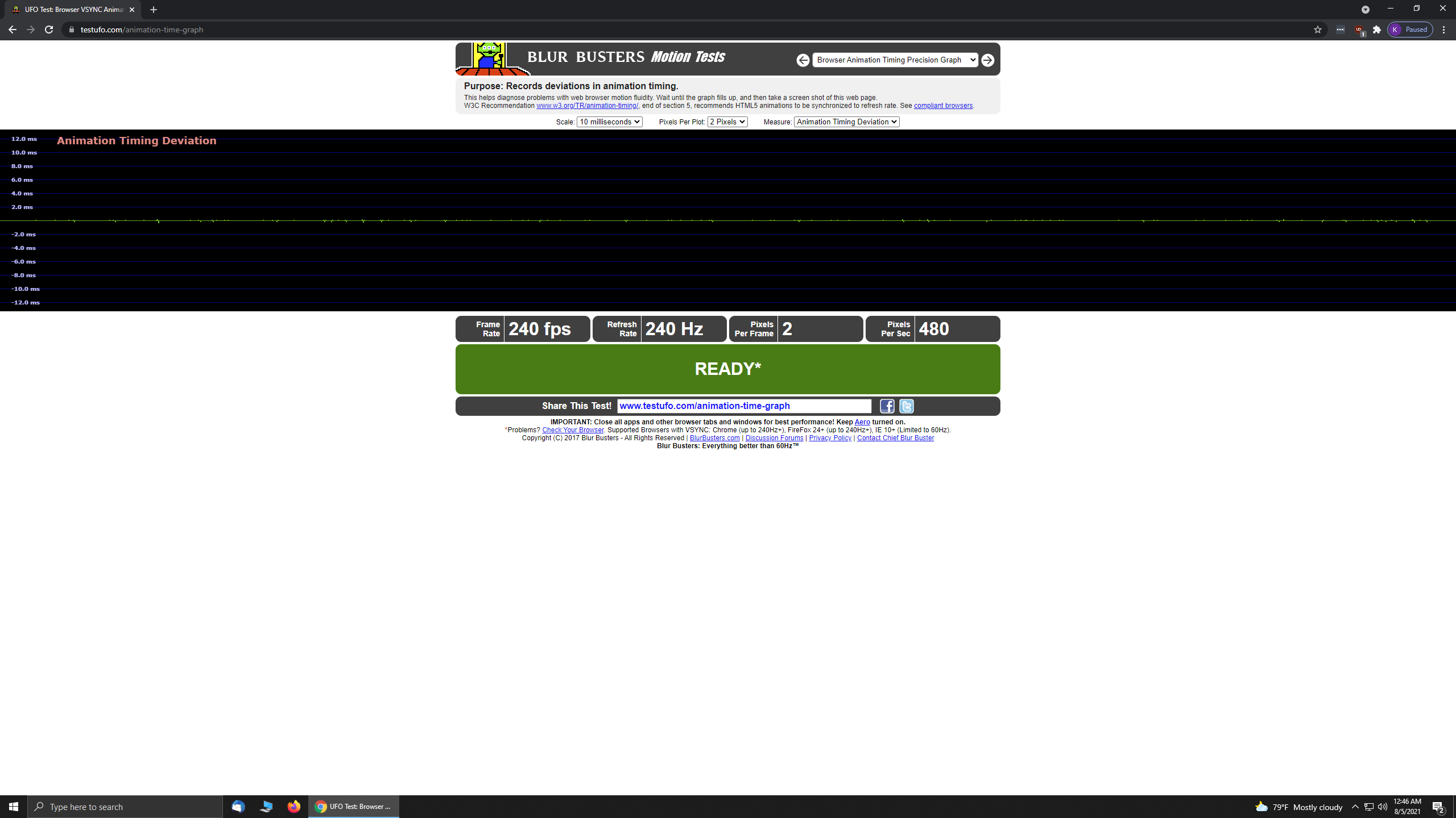

I originally went to the refresh rate test on testufo.
It kept failing the test. It took a while, but I found out msi afterburner was the culprit. When I close it from memory, the test works just fine. Here are two screenshots, both taken in Microsoft Edge. The passing test is before MSI afterburner is open, the failed test is after I open MSI afterburner (you can see it in bottom right corner.)
Desktop Screenshot 2021.08.05 - 00.46.50.54.png (135.48 KiB) Viewed 16301 times
Desktop Screenshot 2021.08.05 - 00.46.01.64.png (120.84 KiB) Viewed 16301 times

Stuttering in TestUFO is definitely a different cause of stutters -- web browsers are super sensitive to stutters. You have to close ALL browser tabs except only for TestUFO, it should be the only window running.
The TestUFO animation time graph is an excellent diagnosis of periodic background processing surges that interferes with graphics rendering, which is what the red peaks show. But the background processing from other browser tabs is also a cause. Which is why I recommend animation time graph be run as the only tab, only app running, so it isolate to your computer's background software (system tray etc). Disable all web browser extensions too.
Then thereafter, cyclic patterns of red peaks means some background processing is probably affecting consistent frame delivery of your foreground software (Inefficiently-written keyboard RGB software and malware scanners, as well as HUD graphics overlay software, etc)
