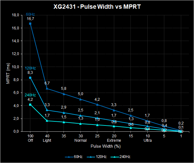

Since XV252QF won latest RTINGS review, may I ask all true voters to go vote for new era Zowie monitor - Blur Busters Approved XG2431 with premium, flexible blur reduction on IPS. We finally got great performance at affordable price.
Vote for XG2431 at RTINGS
Here is a quick sneak peak. It's clearer than Zowie in this case scenario.
