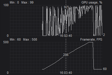

https://youtu.be/7CKnJ5ujL_Q?t=333, row 3 and 4.
Its just important to cap the frame rate bellow 90-99% gpu usage. That's pretty much it.
frame rate and gpu usage.png (8.79 KiB) Viewed 10106 times
For additional, small latency reduction: the Lower the gpu usage, the lower latency.
thank you
