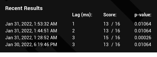

Post by MatrixQW » 30 Jan 2022, 20:18
I always felt I am very sensitive to latency and I was right.
I notice my state of mind determines how much I can feel.
With a first attempt I still managed to make it in the 1 and 2ms. It's harder but I still notice it and that's what matters.
To be able to see/feel it, the movement must be constant and medium/high speed but can't be too fast because if the line shows tear or blurs too much it gets disguised.
So to me, it matters the processing input lag and also the response time of a monitor.
That's why I'm not so keen yet in IPS monitors because the response time is outside the refresh cycle.
I admit I never tried one but that's what I can tell by reviews.
If there is a 240Hz IPS with a response time of 4,16ms I would like to try it.

Post by kyube » 31 Jan 2022, 08:56
MatrixQW wrote: ↑
30 Jan 2022, 20:18
So, when are you dropping the best peripherals, hardware and software setup guide, latency guru? :D
I'm astonished there are people that perceive under 5ms of input lag!
