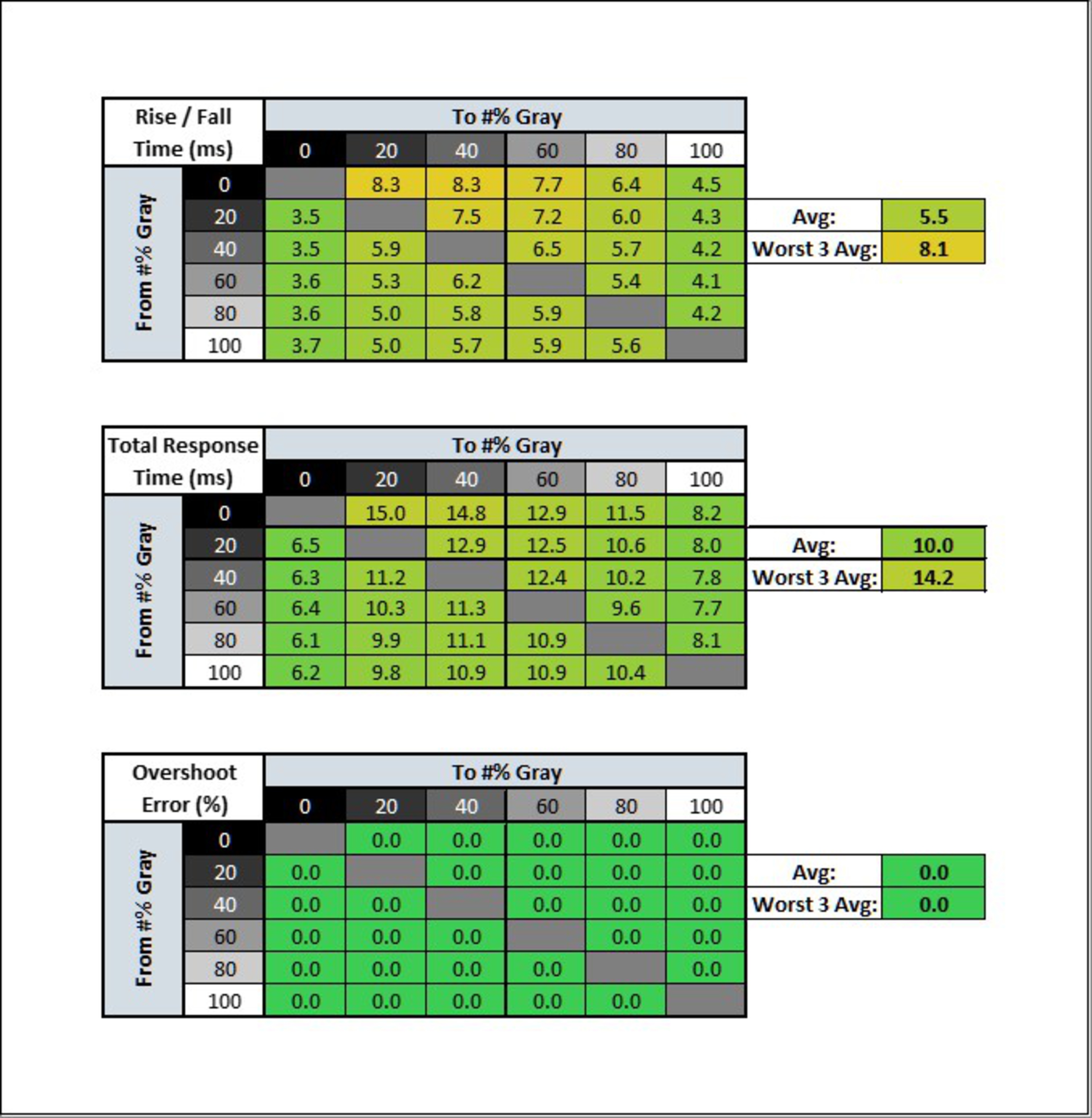

Why would anyone use a gaming monitor without any overdrive setting though?
Benq is true, somewhat quicker without any overdrive. Yet at the same time, nothing to write home about. But even the first stage of overdrive (AMA) introduces a lot of overshoot error.
Benq AMA high https://i.rtings.com/assets/pages/odyv0 ... -large.jpg
Where with Acer any sensible person would activate at least the normal overdrive mode on, because it has zero negatives. And even in that state, all the numbers are clearly more positive with Acer.
Acer OD Normal: https://www.rtings.com/assets/pages/aQV ... -large.jpg

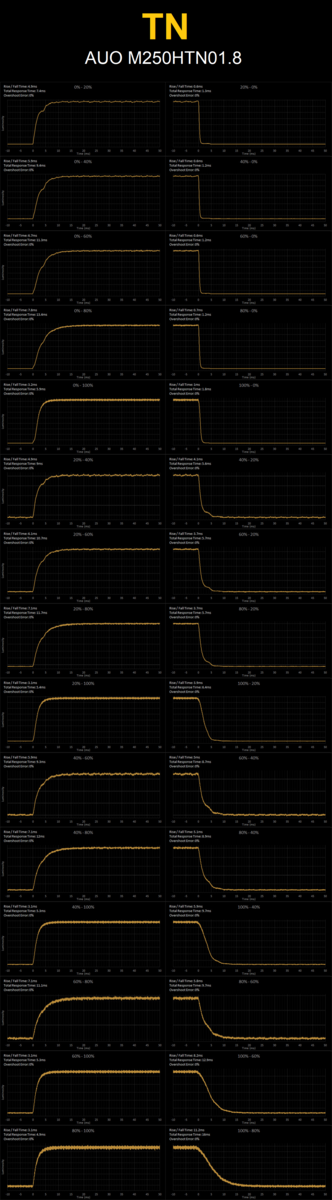

Good old TN vs IPS debate.
Here's a random response vs response direct comparison (from Rtings). These are without overdrive because its more apples to apples way of comparing raw panel responses. On top of these overdrive is added and tuned. We can see at some transitions TN is faster and at some IPS and some are the same. On average it ends up very similar. Good overdrive tuning in the other hand can make one faster than the other.
TN vs IPS, No Overdrive, Linear Response.png (350.23 KiB) Viewed 10287 times
Here are originals if someone wants to zoom in: TN, IPS and OLED
We also have these in heatmap form: TN, IPS
These are TN AUO M250HTN01.8 (XL2546K), IPS AUO M250HAN01.7 (VG259QM)
