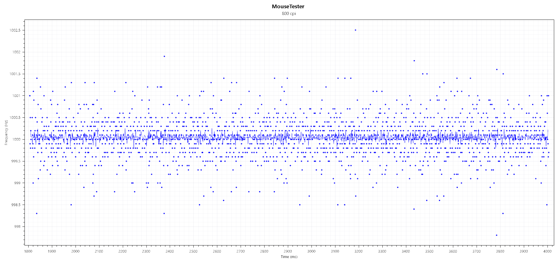

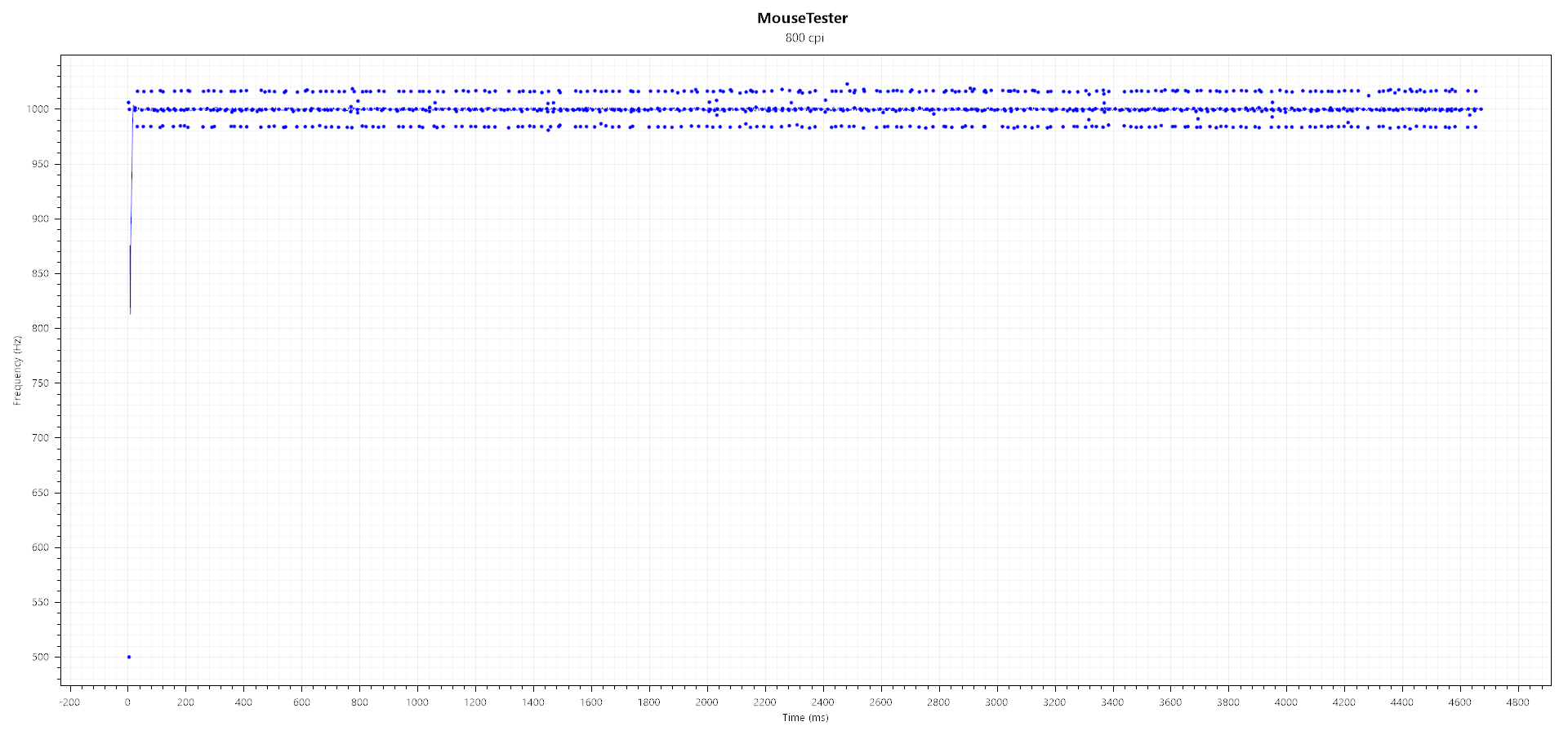

After I installed i7-12700kf, this radically changed the situation, I also had to enable Legacy IO Low Latency for the same mouse behavior as on the previous system. I still don't know what to do with the rest of the bios settings such as LegacyRTC and FIVR Spread Spectrum.
Legacy IO Low Latency(enabled).png (175.23 KiB) Viewed 9888 times
Legacy IO Low Latency(disabled).png (107.51 KiB) Viewed 9888 times

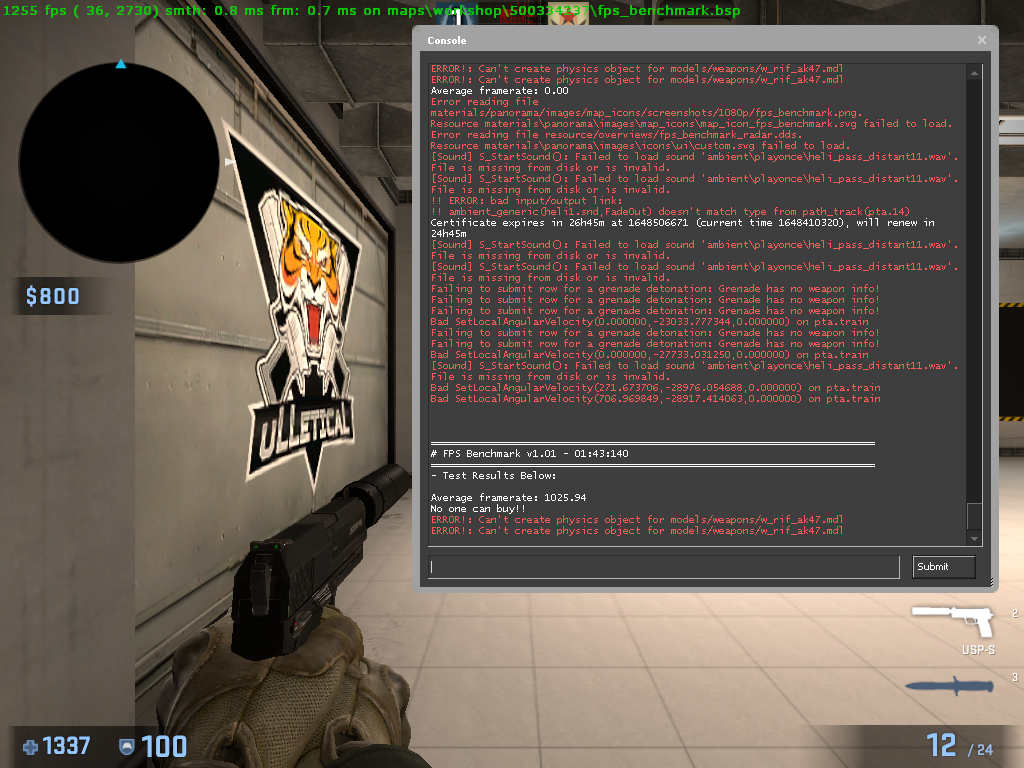

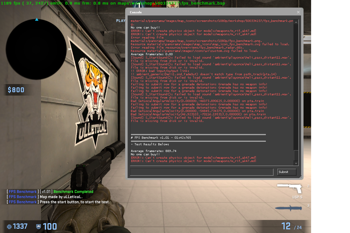

Can someone tell me why this is happening?
No settings change, it's just that sometimes everything is fine, but it's very rare, 1 out of 10 reboots, it immediately feels like the gameplay is smooth, according to tests it really is. This happens not only in cs go. This happened on 3 of my different systems with completely different components.
