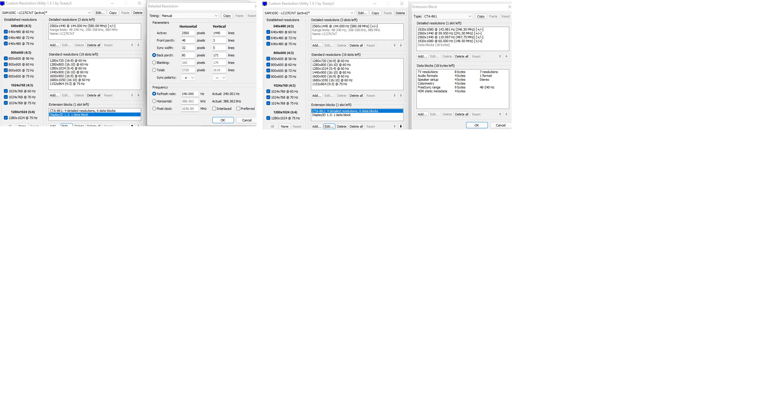

gogeta01
- Posts: 3
- Joined: 07 May 2022, 06:47
Re: Peculiar Gsync behaviour in specific scenarios.
Whatever change I make has no effect on the range. Haven't had any issues when there's normal fps fluctuations.
