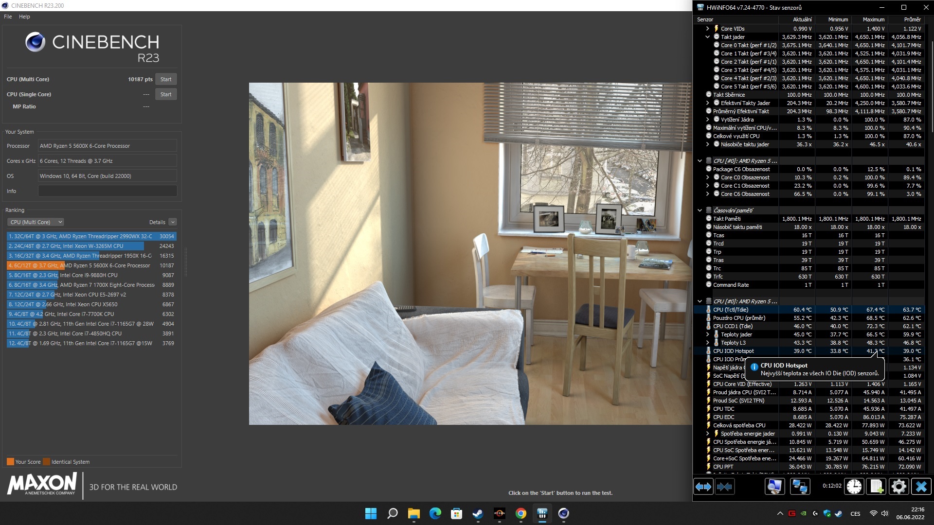

Post by MegaMelmek » 06 Jun 2022, 15:21
So max temp 67 avg 64C in cinebenchR23 multicore, avg clock 4050MHz
Chipset was 65C and avg also 65C

MegaMelmek wrote:
06 Jun 2022, 15:21
So for starters, even though your temps seem fine, you're still getting throttled. The screenshot you sent doesn't show me all of the TDP power settings/results but I'm guessing the power limits on your board haven't been configured. Your cpu is likely requiring more power to maintain your frequency but likely do to a bios setting restriction it's probably capped too low to maintain your preferred clocks, hence the throttling. HWINFO64 will show this. Run cinebench again and look for a section called 'Thermal Throttling' while cinebecnh is running. It will tell you if you're being throttled. Now also while it's running, look at your power settings and see what your TDP caps/limits are. I'm more familiar w/ Intel than I am AMD. For Intel it's called PL1 and PL2. PL1 is long term power limit, and PL2 is short term power limit. For my 12700k, I believe mine is set to PL1=250, PL2=250 at a fixed clock of 4.9GHZ across all cores. I run a 12700k on a Z690 mobo. A lot of people will just remove all power limits so the cpu doesn't get choked for power when it requests it but this can also cause your temps to skyrocket which can also cause throttling. You need to find a happy medium.
A good start may be to remove all power limits on your motherboard for your cpu/mobo, run the test again and it will tell you how much power/watts your cpu is pulling. If temps are okay, set the power limit just above what HWINFO64 is telling you your CPU pulls. You may need to do some research on this first if you're unfamiliar.
What CPU + Motherboard do you have? I can try to give you some suggestions to get you going.
Also, as a side note... This is very a common occurrence among newer generations of CPU(s). You really need to know how to configure your cpu/motherboard's power limits and clocks so your CPU isn't getting choked for power when it needs it or getting too hot where throttling will occur.
