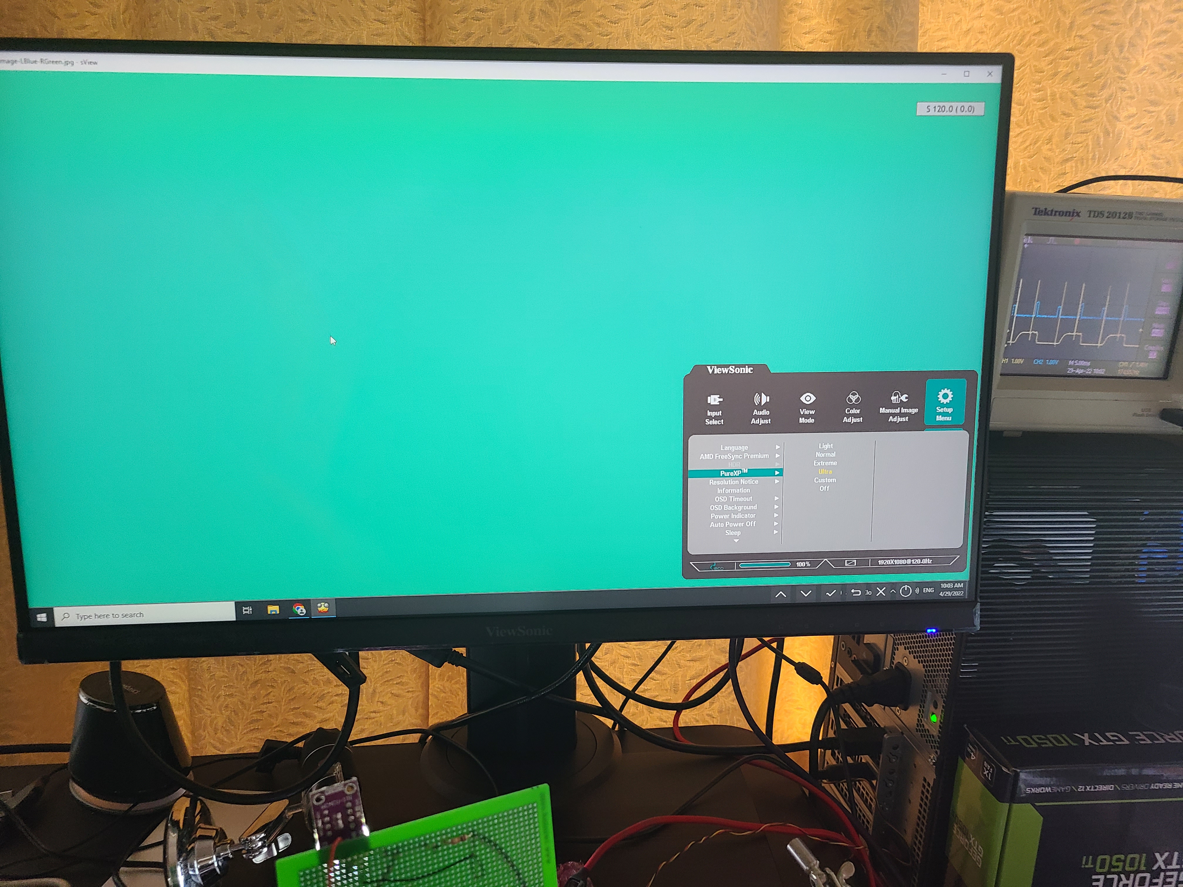

Hello,
I had chance to test ViewSonic XG2431 with active IR shutter glasses(XPAN 105-IR-X1 / for general 3D TV).
The test environment are like followings:

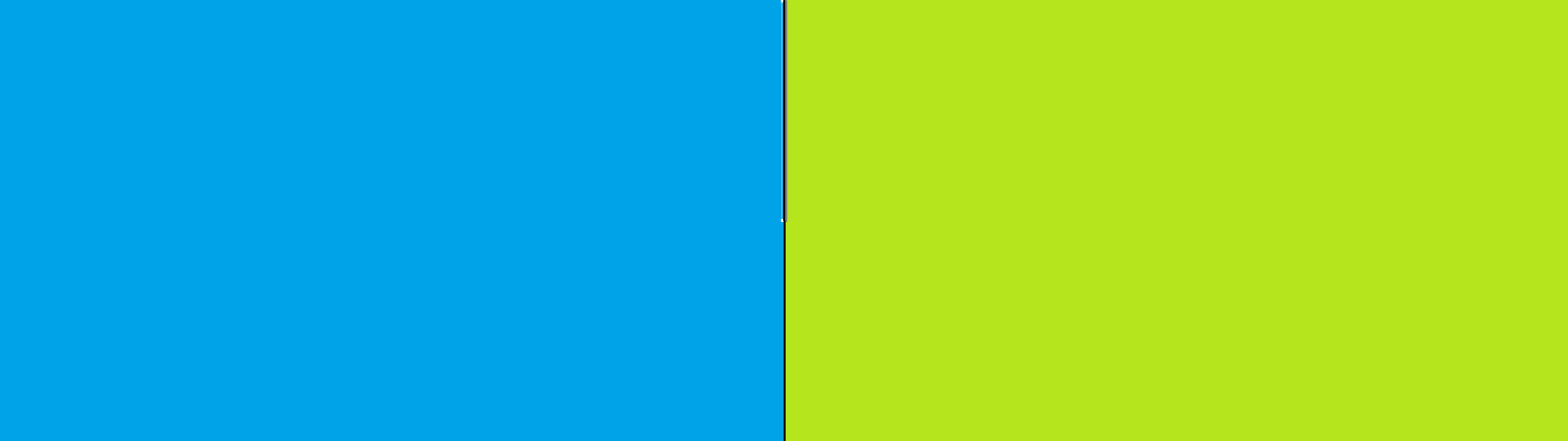

- Prepared side by side green/blue image @120Hz(sView)
- Quadro RTX 5000 with VESA stereo 3 pin extension connector
- Set PureXP as "Ultra" in ViewSonic XG2431

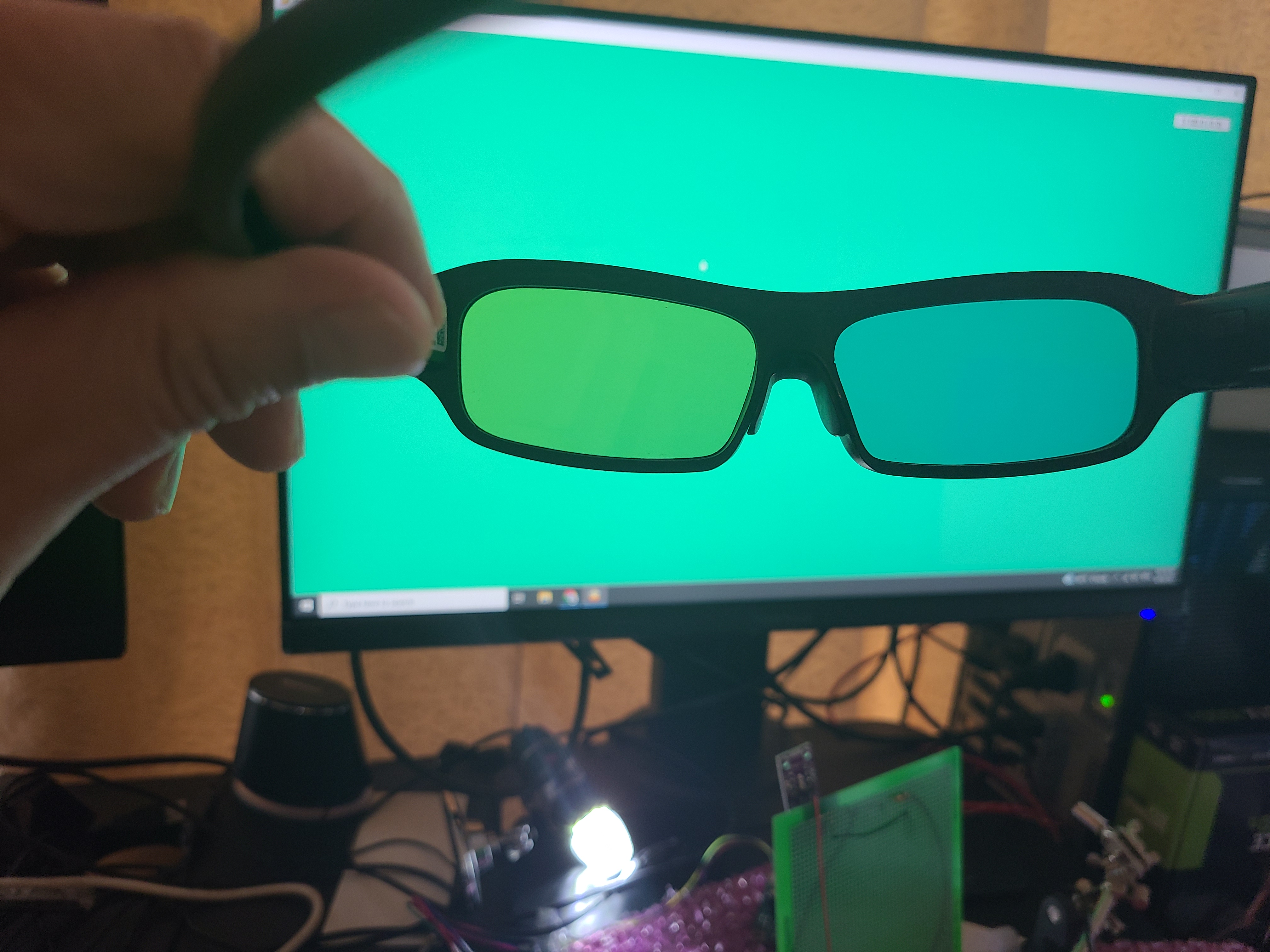

Observation
- No blur image on each left/right lens of IR shutter glass
- No polarized issue, it was same as TN screens
Question
Do you know why no polarized issue on ViewSonic XG2431?
Thanks,
PureXP set up
PureXP set up
No polarized issue
No polarized issue
Side by side (Blue/Green)
Posts: 12306
Post by Chief Blur Buster » 05 May 2022, 15:02
SEA_mukilteo wrote: ↑
05 May 2022, 12:32
19 Apr 2022, 23:24
18 Apr 2022, 16:23
Can I expect no ghosting 3D stereo image with quadro graphic card / stereo 3 pin extension connector/active IR shutter glass and this viewsonic XG270?
Personally I'd consider the ViewSonic XG2431 for even better zero-crosstalk results (using 120Hz with the VT2250 trick).
Make sure the 3D glasses are correct polarization (vertical polarization versus horizontal polarization). IPS is polarized 90 degrees differently from TN screens, so shutter glasses for TN screens won't necessarily work unless you rotate your monitor by 90 degrees to portrait.
Hello,
Observation
Question
This is because XG2431 polarization direction is 90-degrees different from most TN screens. That makes it compatible with different shutter glasses, like repurposed DLP shutter glasses.
- Shutter glasses uses LCD shutters which don't work well with wrong-polarized light.
- DLP emits unpolarized light (compatible with all shutter glasses)
- TN emits polarized light (compatible only with certain shutter glasses)
- IPS emits polarized light 90 degrees different from TN (compatible with DIFFERENT shutter glasses)
So shutter glasses must be compatible with the LCD's polarization.
You can also rotate a screen between portrait/landscape to fix polarization compatibility issues, since TN and IPS are polarized differently. IPS polarization is apparently more compatible with DLP-glasses polarization, because LCD inside shutter glasses don't work well with wrong-polarized light.
You found one of the best kept secrets: Today XG2431 is one of the best tiny 24" 3DTV-compatibles ever released -- near perfect zero crosstalk with the 120Hz VT2250 trick in ToastyX -- then re-calibrated with ViewSonic Strobe Utility to hide the room-temperature-sensitive part of crosstalk (temperature of summer/winter can worsen 3D glasses crosstalk).
I found that XG2431 PureXP is compatible with most DLP-Link glasses, with a "DLP-Link emulator" that has a shutter phase adjustment. And then using 3rd party 3D players that uses sequential-frame.
Voila. Perfect 3D from XG2431 that is superior to most 3DTVs and even better than NVIDIA 3D Vision!
